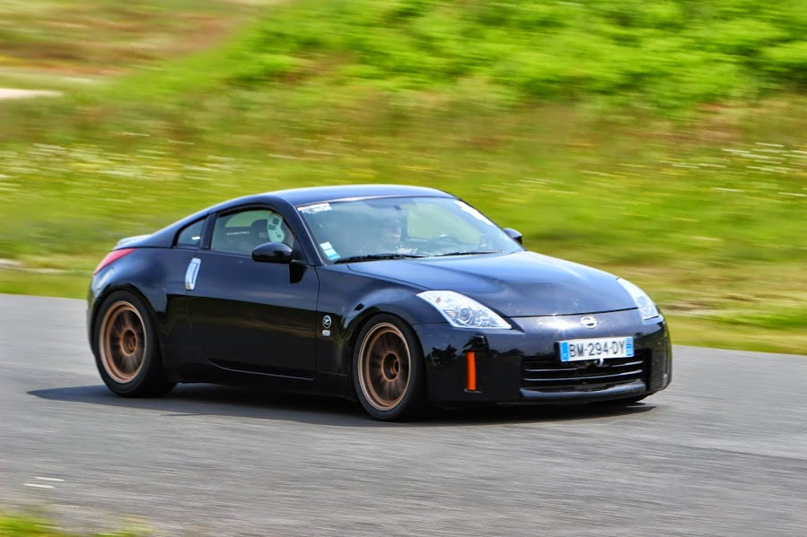

Looked at your vids briefly, and your Z really suffers from a lack of roll stiffness. Swaybars will help that, but you really need to get a tire pyrometer on all four tires to determine what your tire temps are after a track session. Then you can adjust camber to fit. As you say, I suspect your excessive camber is rolling the contact patch quickly at turn-in and the lack of roll stiffness has the Z seeking to swap ends.
If nothing else, this shows what happens when a lot of money is spent without first considering the basics. Swaybars should be one of the FIRST upgrades to be considered for a car going to the track...

First problem: Tires are imbalanced. I don't mean wheel balance, I mean size. Your fronts being as large as they are and rears only a fraction (10mm more) PLUS aspect ratio differences is already a recipe for snap oversteer as the fronts are gripping harder and the rears softer (relatively speaking).
HOWEVER, that's not too bad of a problem that adjustable sway bars can't mitigate. (Which, as David said, should ALWAYS be the first modification to suspension AFTER proper alignment - more on this in a sec) In this situation, I'd tend to think that running a hole 2 front/hole 1 (softer) bias should fix this by slowing the rate at which the rears reach max slip angle.
Speaking of alignment, I see where you have adjustable UCAs up front but no camber adjusters in the rear? How'd you get -2.5deg back there?
And yes, that's FAR too much camber angle all the way around, particularly for the street. (Dedicated track cars might be able to run this on a long track but for dual purpose, ehhhh.... not so much.) Combine that with the toe you're running and you run into "decent turn in but darty, skittish behavior at the apex".
For a car set up dual purpose, I'd keep camber no more than -2.5 in front and closer to -2.0-2.5 MAX in the rear. On toe, I'd bring it back to 0 or even a slight toe in, maybe a 32nd Front and a little more, maybe a 16th in on the rear.
The car will still rotate properly but you stand less chance of overcooking the rears before the front.
Get your bars in, toe adjustment out back THEN bring it to a race shop (or a really competent alignment shop that understands the alignment settings that are "off the books".
In the end, it's all about experimentation. The settings I quoted might not work for the types of courses you run but it's a start and I can almost guarantee that some of the skittishness you're feeling will be reduced or go away altogether. It's basic alignment theory.
Good luck!

Those photos don't do much except show you have too much camber dialed in. As for swaybars, your understanding of them is flawed. As the car rolls into a turn, swaybars progressively begin to work. Unless you stiffen them too much, there is no loss of grip or traction. Mic's recommendation for initial swaybar settings is a good starting place. Simply putting harder springs in your Z has made the handling nervous and the car unstable with the tires and suspension settings you've chosen.
