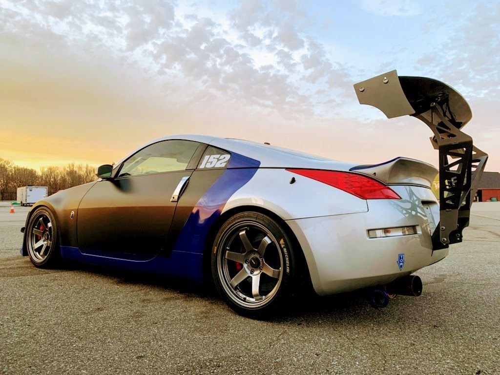

Just got back from VIR, it was a good two days of testing. I'll save my comments on the wing setup until I have some videos processed, but for now here's a couple beauty shots from the paddock

nice! that wing is massive. what times did you run?

Ok, so let's get into this. Bottom line is I only managed to improve my best lap by less than a second, I got a 2:11.7 best. While the wing did improve my cornering speeds and I was able to go up to esses flat out at 120mph instead of the previous 115mph, on the straights I lost about 5mph to drag, topping out at 130 mph. And that's with the wing in the most horizontal position. Also the leading edge of the wing cf split after the first session. It held together but it's basically junk. I kinda expect it to be crap but this is still very disappointing.
Also, I notice drips of fluid coming from the left side of the diff, I didn't get a good look yet, but my guess is that even with the Z1 finned extra capacity cover the diff is still overheating and spraying fluid out of the breather on top. So do I need to get a diff cooler now? Sigh...

nice laps. sucks that wing is falling apart already. I was wondering how you would know if the diff was overheating. Thats the only thing I dont have a aftermarket cooler for, so far i havent had any issues. Let me know what you go with if you decide to upgrade..

A few comments on that wing. It looks like a junk profile . The AoA also still looks pretty steep for a high speed track. I also think you will need to remove the ducktail on the trunk. I expect that it is messing up the flow on the underside of the large wing. Sasha did a very interesting video on aero testing the 350z.
I would also be a bit cautions adding a bunch of rear aero grip and no front aero grip. Having your grip shift rearwards with speed can make for some weird handling behaviors.

Agreed, this wing is junk, the leading edge is almost flat, the profile is a joke. The duck tail might go at some point, especially if I decide to do a CF rear hatch with smaller glass for weight reduction. I think there's a lot to be gained there.
I was a bit concerned without large front splitter if the front grip would be reduced but I didn't find it to be. I do need to stiffen up the rear struts a few turns for better initial grip going into turns, I was experiencing some scrubbing on initial turn in before the car would settle down and grip.
