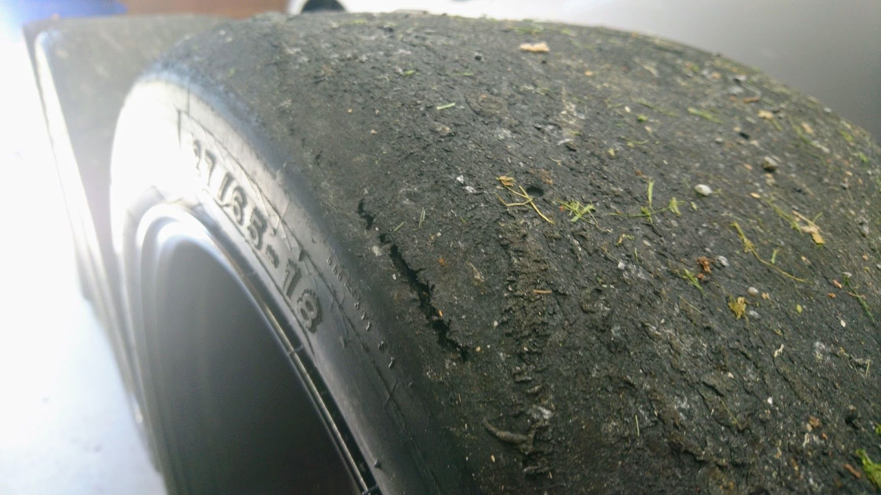

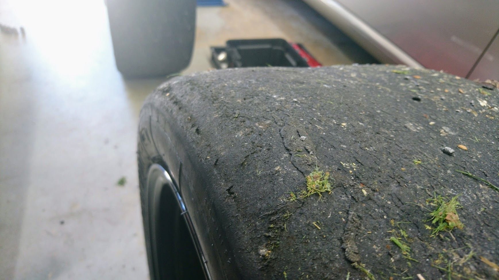

Figured out what happened, the front left tire has failed, the belt has separated and the tire bulged out on one side. Might be hard to see in the pics, but the inside half of the tire is taller than the outside half. Fortunately I have 6 of these tires so I was able to mount a spare for upcoming VIR event.

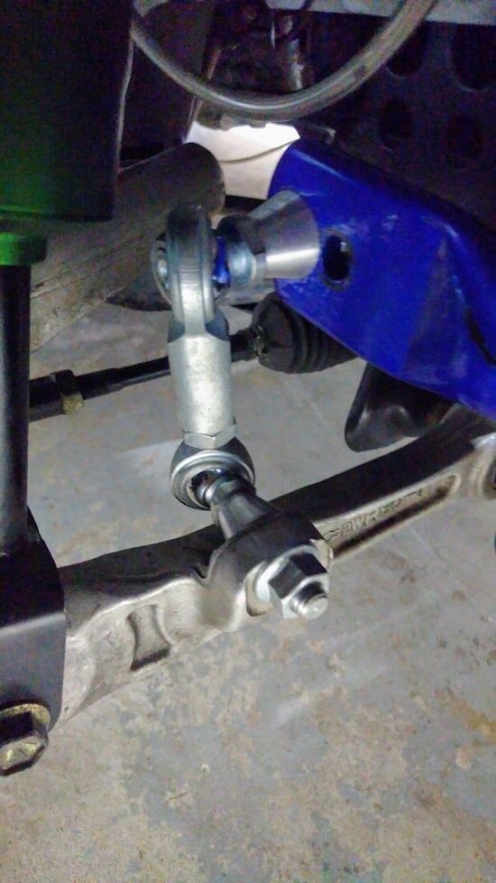

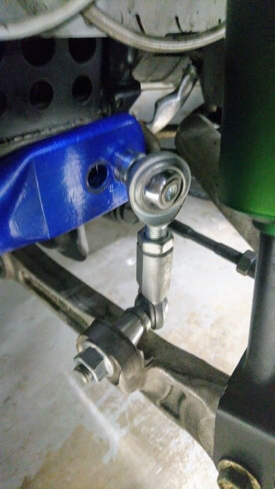

I also noticed that the SPL front sway bar links I installed have shifted themselves. I guess having two spherical joins will do that, not sure if there's anything I can do to prevent this from happening.

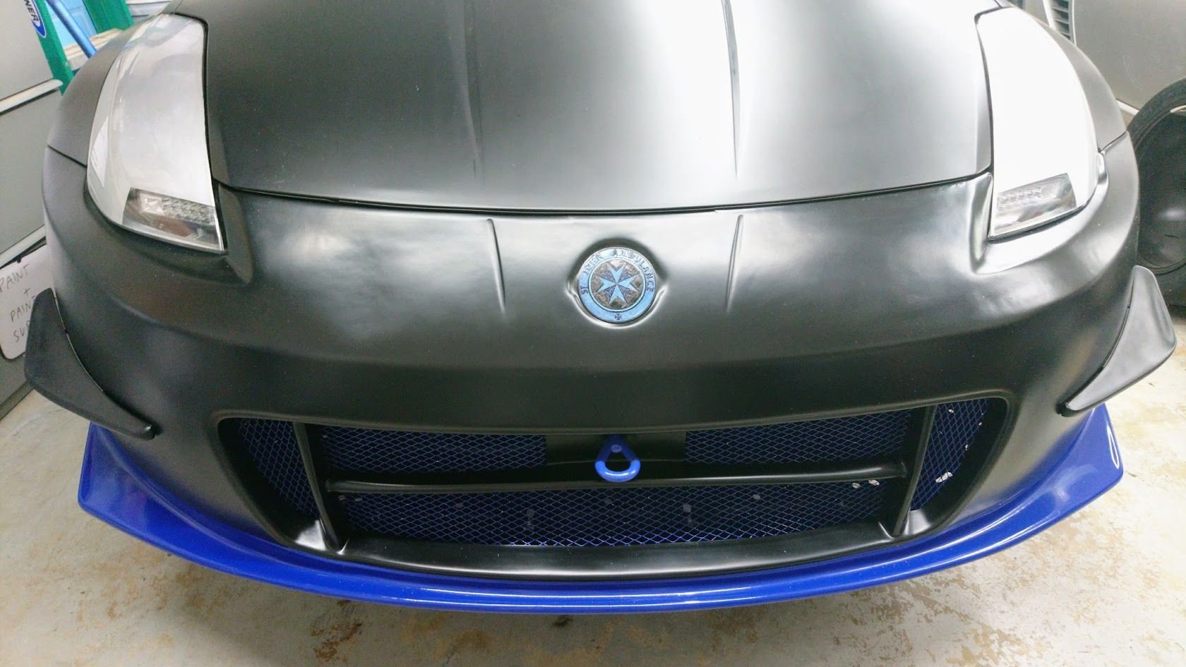

While I was at it I went ahead and installed canards that came with my front bumper. They've been sitting on the shelf for a while and while I doubt there is much benefit to running them I figured might as well...

I have the same 'issue' with the SPL end links too.
I've tried adjusting them a few times but not quite sure how to get them so it's all lined up nicely like the instructions.

Yeah, I realigned them but they are not gonna stay aligned very long. I guess it's fine as long as the movement is uninhibited, just kinda annoying if you have OCD :P

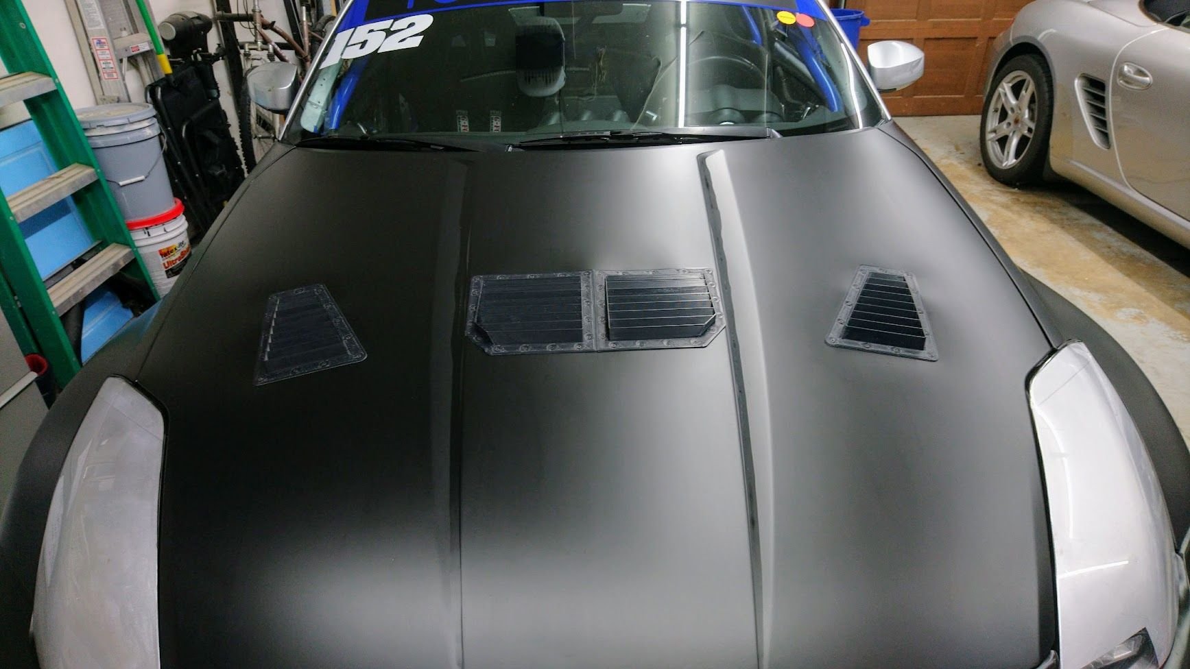

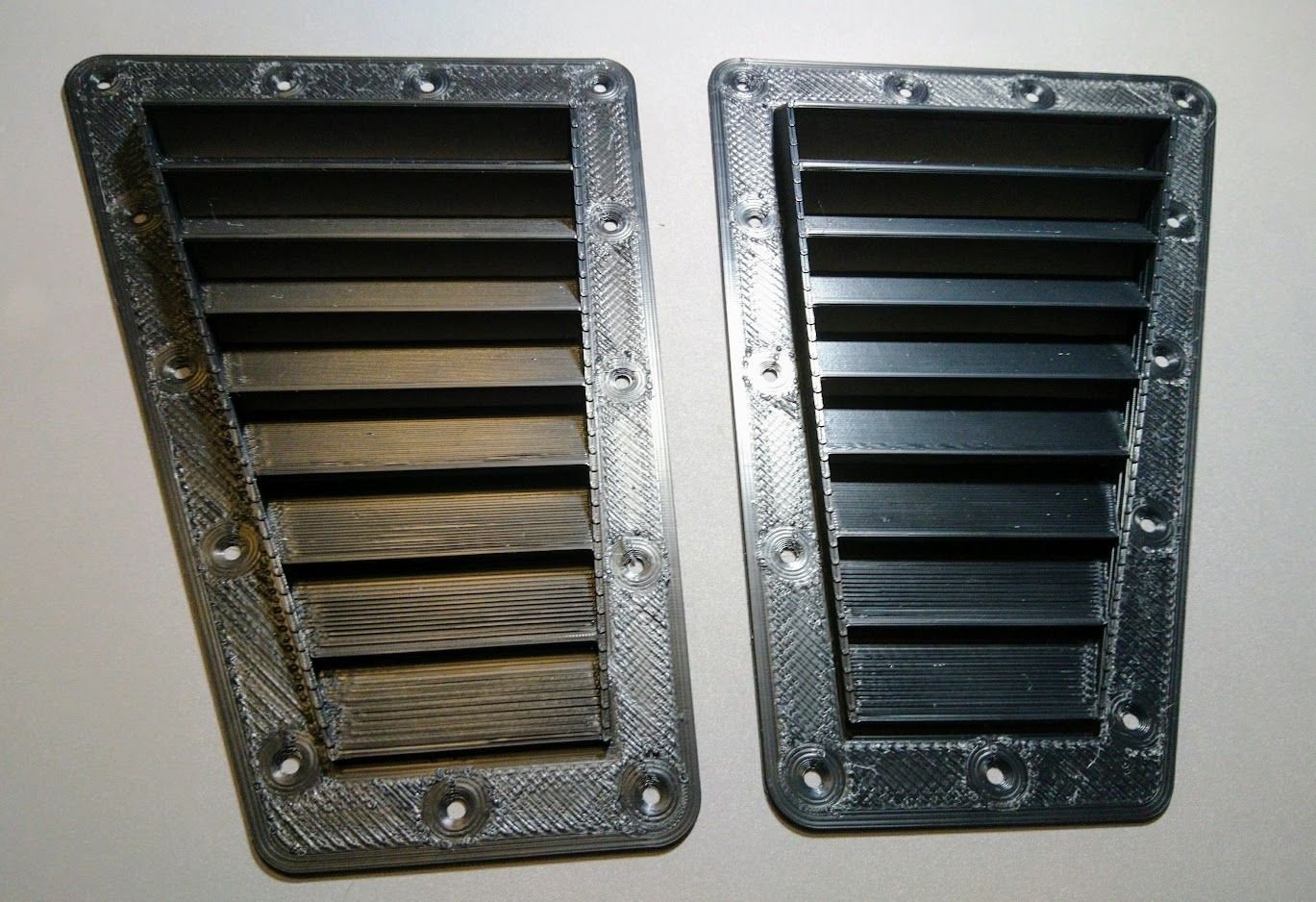

I'm designing hood vents that'll fit in the middle of the stock hood right above and in front of the strut tower brace. Because of limited size of the 3D printer platter I'm making two mirror vents that'll sit next to each so they miss all the stock hood supports underneath and go right up to the hood crease on each side. More to come after I cut up my hood...

Since my hood has already been scratched up in the tire wall incident, sanded in places and vinyl wrapped I figured there's no harm in cutting it up some more. Also, there is no weight advantage going with aftermarket hoods, and I'd have to install pins to hold it down. The only difficulty right now is printing ABS plastic that can withstand the temps on top of the engine. I've had to enclose the printer to build up enough heat so that the print doesn't warp off the plate, but even so it's still a bit touch-and-go.

Printed from ABS using 1mm nozzle for max strength
Mock up location

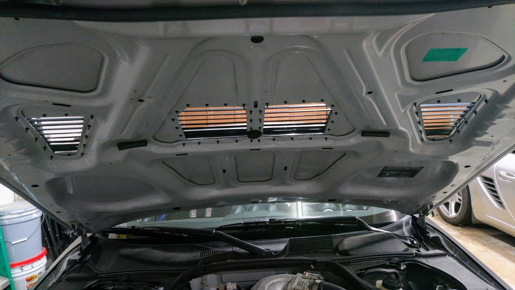

A couple more designs. The first one will sit on each side of the hood near the fender, the second will be right down the middle by the windshield. Since that's a low pressure spot I flipped it to be internal.

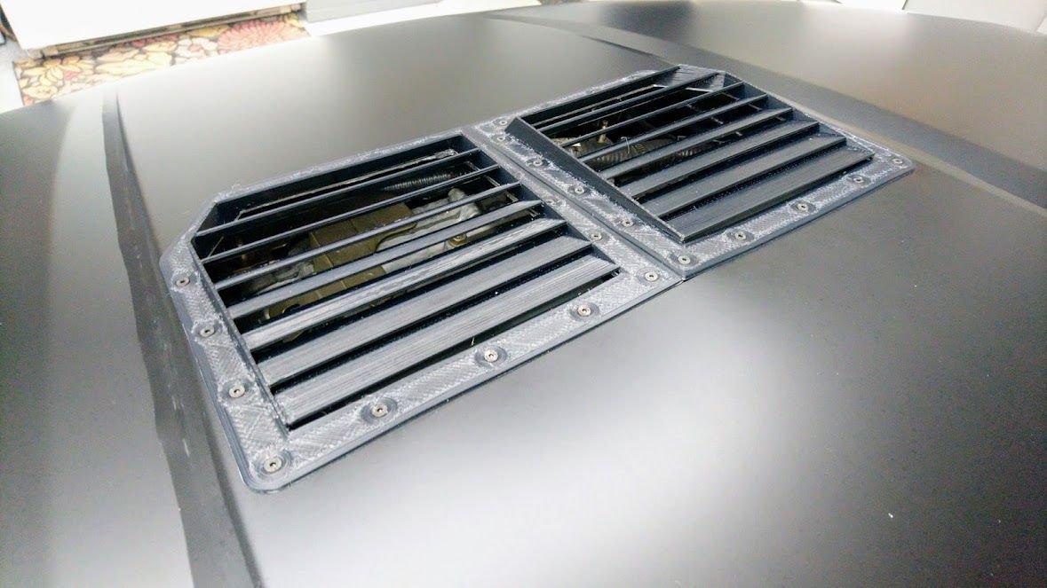

Center hood vents installed

If anyone would like to print their own, the design is now on Thingiverse. I'll add the side vents once I make sure they fit ok.

Side hood vents printed

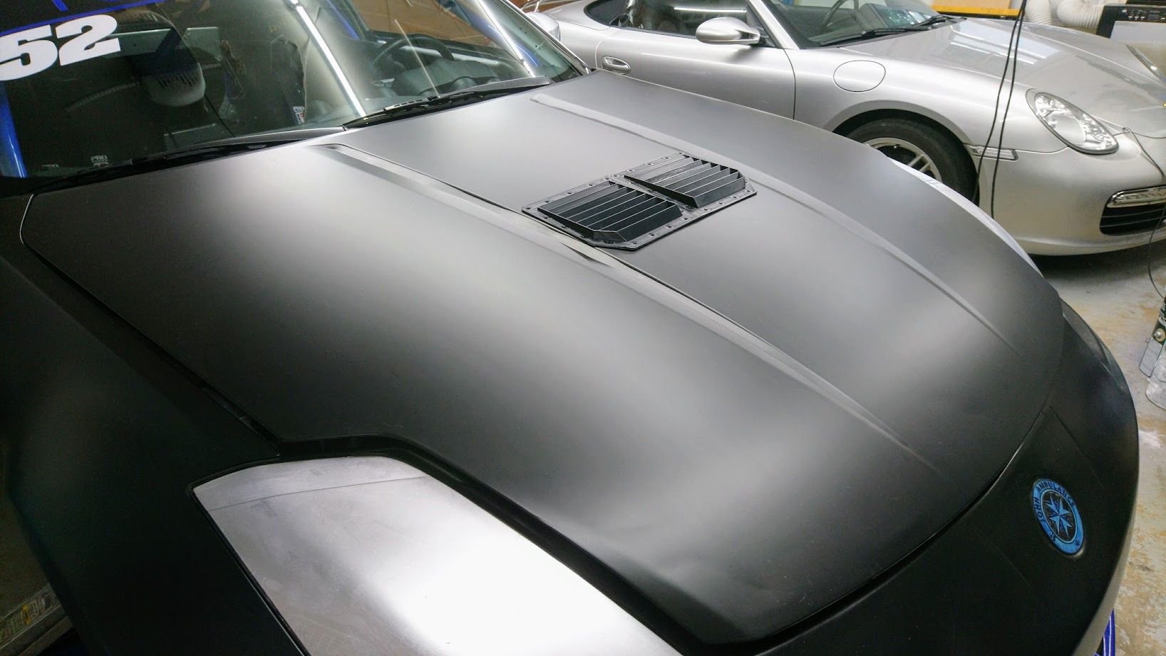

I got the side vents installed. Like before they follow the openings in the hood structure. I also added these to the Thingiverse download.

Those vents seem a bit farther back that I would have expected. Any reason on why you chose so far rearwards? or was it based on hood structure.

Yeah, the hood structure played a big part in vent location. Also I figured this way I'm not only improving the radiator airflow but also providing a bit of extra cooling for the engine.
