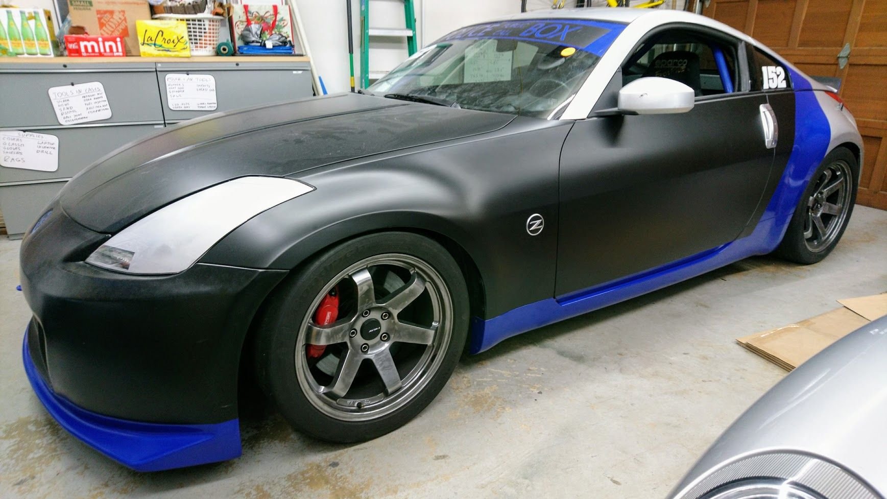

Final step, the lip is done, I think I'm gonna leave it like this at least for now

Took advantage of the warm weather and washed the Z before loading it up. First track event of the season is at Summit Point in 2 weeks.

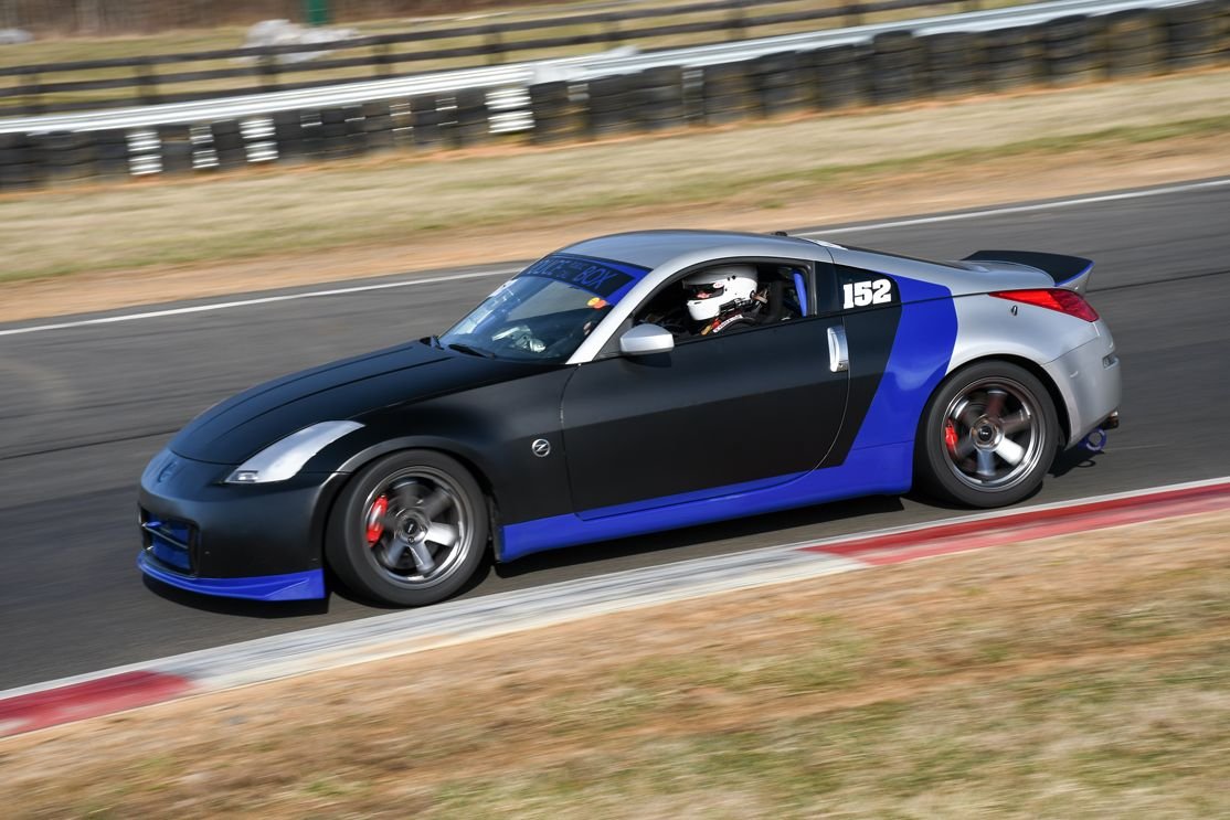

Was at Summit last weekend with Audi club, 2 days of pretty much perfect conditions. On the first day I managed 1:28.8 lap time and I felt like the initial turn-in grip was not there. After softening the front sway bar and tweaking the rear coil over settings the car felt a bit better, but I think at this point the tires are just cycled out, the date on them is 2014 and I've been running them for over a year. On second day I only managed to match the 1:28.8 time, although this time with a passenger, so with fresh rubber I can probably do better. Still getting some rubber buildup in a narrow band on the tires but after reducing the camber all around the band has now moved more toward the center of the tire and is significantly smaller so the vibration is less noticeable and the tires don't seem to overheat anymore. I'll probably still take out another half degree all around to at least try to get the buildup centered on the tire so it scrubs off quicker and wears better.
I also ordered SPL front sway bar adjustable end links and solid rear shock mounts, since it's now a true coil-over setup and the rubber bushings have a lot of play in them.

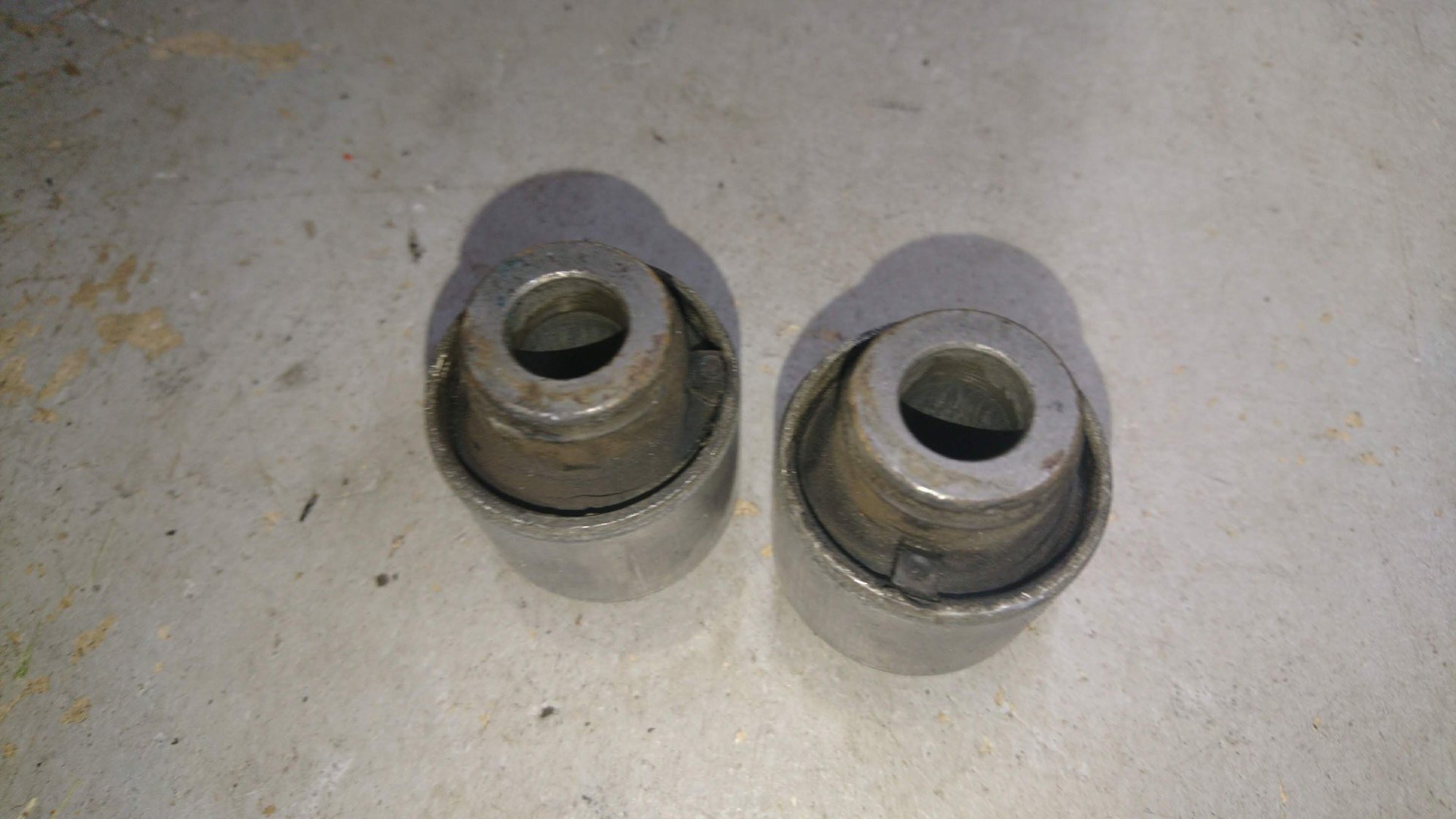

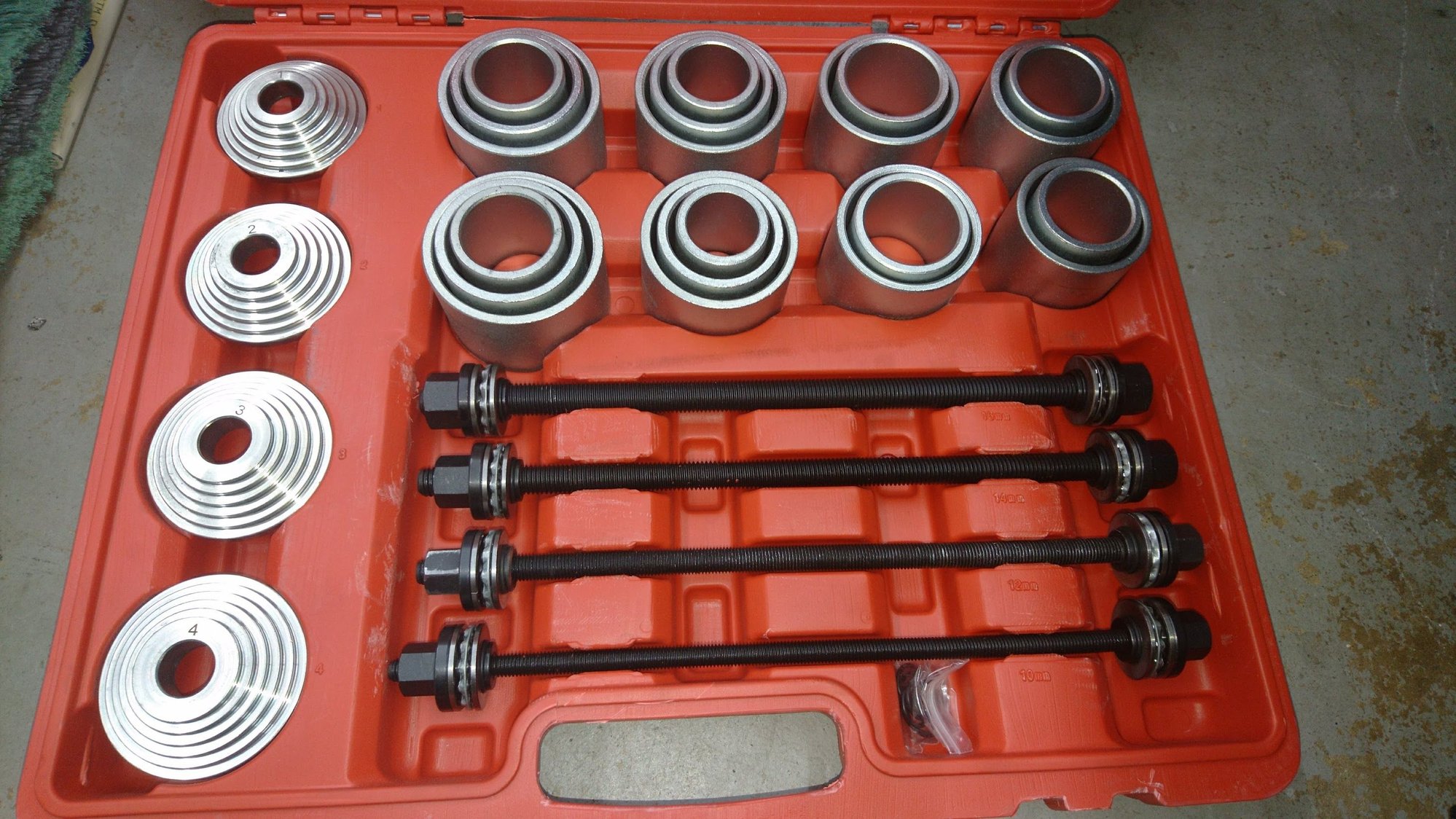

Managed to replace the rear strut mount bushings. Had to buy a threaded rod pusher/puller set to get it done without removing the whole thing from the car. Freezing the solid SPL bushings did help and overall it went fairly smoothly.

Do you have any more details on brand of this. Looks like something I wish I had many times.
Old Aug 29, 2021 | 07:54 AM
  #199
Dr Hoon's Avatar
Dr Hoon
5 Year Member
Joined: Jun 2019
Posts: 621
Likes: 336
From: NoVa
Several to choose from on Amazon, here's the one I got
https://smile.amazon.com/dp/B077444L...ing=UTF8&psc=1
