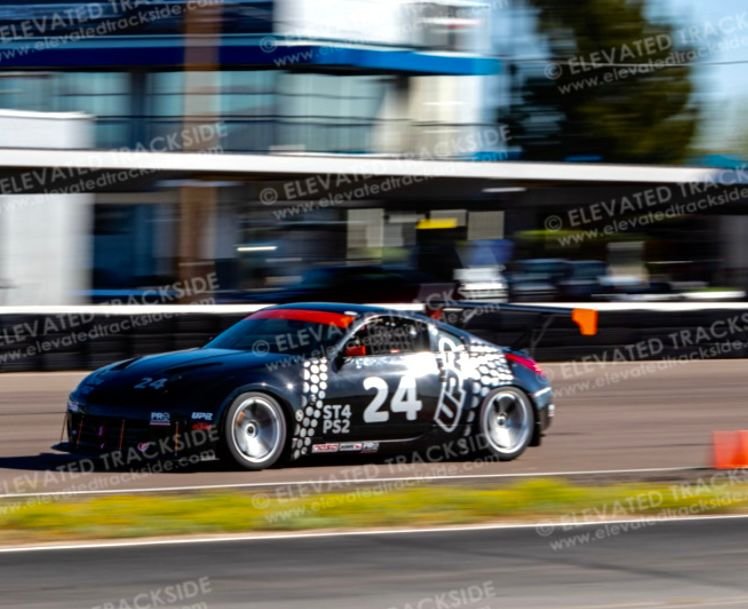

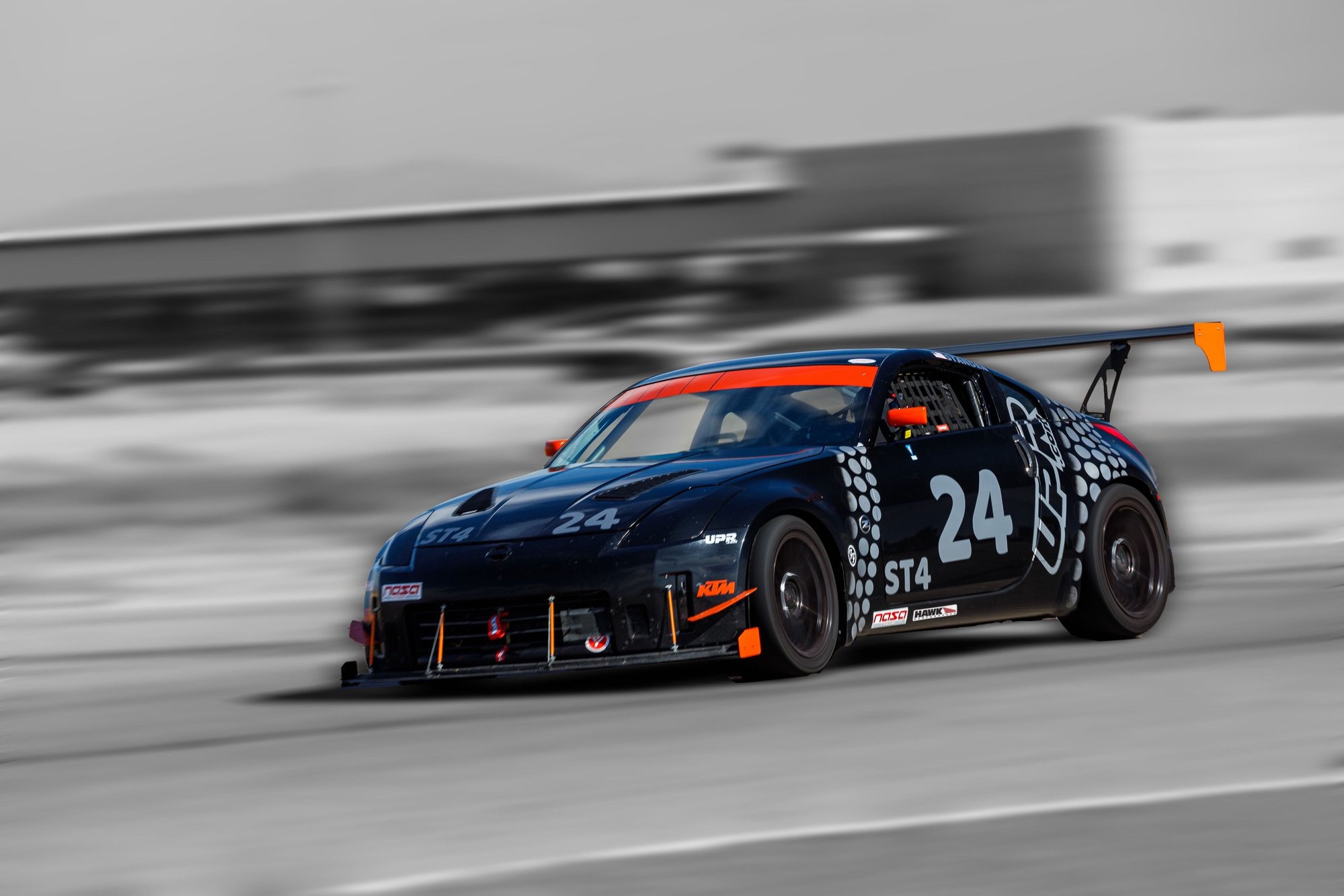

Hi,
I've been lurking for a couple of years while I built this; thanks for all the great content to sift through. I've been running it for about a year and it's fairly fast, but still a bit heavy..... hard to lose weight on these; every piece of unneeded sheet metal is gone including the speaker/storage tray, etc
Below is the summary build sheet (pdf) and pics in case it helps anyone else in the throes of building a track car. Please ask if I can answer any questions

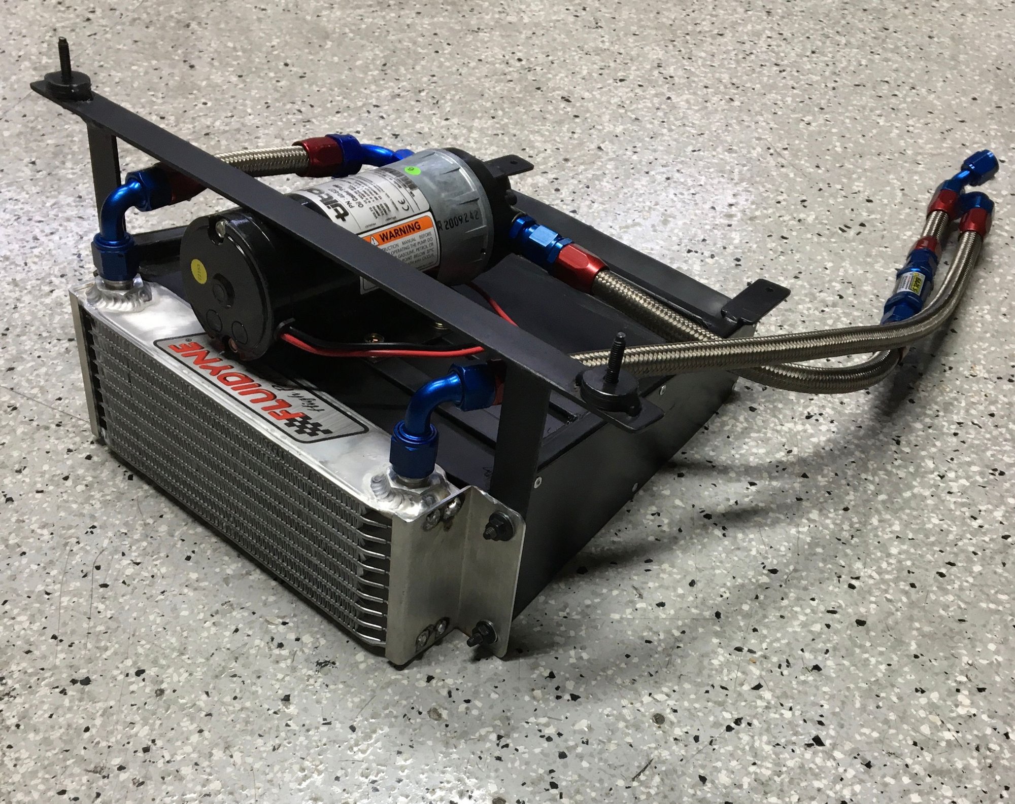

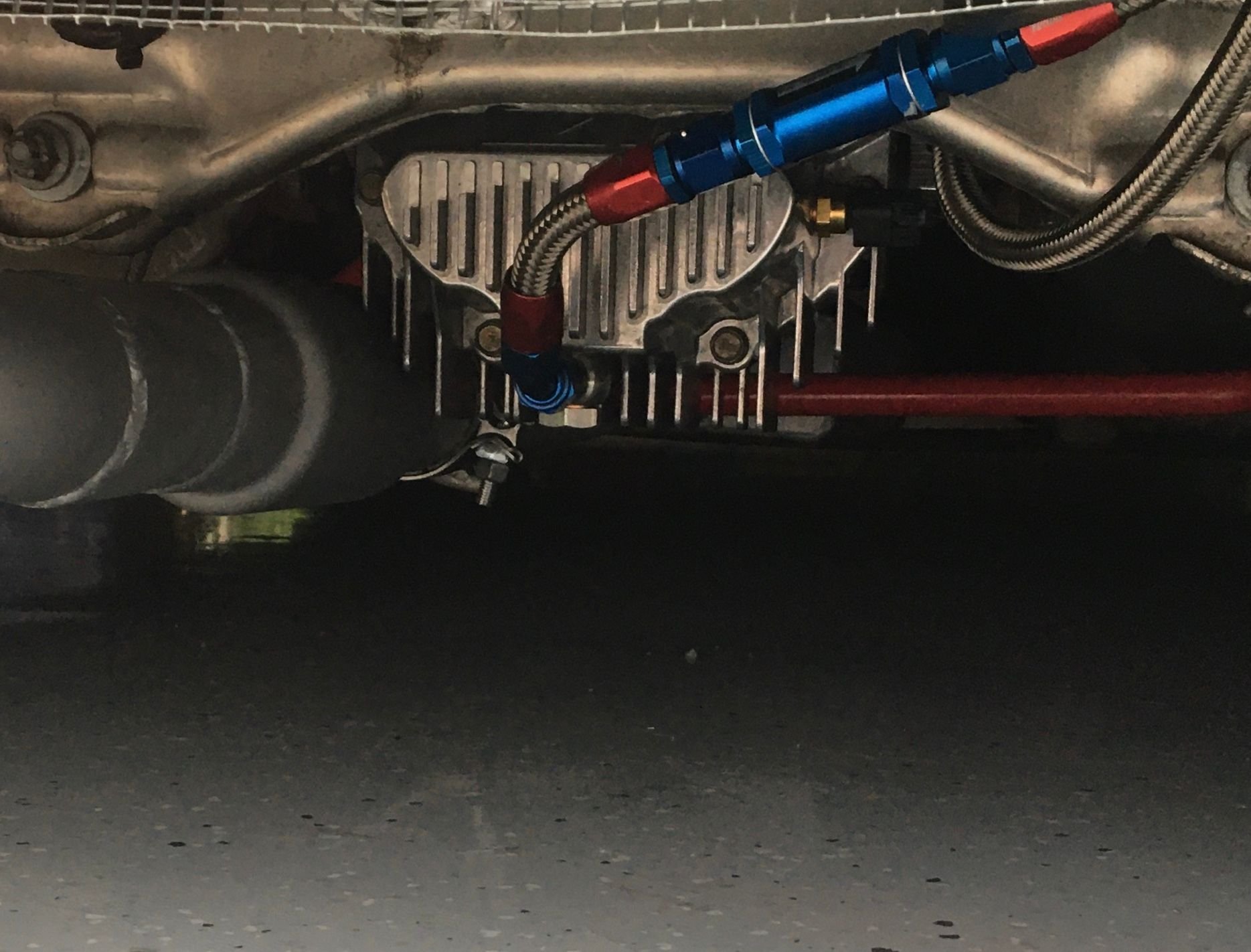

Here are some pics of the diff oil cooler I built….. I have a temp sender to my AIM MXG and it’ll run 290 degrees without the cooler…. kaas 1.5 LSD, 4.08 rear gear
with cooler, 215 degrees

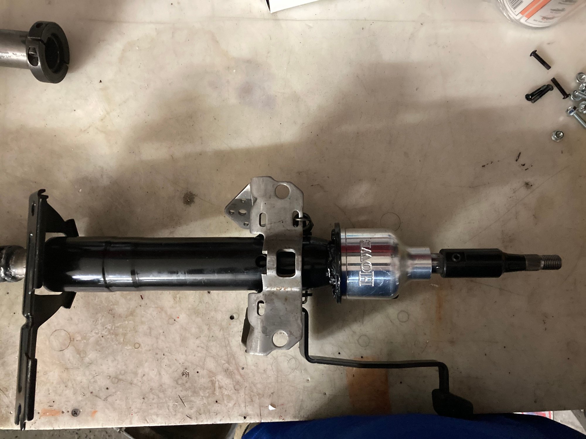

Another fav I wasn’t sure of originally is the 1.5:1 steering quickener…… huge benefit on track as I have two rebuilt and limited motion shoulders….. benefits everyone though

You're running the pump before the cooler? In the Tilton manual is says specifically not to do that so not to burn out the pump with hot fluid, they highly recommend running the pump after the cooler.
