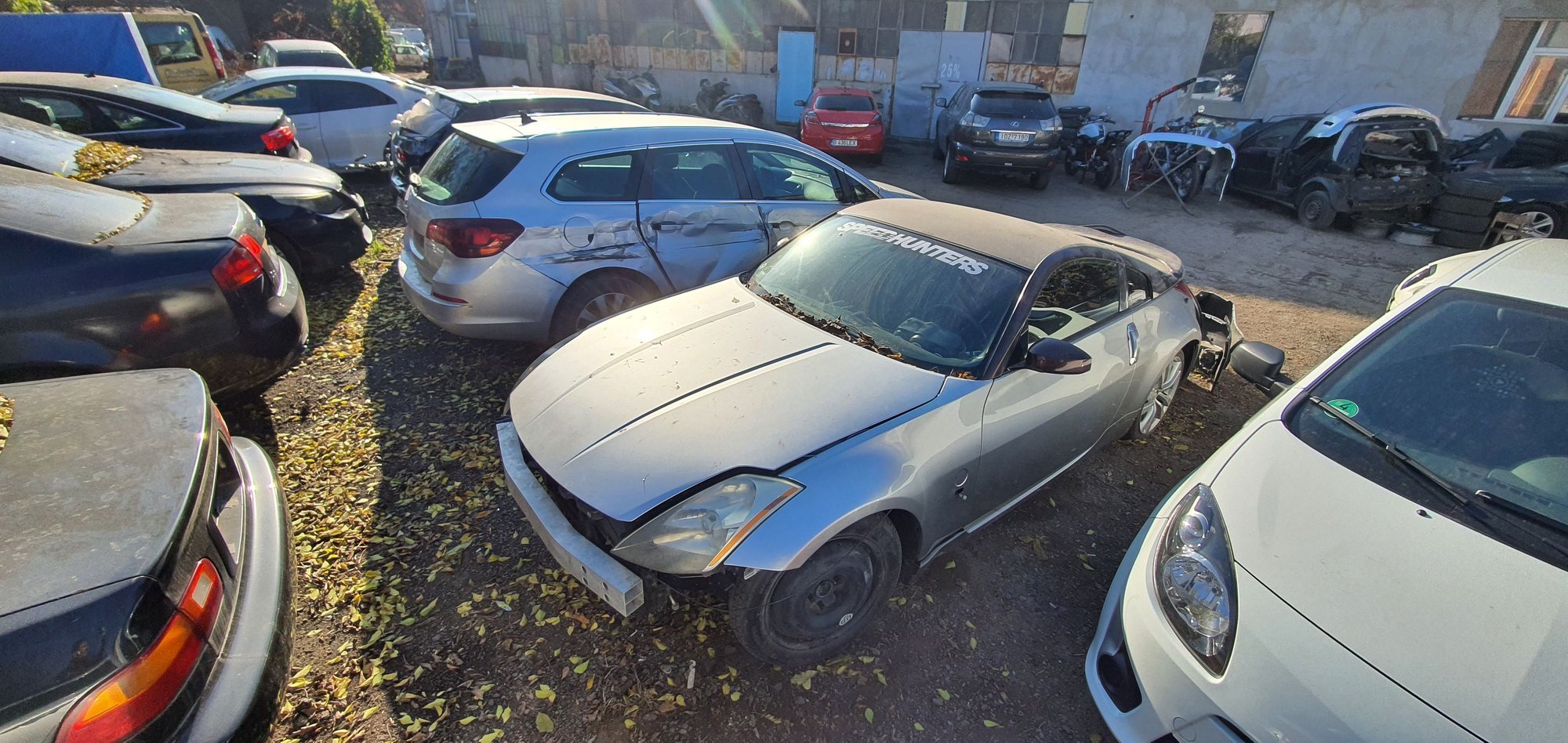

I have the Z since last year and had a light damage on the front right. After almost fixing it a friend of mine told me that the new season of the National Time Attack is coming up and that i should race with the car.....and SO I DID !

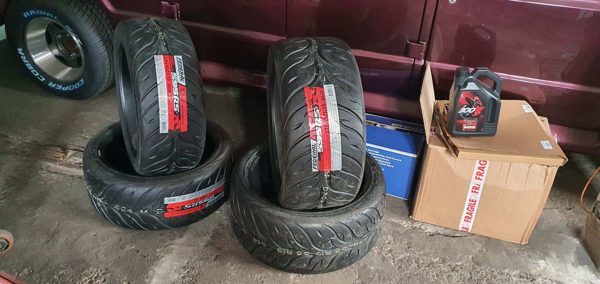

I had 2 weeks to prep the car ( The car was bone stock),in such short time I did the obvious,
RACING: Brake Pads ,Brake lines ,Brake fluid ,Tyres ,Oil cooling, different wheel alignment from stock and basic maintenance like fresh oils, spark plugs.....and so on.

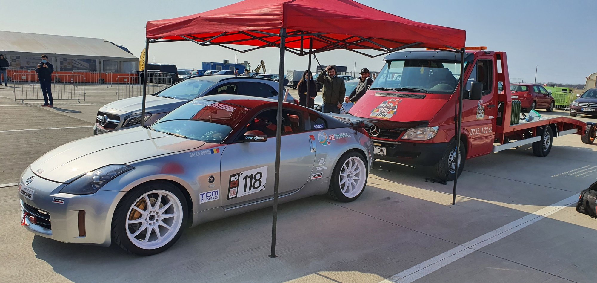

AND I WENT RACING, I did not know the track, I did not know the rules, not even where the registration office was.....everything was new.
In the first Race of the season in my class was 18 cars I finished 12....
Second race DNF, the throttle body broke....
Third race of the season I Finished second place.....AND THEN IT ALL STARTED

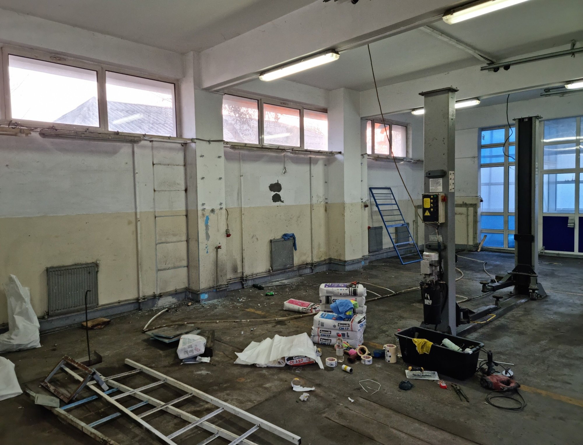

Like I said , very crappy but the construction guys are working hard

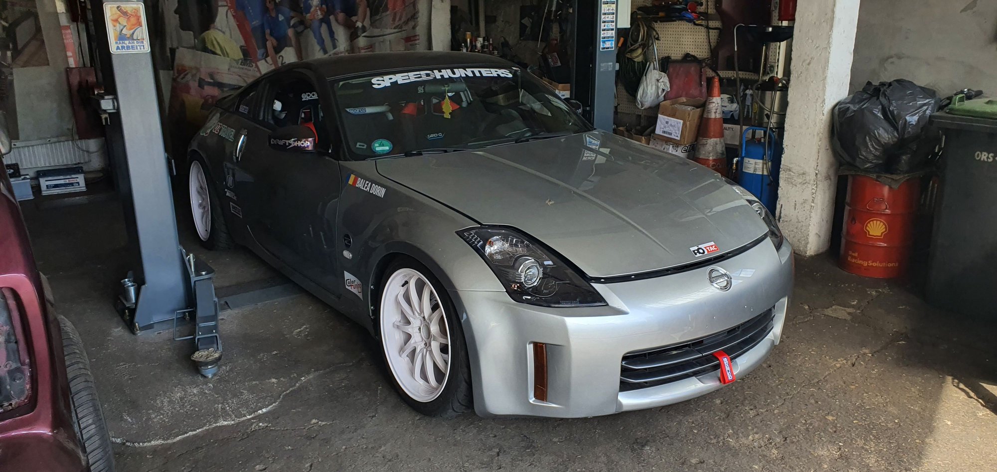

that lift is a step above what most guys are doing. I just have jack stands & a couple of nice jacks and a broken toe to prove it.
what did you do with the engine when you pulled it? I was surprised to see you pulled the engine but haven't touched the suspension so the engine must have been toast?

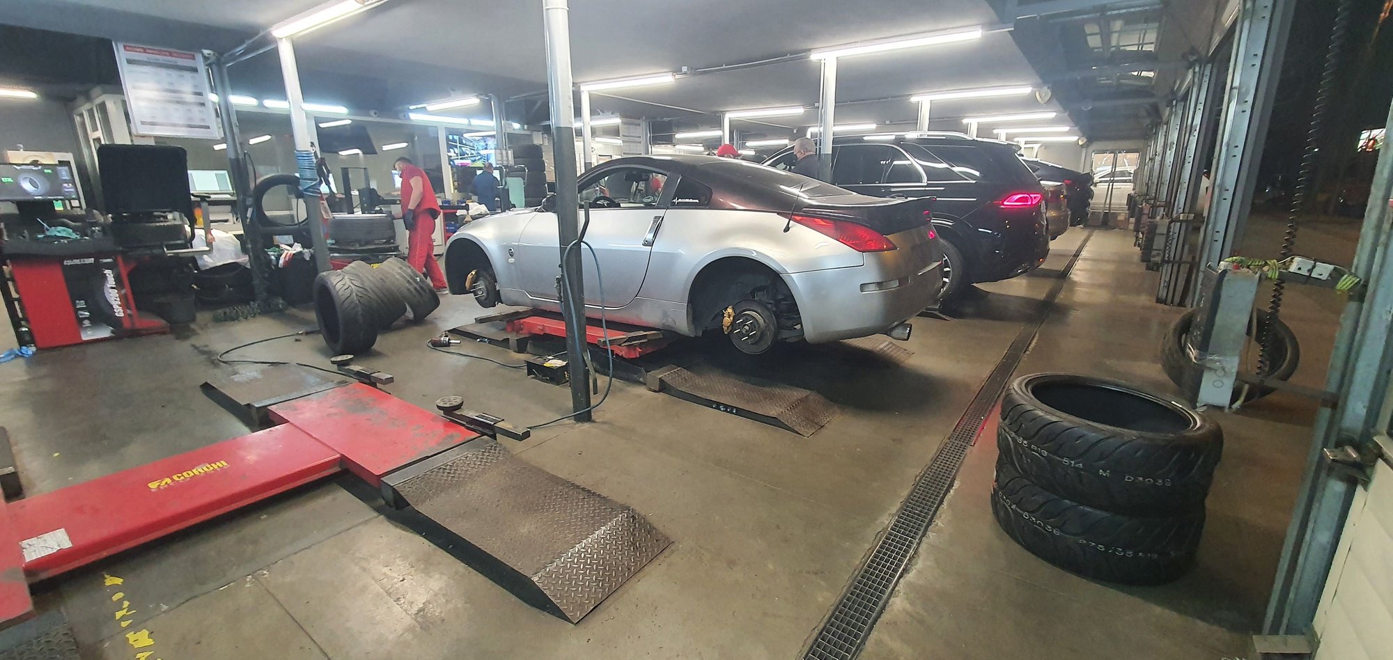

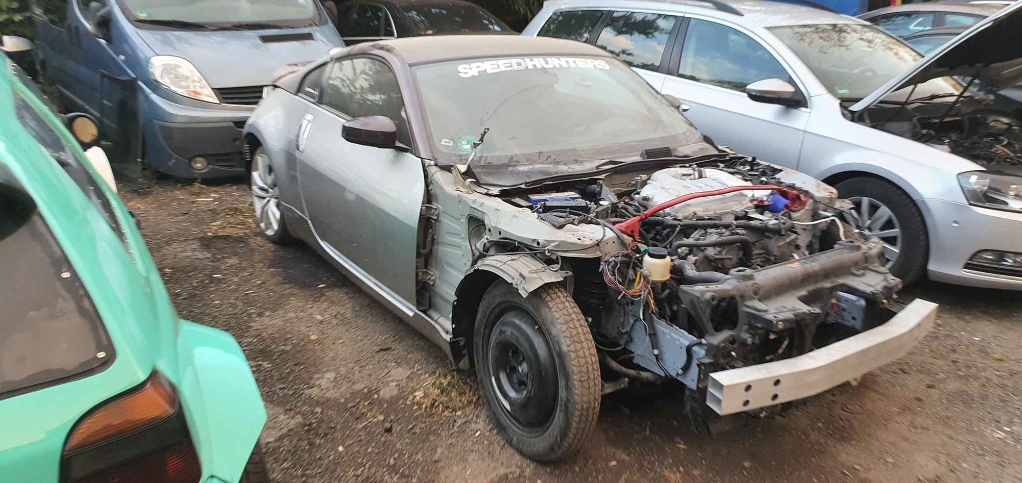

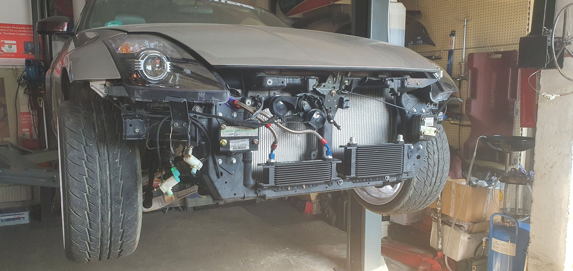

No problems with the engine, I pulled the engine out for 2 reasons:
1. I bought the car with slight damage on the front right and the front had a slight bend and the engine was in the way
2. With the engine out is much easy to change the headers, the problem was because they were China after install tried to put the engine back but driver side header was hitting the steering shaft......so finaly only ended up with installing decats and Y pipe
I did not swap the suspension because I had only 2 weeks time and to order them I had to wait 20 days...

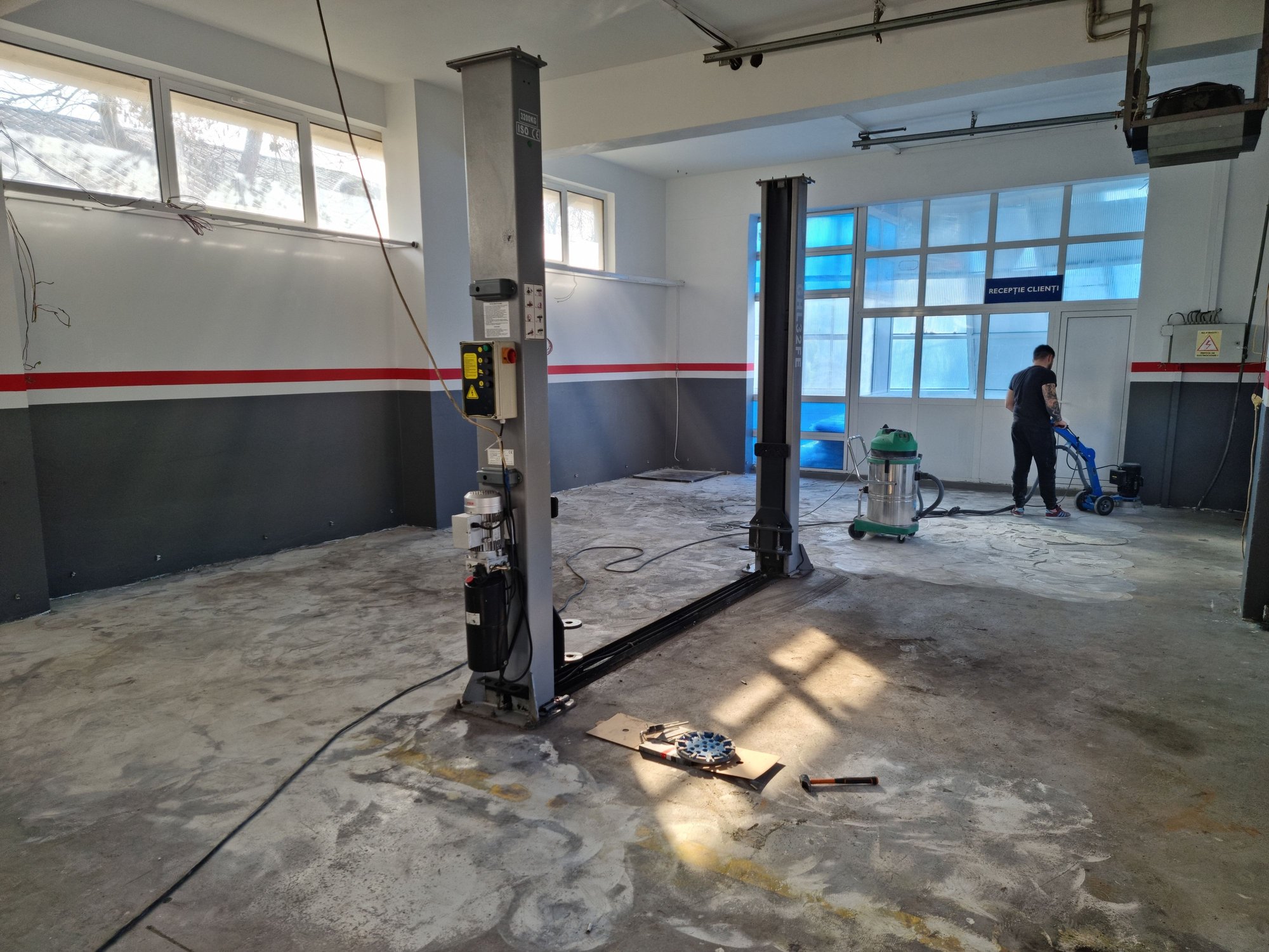

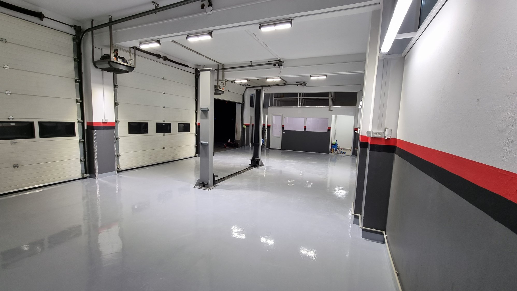

The walls on the workshop almost finished only small things need to be done, hope this weekend to finish the floor and the electric

Working day and night to finish the floor

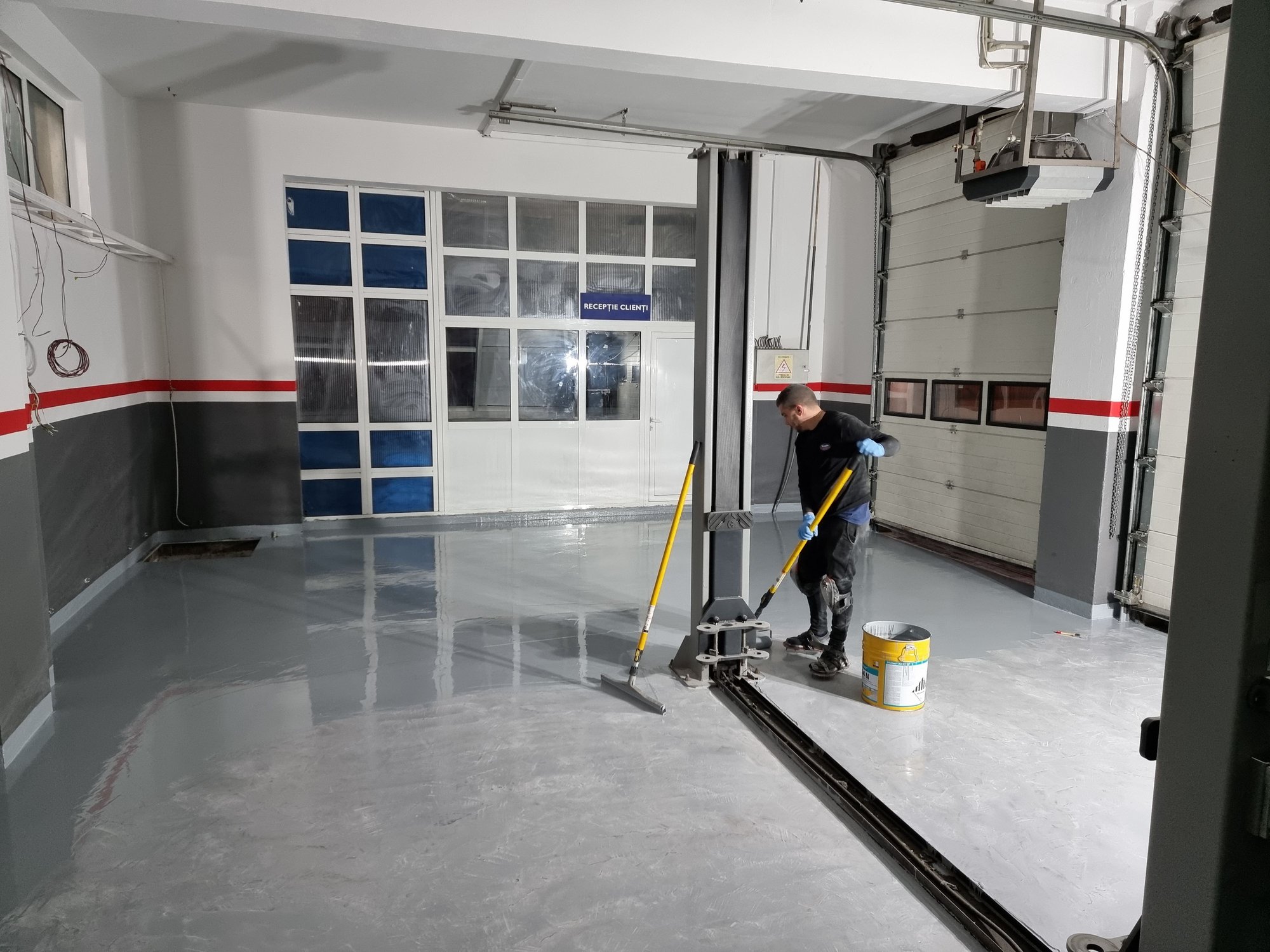

Looks nice- the secret to putting down epoxy flooring is all in the preparation. a good wash and thorough muriatic acid etch really gives the paint something to hang onto.

The floor is finished, I hope it dries well because I still have to fix the electrical installation and lights

So after so much work the workshop is 95% complete, now I have a proper place to start the build. The tools are with UPS I hope to get them this week
