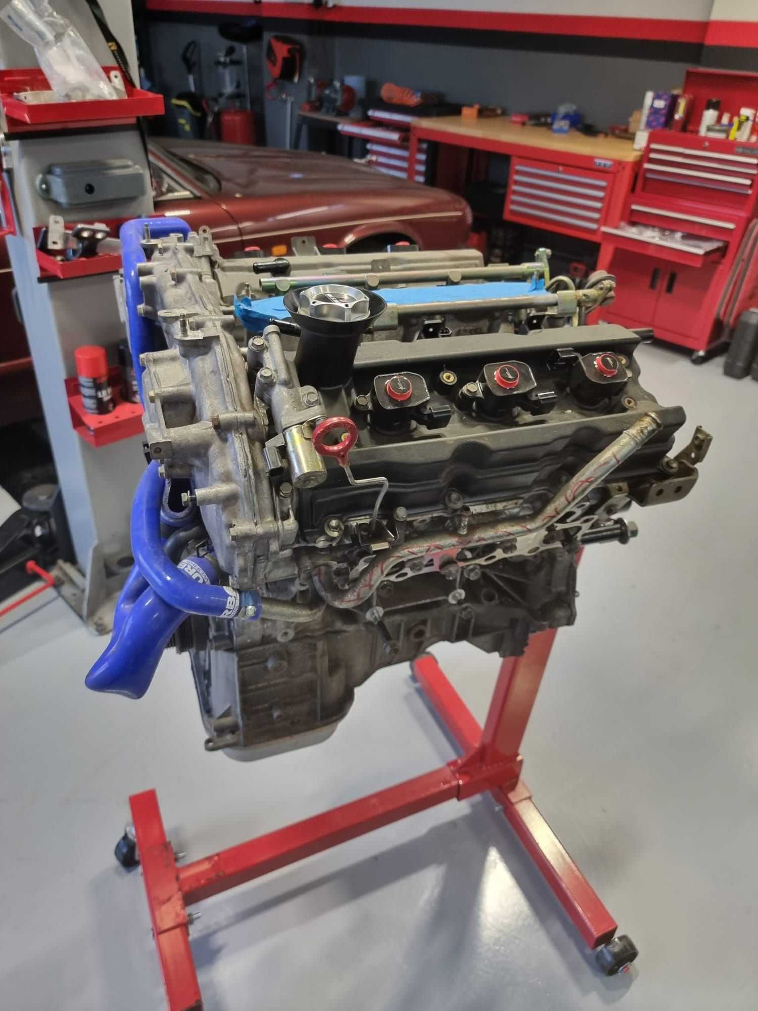

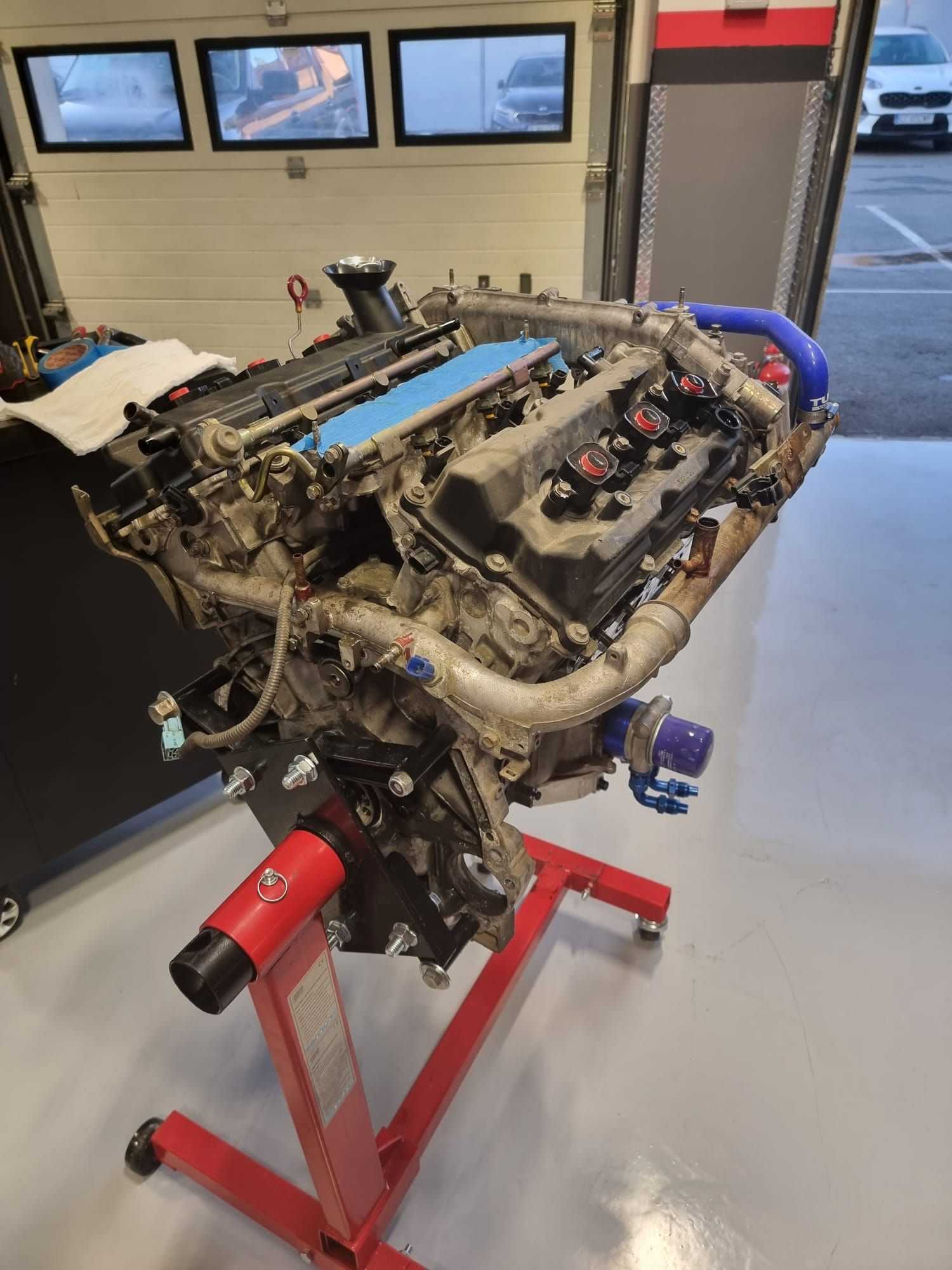

Hey guys I have a dilemma, did any one delete this pipe that goes inside the car for the heat radiator ?
I don't see the point to keep it since is a RACE CAR ?!

It also goes to the intake manifold collector (small port on top) but that's only used to keep the throttle body from freezing up in sub-freezing weather. If you delete both then yes, the pipe can go too. Since I haven't deleted the manifold line yet, I just plugged this pipe at the ends for now.

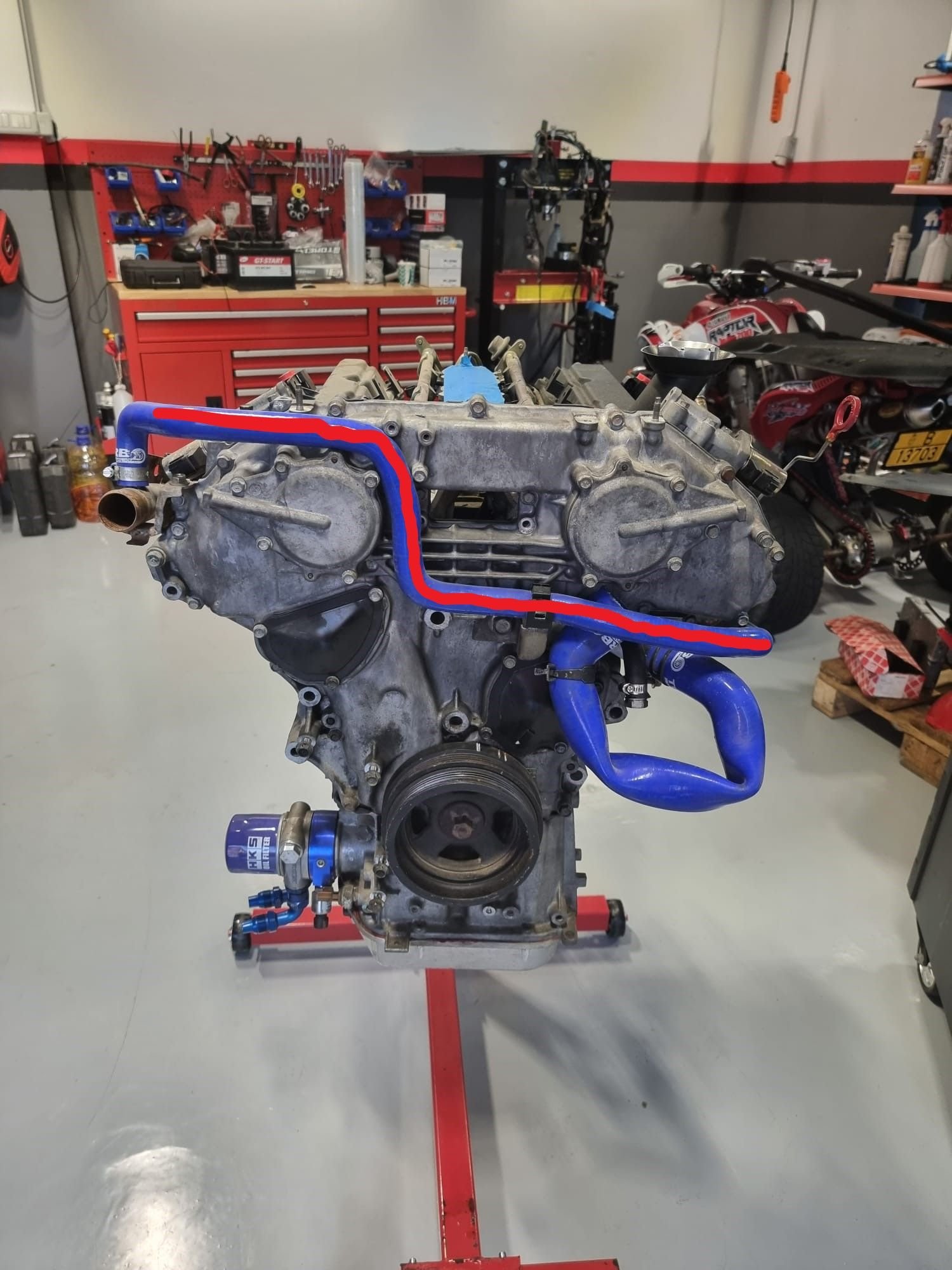

And what about the other pipe that is under this one? I see it goes thru the hose in front of the timing case and connects to the other pipe from the right side of the engine.

That's the bypass line when the engine is cold, the thermostat is closed and there is no flow thru the radiator.

So that is a must to stay on the engine ? or maybe I can delete it if I put a colder thermostat ?

you can probably delete the coolant lines going to the oil filter mount. especially if you're installing an oil cooler.

Look again at my picture with the engine, I did this long time ago in 2021, this pipes are the only ones that I have on the car and I want to delete what is not necesary

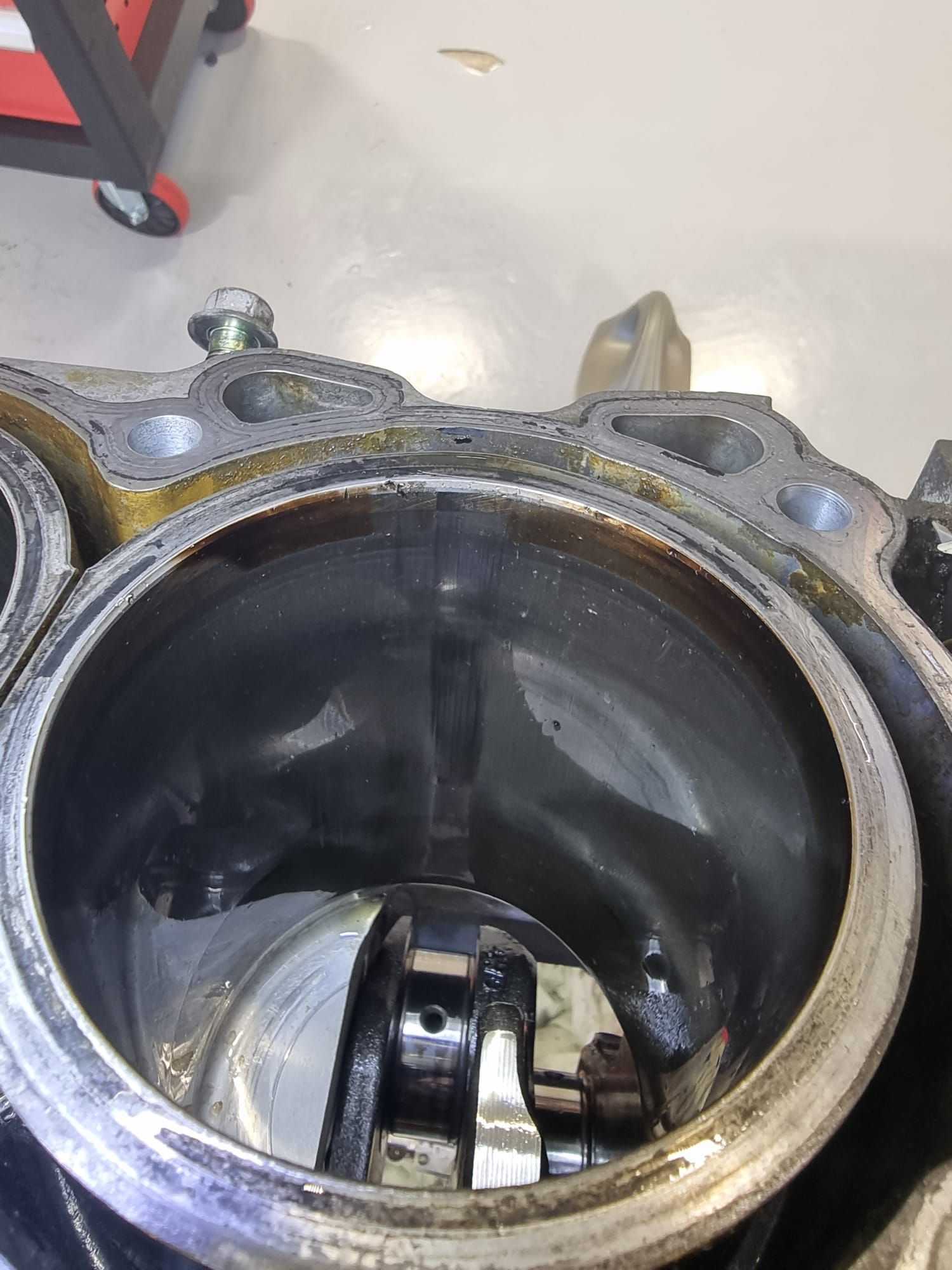

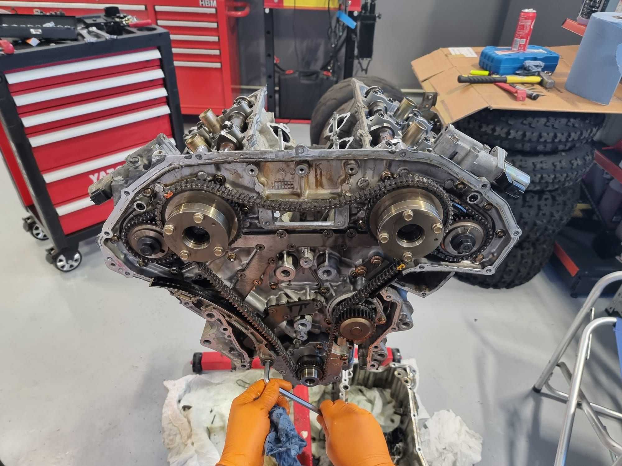

Opened the engine and found a ''SURPRISE''.......

damn, what was in there?!

Looks like it was run without an air filter.

I've seen this kinda damage when the tip of the spark plug broke off and bounced around in the cylinder for a while

No idea what happened.....what is done is done.... Going to measure the block to see if when I bore it from 95.5 to 96, to fit the new pistons, maybe will fix the cylinder.
If not, I have to search for a good used engine....

2. I went with the engine block to a specialist and he told me that boring the cylinders from 95.5 to 96 for the new pistons is going to fix the damage. The marks on the cylinder is not very deep

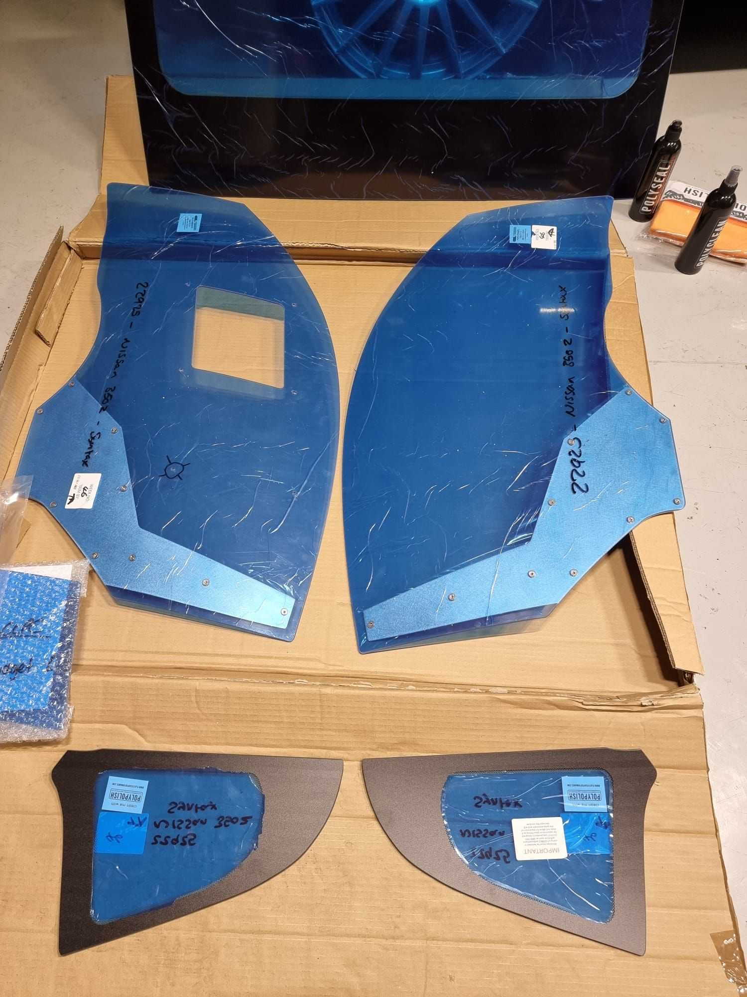

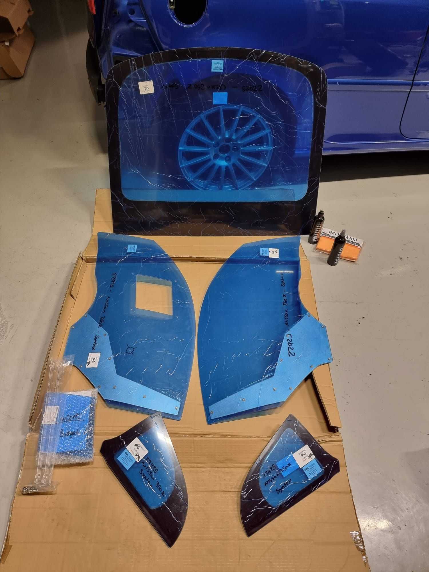

The windows arrived today from Plastics4performance. Very GOOD QUALITY !!!! This are the best Lexan windows that I have seen. I highly recommend them !!!

Nice. Mine are on order for January delivery. But no windshield?

The waiting is worth it trust me !!
I did not get the windshield because in 90% of the racing classes I'm not allowed only in the extreme classes, and I don't want to handicap the car just because it has a Lexan windshield.
So I had to make this compromise. I will take the extra kg from somewhere else ))))

Gotya. I was hoping for a preview of the windshield but I guess I'll have to wait a bit longer.
