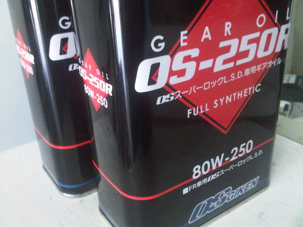

So I placed an order for 2 bottles of OSG oil from Coz but I recently found a local seller for these so I grabbed a couple liters as well - 82usd for a litre of oil fml.
Just to conclude my drama, I wanted to share what happened after we drained the wrong oil and poured the OS Giken Oil in: the moment I pulled out of the garage the LSD produced the same clunking noise and harshness. Few hundred meters of zig-zag driving pattern (completely empty backroad @ 12am), the noise gradually disappeared. Around 15 miles of driving and the noise was completely gone. The OSG LSD operates smoothly now.
The car feels so great powering out of turns! It feels like it is a lot easier to control than with the VLSD. Can't wait to try it out on the upcoming AutoX!
