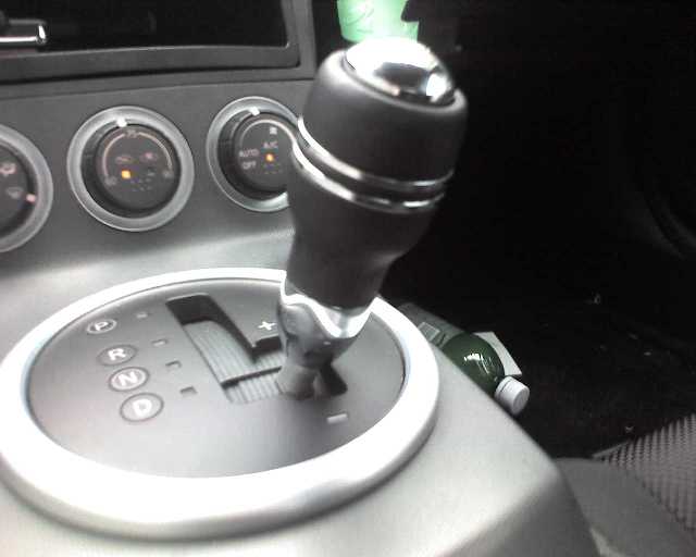

Originally Posted by DukeEntDotCom
Two I took with the Treo...
Thanks for the pic going to do this mod with this shifter, sans blue piece to be nice and low.

A couple of quick questions, I got a Momo boot and Shift ****, want to do this over the weekend:
1. I have an 08, any idea if this will affect the warranty in any way?
2. the momo shift **** has a silver collet at the bottom, if you remove that the boot seems to screw directly onto the shift ****, have people removed this collet?
3. Can the center console silver ring be lifted just enough to tuck the boot inside without having to remove the entire thing out? My boot has elastic on the bottom and is 26 cm long (so longer than your typical one), I want the folded shift boot look so want to keep the length, will this work?
4.. If for some reason I am unsuccessful in getting a good fit, is it easy to put things back the way they originally were?
Old Feb 21, 2009 | 09:07 AM
  #253
james840a's Avatar
james840a
Joined: Jan 2005
Posts: 1,514
From: riverside/san Bernardino CA
Should not affect the warranty on other parts, but if something were to happen to say the mechanizim there at the shifter like any parts inside break, mostly like they will not cover that under any warranty. But i wouldnt really worry about anything.
Yes, since you has a momo shift boot it have a threaded adaptor that the shift know can screw in, so you will remove the collet on the bottom of the shift ****
im not sure how the 08 center consoule is set up, but on my 04 i had to remove the sliver ring and put the boot on, put it is very tricky to get the sliver ring on. I have to modify part of the center black mechanizim and the sliver ring is a tight fit, but i would not force it because you may break some tabs on the inside.
as i said in #3, but if the boot does want to work well and you dont want to risk it, you can put every thing back the way it originally was.
Hope i helped answer some of your questions
