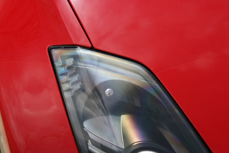

After painting headlight black, scratches become REALLY apparent. I tried Powerball and Mother's PowerPlastic today. Huge improvement, but I would say took care of 98% of the problem. Pics below:
Fig 1: Before Shot, Driver's Side.
Fig 2: Some prep work.
Fig 3: In progress... go easy with application of polish, as you can see once the powerball spins it will splatter. I found it best to apply a little to the ball, then rub it onto the surface of the headlight to spread it around first. Then spin up the drill slowly.
Fig 4: After buffing.
Fig 5: Close-up After shot. As you can see, some scratches are still apparent but very subdued. This was as good as I could get it, but unless you are this close you will not see it.
Fig 6: Passenger side appeared worse...
Fig 7: ...but cleaned up better. I would say 99% gone on this side.
Fig 8: Driver's side after in direct sun.
Fig 9: Passenger side after, direct sun.

^that's WOW!
very good job!! i need to get PlastX soon, because my current application is washing away and fog is coming back.
btw, u did the black out urself?

Thanks! Yes, I did black them out myself.
