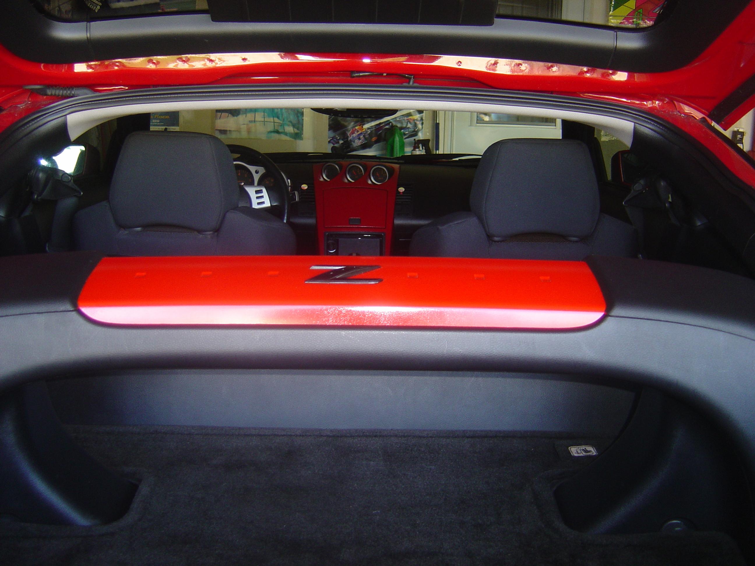

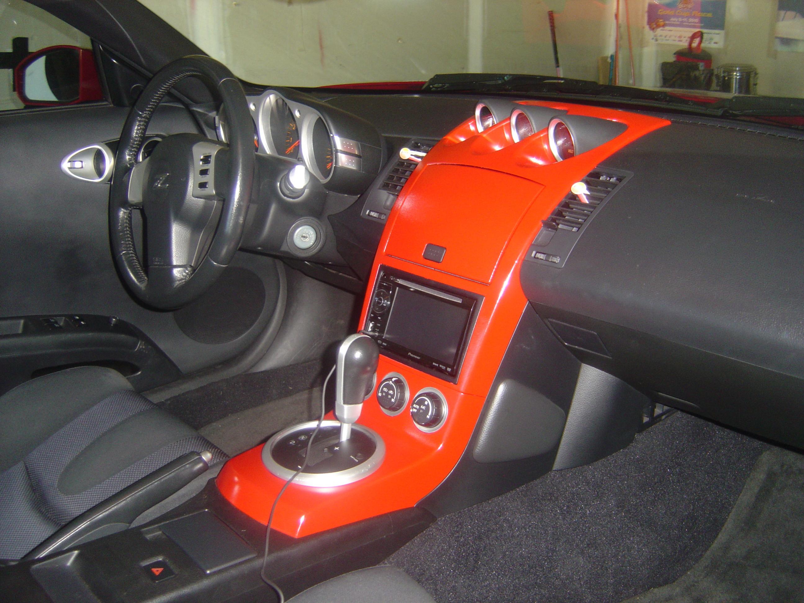

Thank you, great write up. i did mine red to match the car. Couldnt have done it without this diy, did the strut bar cover as well, turned out great.
