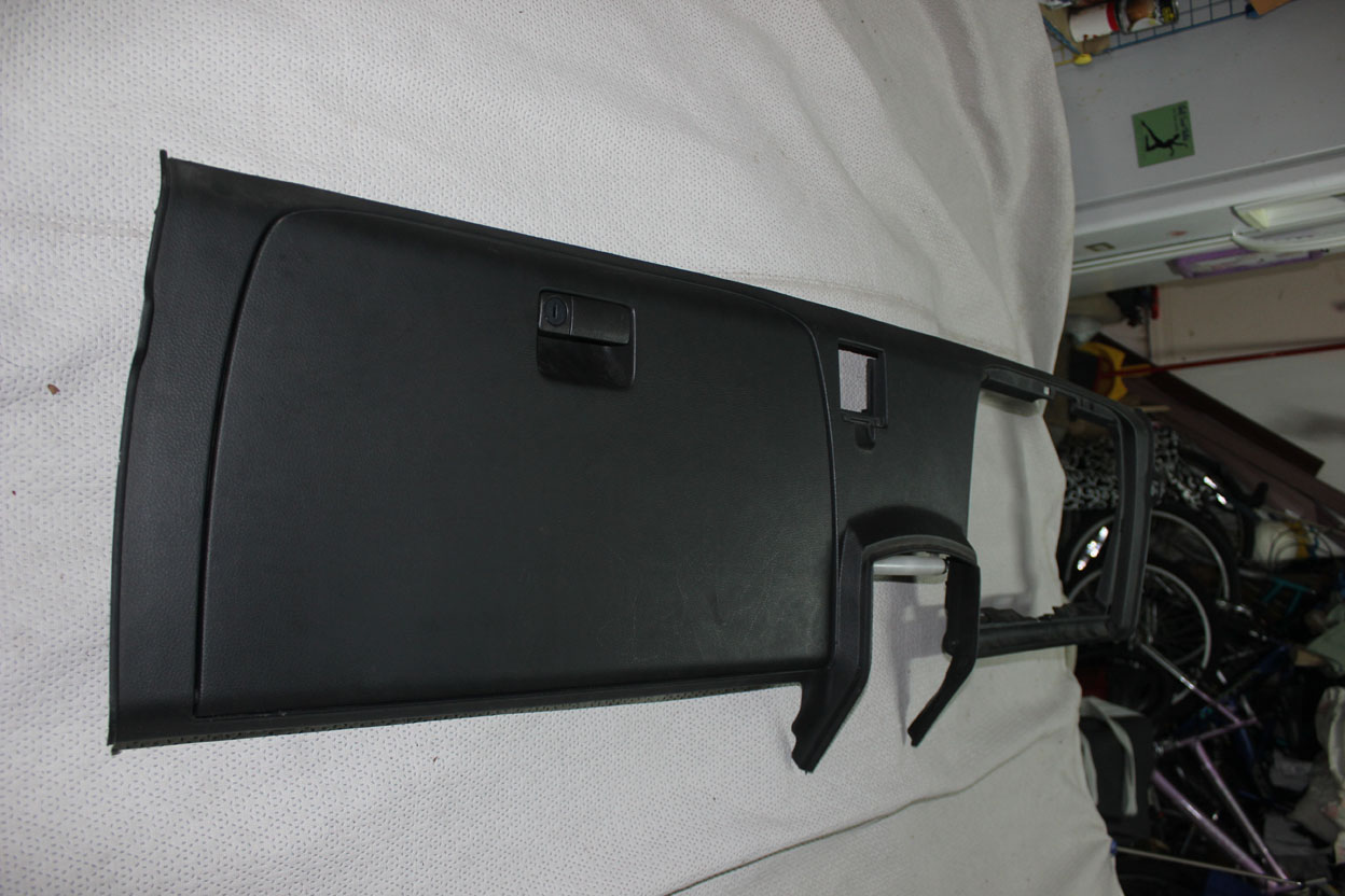

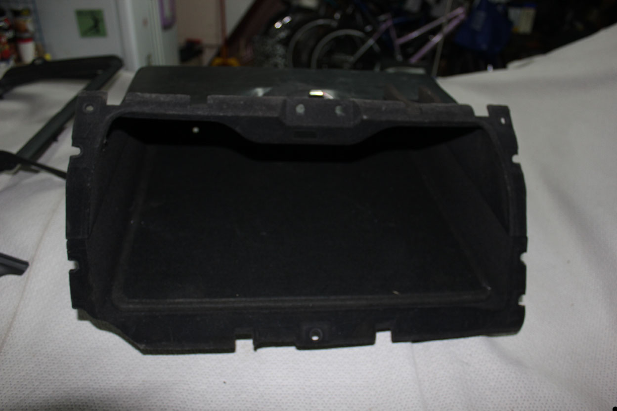

1 - rear compartment found from junk yard or ebay
2 - rear door trim with original door and string lanyard.
3 - the latch catch that the door latch catches on.

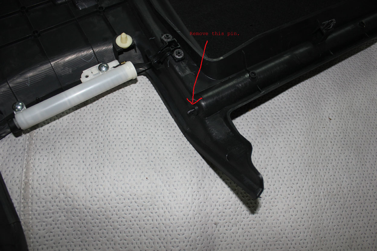

1 - remove the inside roll pin from the door with a suitable tool. I used wire cutters as with just slight squeezing pressure I was able to pull the pin out without cutting the pin. Put pin in a safe spot.

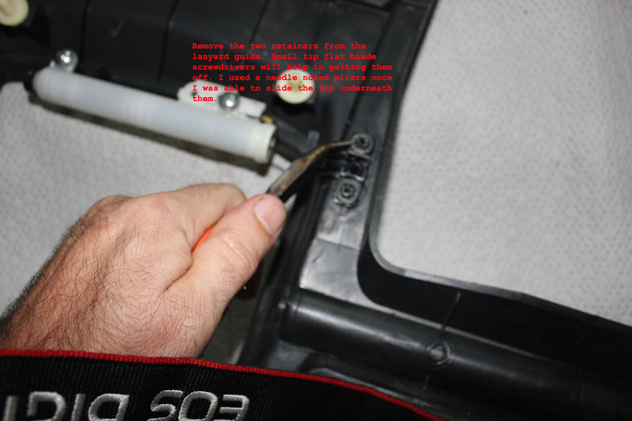

1 - remove the pin washers off of the lanyard guide and lift the guide off

Step 3 - original door trim removal. Here we need to get the original trim out of the car. You can refer to various threads on how to get that bad boy out, but I'll detail what I did as best as I can.
NOTE: Door Trim here is referring to the trim that holds the two compartment doors not the car door themselves.
1 - remove the two screws on each side of the center console. Also remove one screw under the ash tray. That will give you enough room to pull the door trim out.

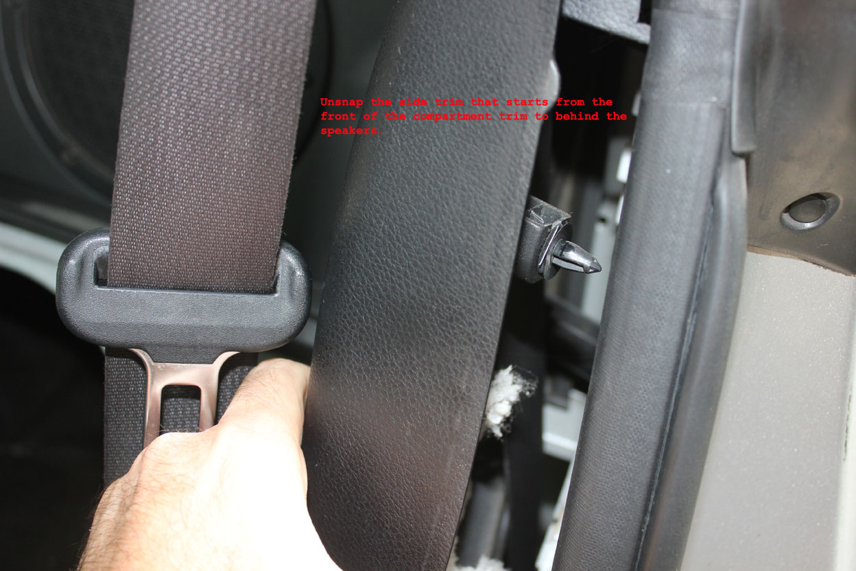

5 - around the seat belt mounting locations there are two larger side trim pieces that start from just behind the seat to behind the speakers, they unsnap pretty easily

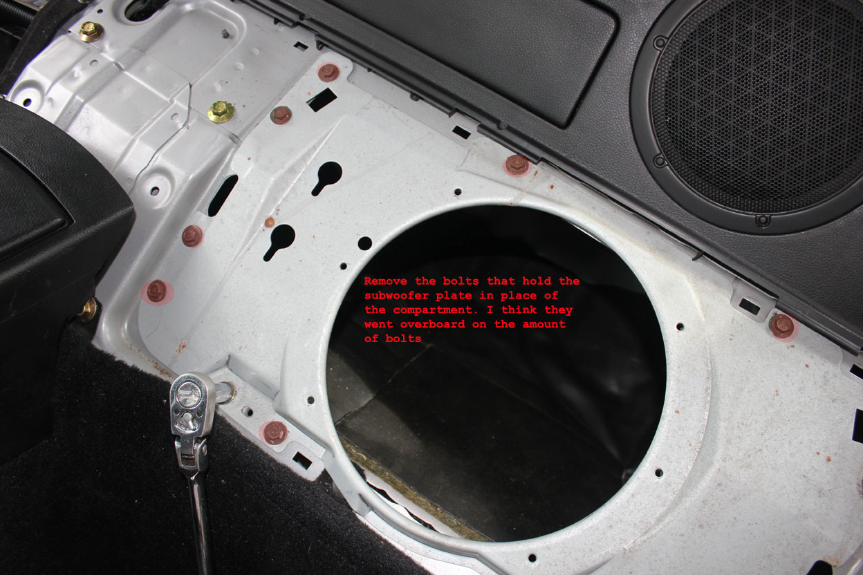

Step 4 - subwoofer plate removal and new compartment installation.
This is pretty simple
1 - not sure of the bolt size (10mm I think), remove all of the bolts attaching the subwoofer plate.

4 - re-install as many bolts as required to attach the new compartment in the location. You will have extra bolts. I didn't feel the need to make the adapter plate that lowers the threaded inserts for the bolts in the back of the compartment. The compartment seems sturdy enough for anything I might put there.

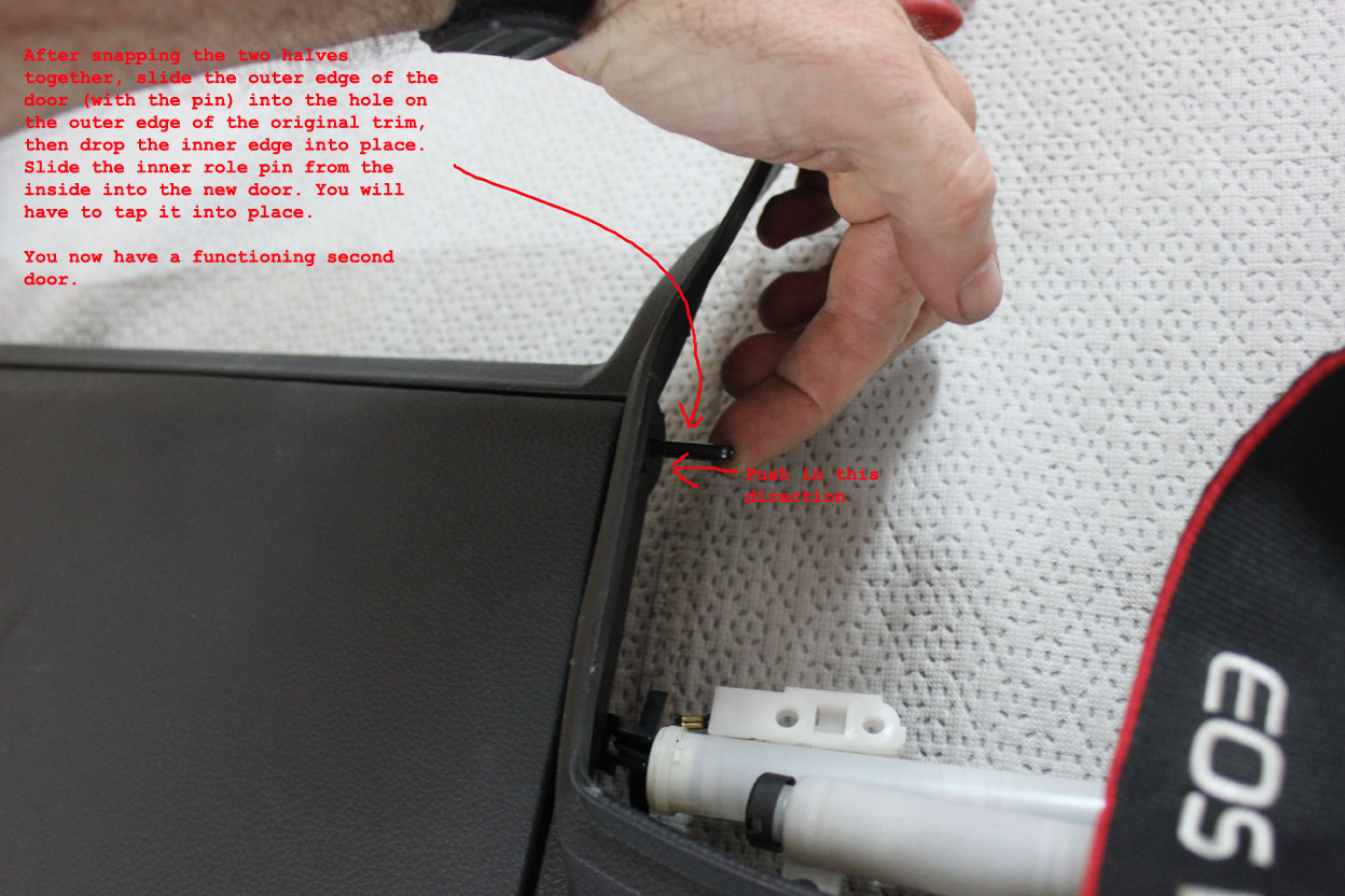

2 - turn the door trim so that the grain faces you, lay the felted side of the new door face down and thread the lanyard loop through the new hole you drilled and attach the loop on the pin provided.
3 - if you followed my instructions you should have one of the roll pins installed and it should be on the outside edge of the inner felted door half. Slide the outer door half over the roll pin and snap the two halves together. Alternatively if neither side has the roll pin inserted simply snap the two halves together making sure the lanyard loop doesn't come off the pin. If doing alternate route, install one of the roll pins on the outside edge of the door. and slide that pin into the hole of the outside edge of the door trim.
4 - lay the inner side of the door in its proper position and install the second roll pin from the inside (transmission tunnel side)
5 - attach the five screws through the felt securing the two halves more securely than just snapping them. Attach the two screws for the latch.
6 - using zip ties attach the lanyard re-tractor just below the original lanyard re-tractor. Put the zip ties through at least one if not all three holes that the re-tractor has other wise it will slip. It has to be below the original, above there is no room.
