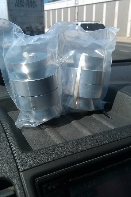

I Would like to thank ACIDJAKE75 for some of the pics provided as we did our installs within days of each other as I actually drove down to Austin while on a trip to SA and picked up my set along with the 3rd set for Nexx........
(my set shown here in my Xterra)
82fb1c4a.jpg?t=1281500433
My pup going with me to pick them up in Austin:
e904928e.jpg?t=1281982542
-J
