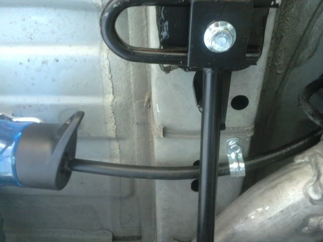

The factory Nissan design, the 350z rear diff has a breather hose, but if it gets to hot and pours out fluid the breather hose dumps it into the rear sub frame versus letting it fall on the road or track. The sub frame catches the fluid and there it stays for all the remaining Z years, driver unknowing he lost differential gear fluid..........
Subframe OEM breather line:
Target hard clear plastic water bottle:
I used this bottle because it was clear, hard plastic so it should hold the hot diff fluid and the top nossle design was easy to retro fit a typical barb fitting to attach my hose with little to no modification. It was about $8.99 so its easily replaceable.
Bottle cage mounted:
I have a single exhaust so I removed the oem heat shield. The remaining heat shield bolt studs were hanging down, so i used the drivers side rear stud with a lock washer and nut (M8x1.25), had to drill the water bottle cage hole a little bigger as well. I bought the universal strap water bottle cage at walmart for like $6 bucks. I then simply used a sheet metal self taping screw for the front water bottle cage hole mount location....the opposite side is the spare tire, remove the spare first. I carry no spare, so no biggy for me...one day ill file it down or replace with a nut and bolt but for now I'm good.
To connect the hose, i need to just buy or build a 1/4" to 3/8" barb fitting and run some hose......

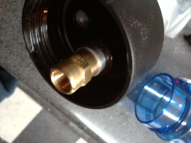

REFILL THE DIFF:
I'm not done.....I plan on adding an AN fitting 90 degree elbow fitting to the differential FILL port, then an SS line going up to the rear hatch floor. I plan on drilling a hole and having a diff fill port with a AN fitting cap back there for super simple diff fills inside the car!
I don't need a diff cooler.....I'm not constantly cooking fluid, but my Nismo LSD does get it all going at drift events to loose "some" fluid.....if i was road racing many hot laps, i would most likely be designing a diff cooler, pump and all...
This set up will allow me to monitor (clear bottle) easily, re-fill accordingly, etc....

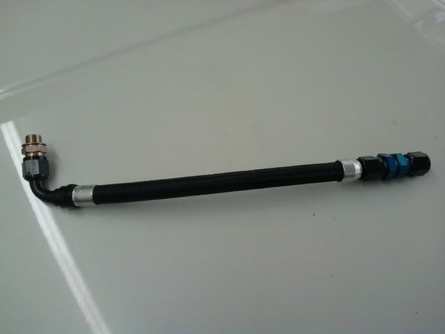

Originally Posted by JasonZ-YA
I worked a little today on my Diff fill port:
This is just mocked up....you can see the end on the right isnt crimped....once i determine the length I need ill cut and crimp it.
From left to right on that hose its:
M18x1.5 to AN10
AN10 90 degree crimped to
kevlar hose
AN10 straight fitting - not crimped yet
AN10 blue bulkhead break through and nut
AN10 black CAP
I drilled a pilot hole with a super long drill bit here and then opened it up big from the other side using a step drill bit:
I plan on filling my diff using this inside the hatch:
-J
If you have the subframe down, then you wont need the long drill bit....
-J
