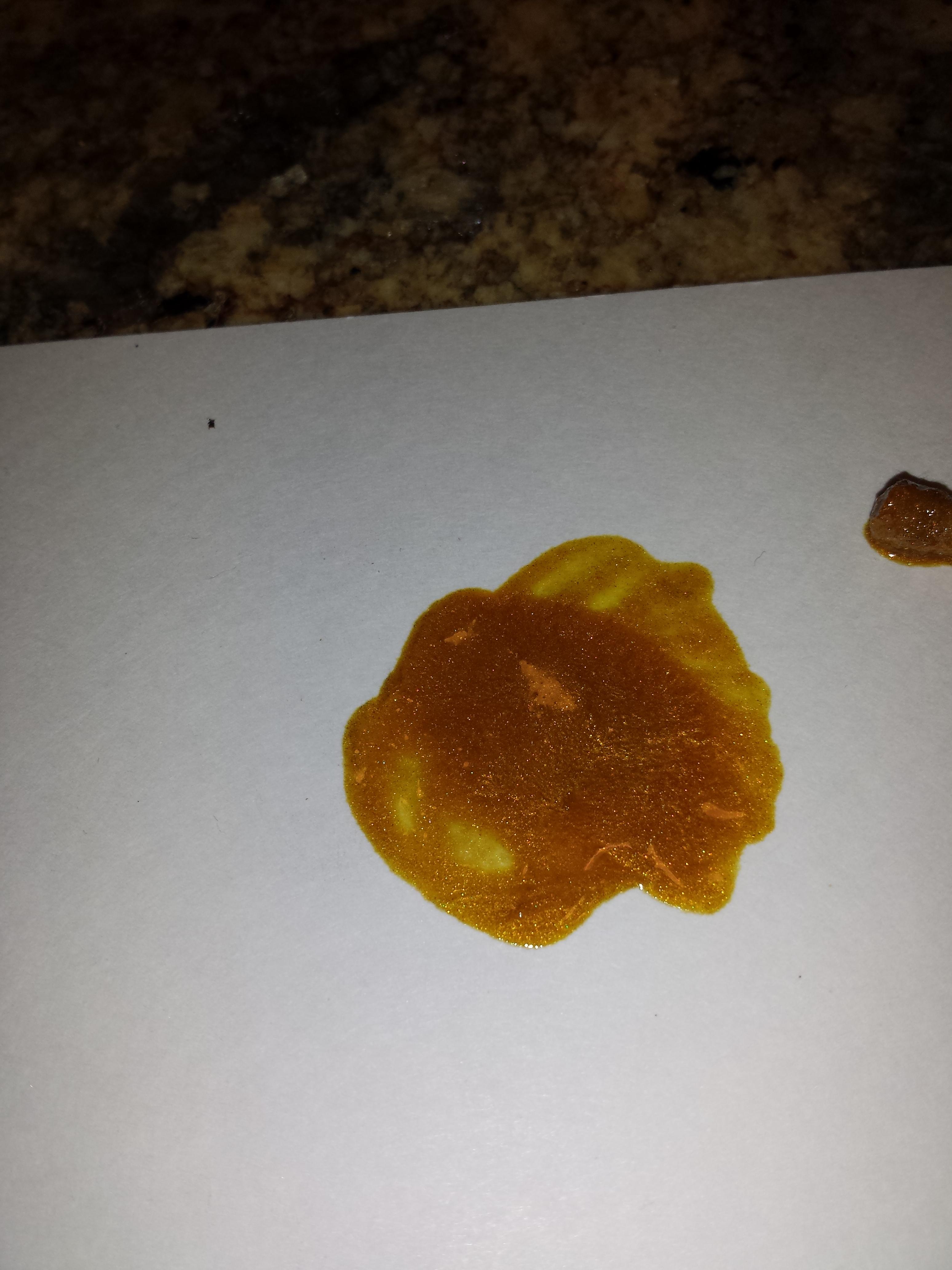

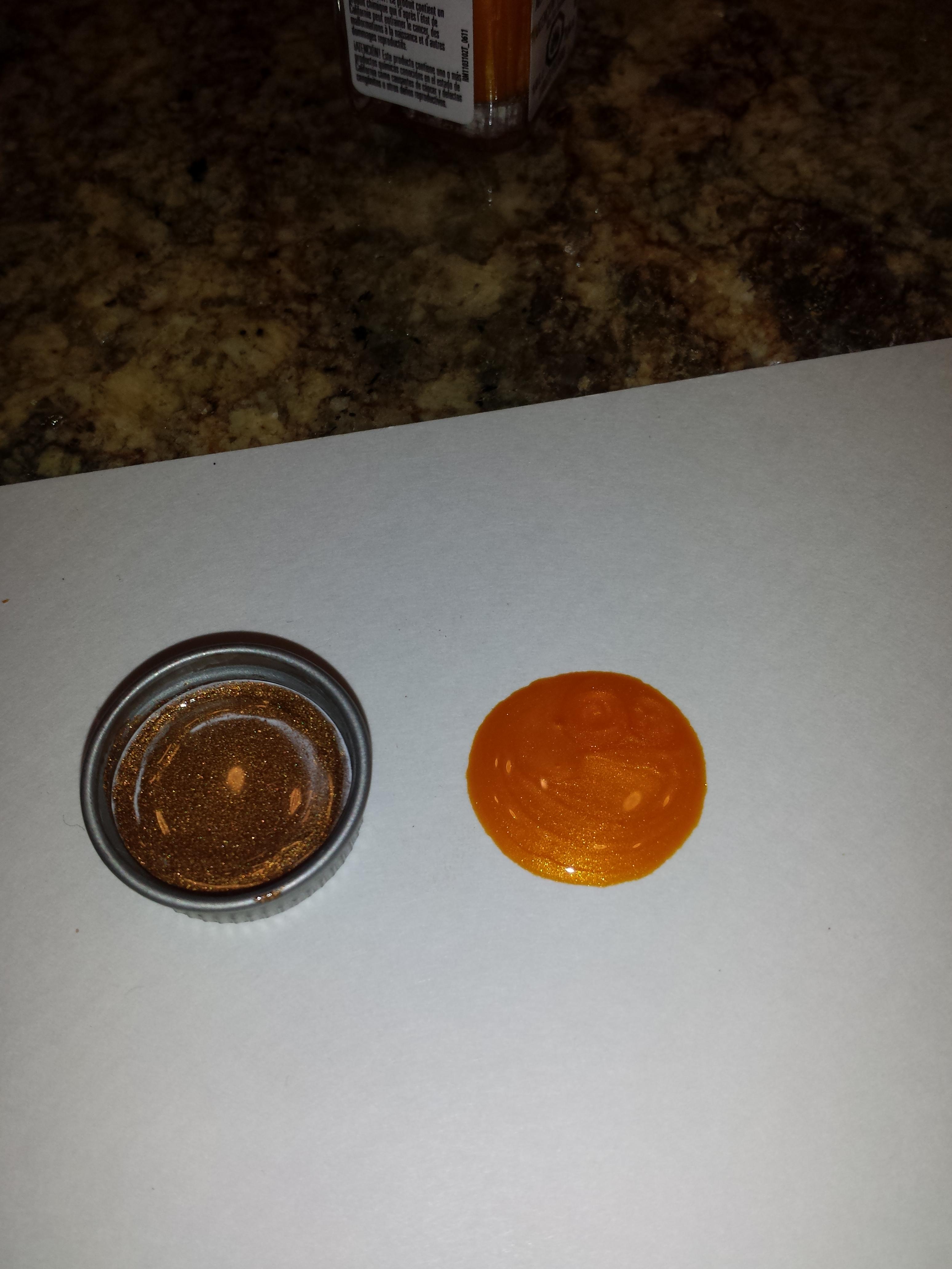

So first you'l open your orange, and mix it all up. Then pour the same size as the lid, or a nickle out on your mixing board like so.
Do the same with the brown, and add ONE DROP. Let one drop fall from its own weight into the orange.
Magic happens and brembo colored paint comes out.

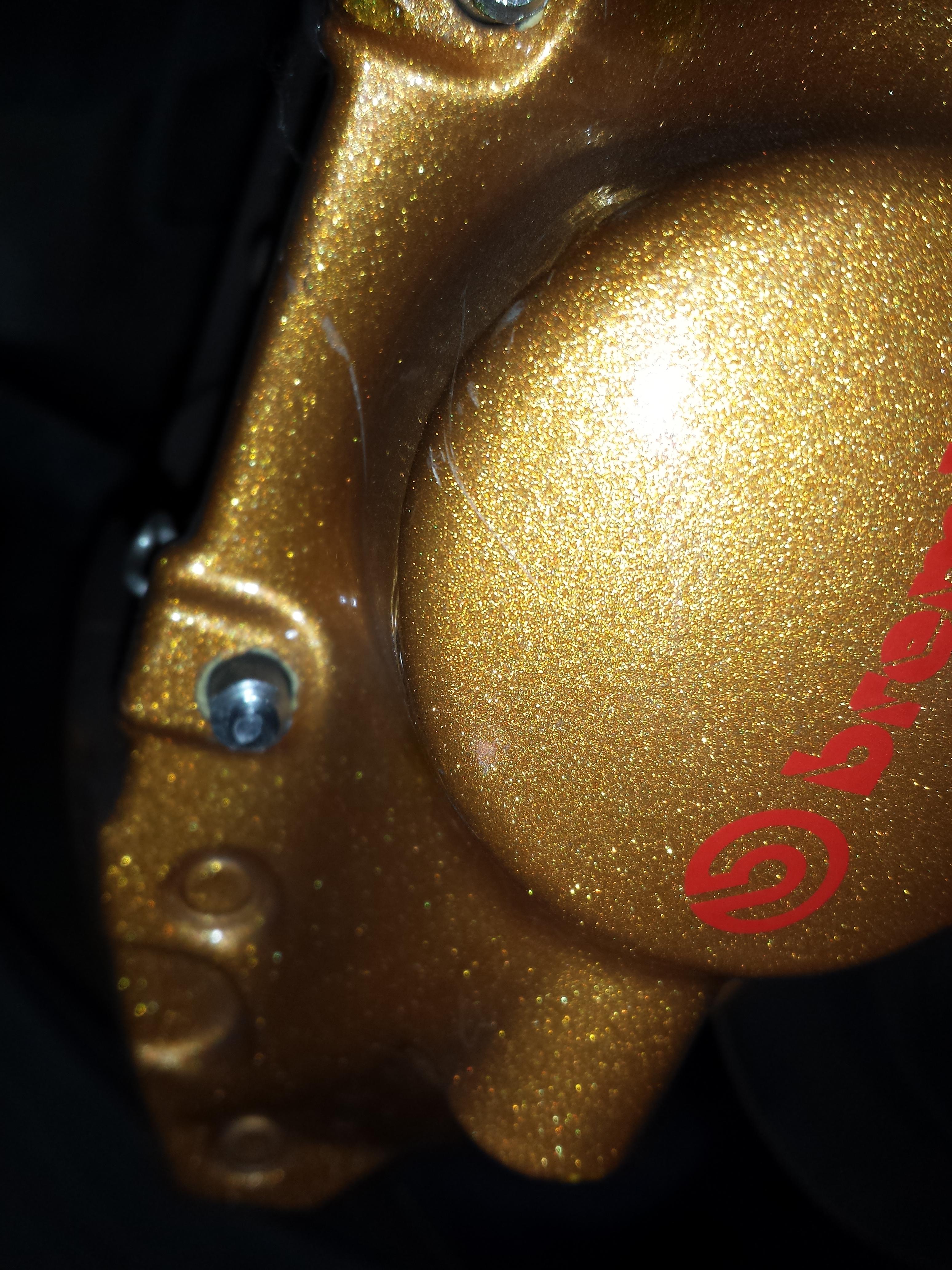

Start small, build your layers up and clean your edges and you'll get the outcome like so.
(white lines are dust, not scratches ;-) )
Now I didn't sand or prep other than just cleaning so you can still see the edges if you get down and look. However, from standing distance you can hardly tell and it looks better than previous knicks and scratches.
