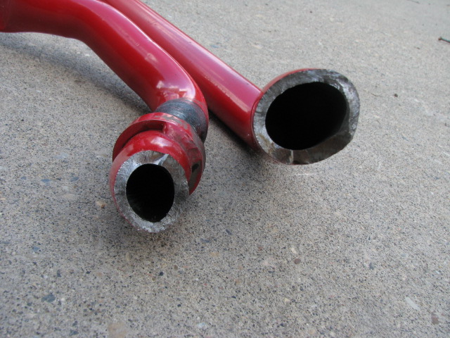

My Front Stillen Sway Bar recently broke.
Installed October, 2005. Started making noise which I thought were the suspension arm bushings last fall or earlier (2009). Lots of noise a couple of weeks ago, and a few week-ends ago, I heard a big noise (sound of it snapping?)
Removed on the W/E (46,000 miles on the sway bars). Looks like it started as a crack last fall since part of the break is starting to rust. Finally let go last W/E.
I’ve never tracked the car, and though I’m an enthusiastic driver, am not overly aggressive. The bars are set on ‘medium’.
Stillen says that their bars are only warranted for 1 year so it’s not covered! I’m pretty disappointed with their response. I probably should have gone with Eibach which Stillen warranties for 1 million miles.
Looks like they have more faith in other manufacturers than their own!
They claim that it must have been caused by hitting potholes or something, but I'm always very careful, and have only had one minor wheel alignment as a maintenance item done since I bought the car even though the car has always tracked true. Anything that would cause the sway bar to break like that would likely have been very noticeable at the time, and would have affected other things in the front end. I believe it was a manufacturing flaw and one of my engineer friends agrees.

Attached Thumbnails Sway Bar Database-img_0174.jpg   Sway Bar Database-img_0175.jpg   Sway Bar Database-img_0172.jpg   Sway Bar Database-img_0173.jpg

Stillen does not offer a 1,000,000 mile warranty, Eibach does. You would still have to buy new ones, and pay for shipping, send yours back, and if they are deemed to be a manufacturing defect, you get your money back. It's not as cut and dry as you make it out to be. Unfortunately this is a drawback to a hollow swaybar - they are more prone to breaking. The Eibach in this case is no different, as it too is hollow. Combine that with roads that see salt in the winter, and they become far more susceptible to failure than a solid bar.

Thanks for the reply Adam. Your offer of only being able to do a reduced price was what was presented to me.
I know that Stillen doesn't offer a 1,000,000 mile warranty, which is the reason that I perhaps should have gone with one that does in the 1st place. Still disappointed in your product and your response however and I have not heard of many sway bars that have broken other than the cheap ones off eBay. Per another member: "I've seen multiple cases of Stillen bars snapping, but never hotchkis". (Click on for link) Even in your own words: "A broken swaybar = a waste of money and a potential safety hazard....the simple fact that something that, by it's very nature, is supposed to be rigid and strong in fact broke, tells you everything that needs to be told".... Not very reassuring that you conspicuously did not mention Stillen not breaking in that post, but did refer to other quality bars that don't break!
And other than in the break itself, there is no evidence of corrosion whatsoever, so salted roads are not likely to be a factor unless there was a fissure pre-existing due to manufacturing problems or quality control issues, the very thing that you refer to as being lacking in bars that are prone to breaking!
