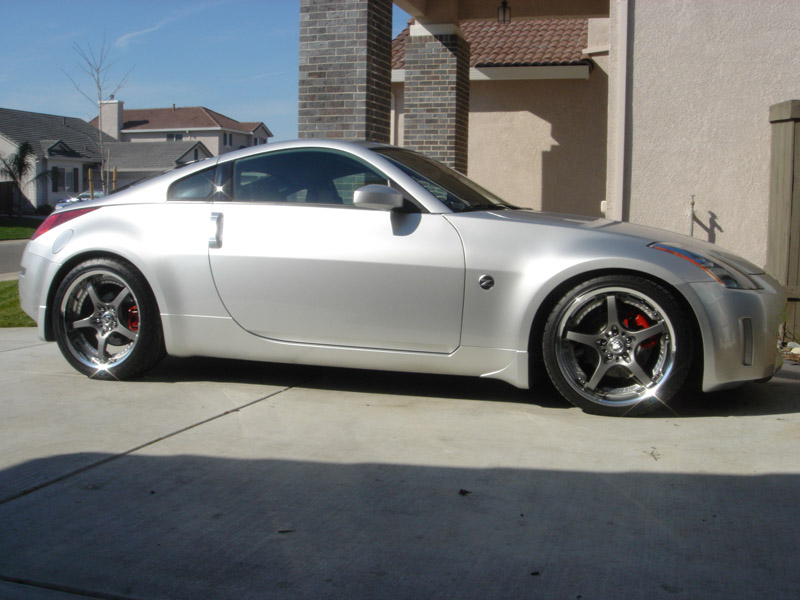

A raked look is a high rear, low front...like an old muscle car. Somehow everyone wants to believe that hotchkis does this, but it does not, at all ... considering the drops are equal F=R (pretty much). I believe the H-Techs do not drop the rear enough and give that raked look

Originally Posted by roncfpz
Excellent info all. It's been very helpful for us newbies. Can anyone explain what a "raked" look is?
Raked look is when the front is lower than the rear. Here is a pic courtesy of someone on this forum that has the Tein Stechs. With the hotchkis you actually get a little lower in the rear and gives it a perfectly strait looking drop. BEN
edit- we are talking a differnce in milimeters here, but for me, I swear I can see the rear higher than the front. BEN
