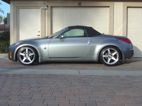

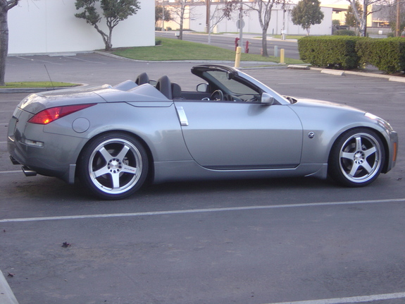

i have the espelir active GT on my ZR as well. mine is definately lowered more than 10mm avg...but i'm happy w/ the ride quality and looks of my car. alignment shows everything is w/in specs except for front camber which is off by -0.3.
Attached Thumbnails Espelir ACTIVE GT springs???-543978_79_full.jpg   Espelir ACTIVE GT springs???-543978_76_full.jpg

Wow are those the ones that state a 10mm drop?maybe they meant 10mm from the ground. Cause that looks pretty low,and extremely sexy .How much did the ride quality change coming from stock to those,and what are the spring rates.

yup, it's suppose to be about 10mm...but it's more like 20mm in the front, 35mm in the rear. maybe it's the added weight of the roadster. it's a bit low for my taste, but it looks nice and i only have problems on really steep driveways. i feel that the ride is as good if not better than stock. u'll have to check their website for spring rate...i have the ESG055.
