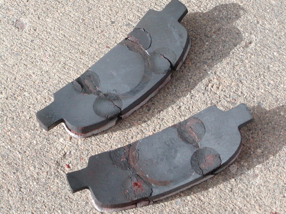

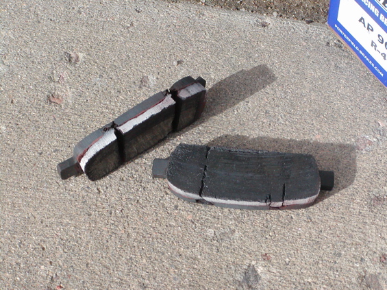

The stock rear brakes are horrible for any heavy track day. I burnt mine at the last SCCA Time Trials competition here. My rear Porterfield R4 pads buckled and broke under the strain. I never experienced any fade, however, but obviously I was near the end of a safe day. Any longer out and I think the pads would have broke and I would have been screwed. I think preventing heat from exiting the pads and entering the caliper is a bad idea, simply because the heat was too much for these race compound pads to handle, so trapping even more heat with that backing plate idea would have meant them disintigrating even earlier. Honestly, the best bet if you're working the brakes this hard is a BBK, but that would push me out of B stock so I haven't done this yet.
