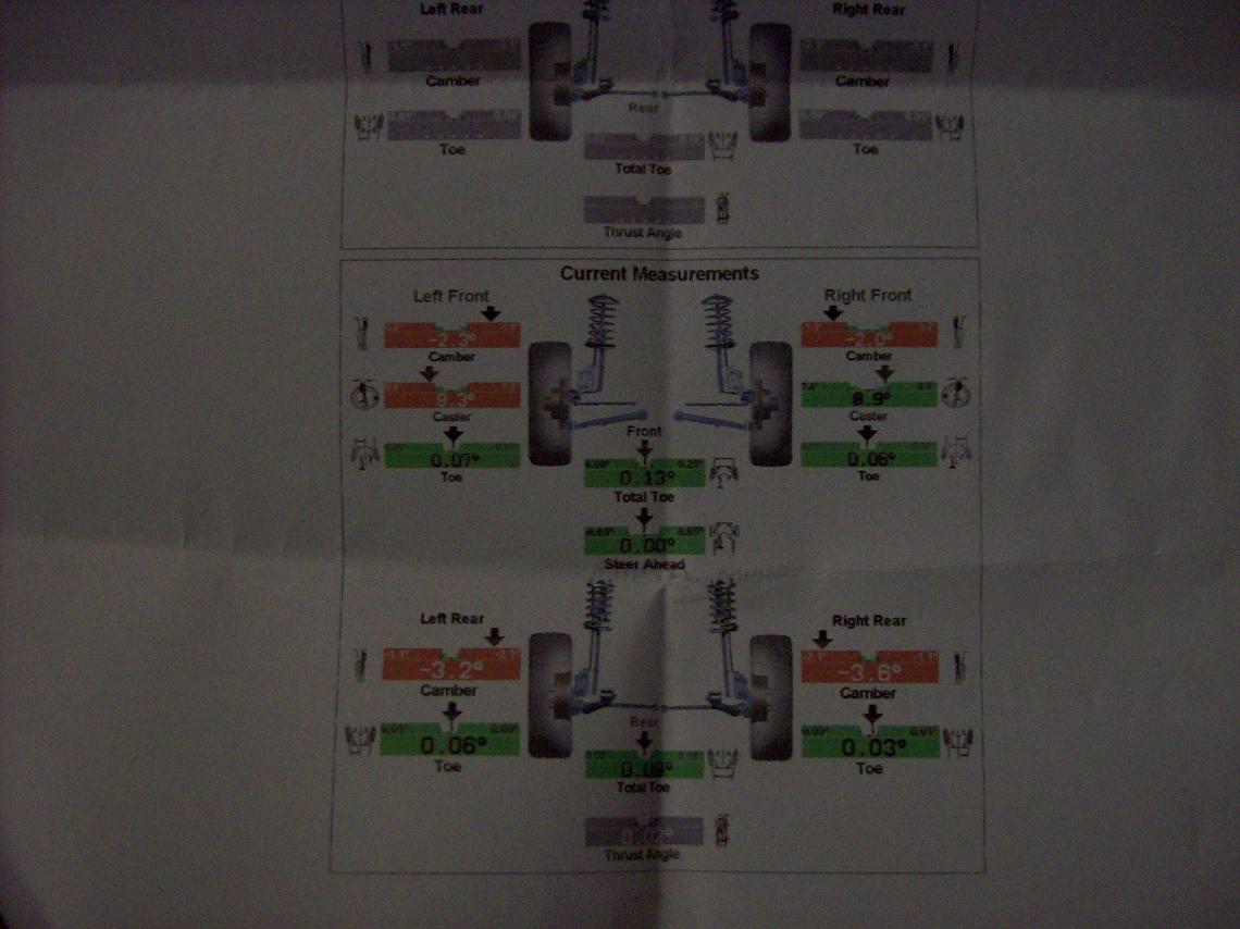

they can get the camber in spec but not without screw up the toe. spc camber arm is enoughf but the spring seat is'nt nearly enoghf. the best , my friend at town fair tire can do, and the nissan dealership is -3.6 camber in the rear anything more and it will screw up the toe. and they both said that the spc cam lobe for the spring seat wouldn't be enoghf adjustment so don't bother unless i can pair it up with something else. if thats wrong then good i'd give it a shot i just don't want to waste my money on something thats not really gonna help. thats why i'm asking about the rear radius rod because if they do really help out than together all three may solve the issue. but i haven't seen any info really about the rear radius rods other than from misleading advertisements. i want to know if anyone acually has experience with these.
p.s. i spoke with tokico friday and they said that the tein edfc fits on the tokico d spec shock and does work but there trying to reprogram the unit to turn more rotations. they said that it only turns about 4.5 rotations when the tokicos need 7.5 turns.there experimenting with it to see if it would be worth producing. im trying to confirm that 4.5 turns is right because then it would work just with limited adjustablity, which i could live with.

I really didn't plan on responding to this thread, but something just strikes me as odd, puzziling I guess.
If your at -3.6 and your claiming that the SPC's adjustment range of +or- 3 degree's won't be enough, just where do you plan to adjust to?

Attached Thumbnails TEIN EDFC with Tokico D-Spec? and negative camber issues?-100_0398-.jpg
