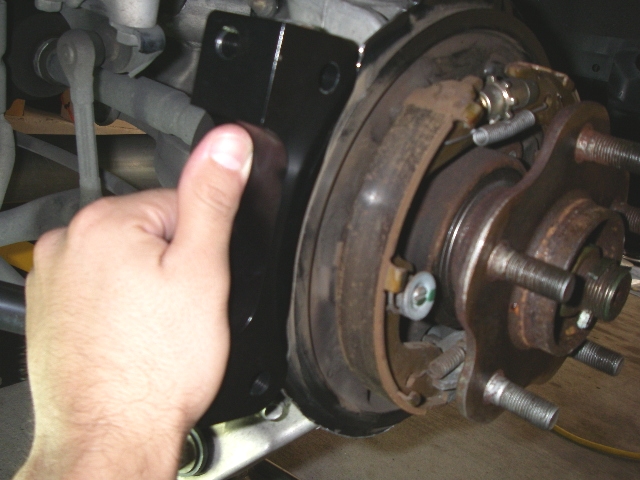

I finally bit the bullet and completed my BBK for the entire car. Up front I'm running 14 inch 4 Pot Stop Techs. For the rear I decided to go with 13 inch 2 Pot. I really wasn't planning on making the purchase until 2008, but couldn't pass on a deal PaulGT2 made me:
https://my350z.com/forum/showthread.php?t=309673
I started early Saturday morning and made sure to take my time. The install went pretty well. There were no real surprises or fittment issues at all.

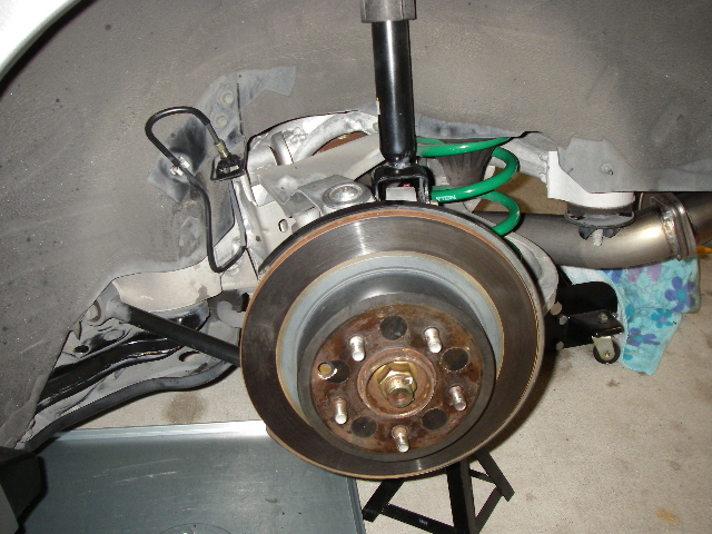

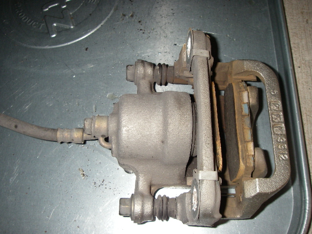

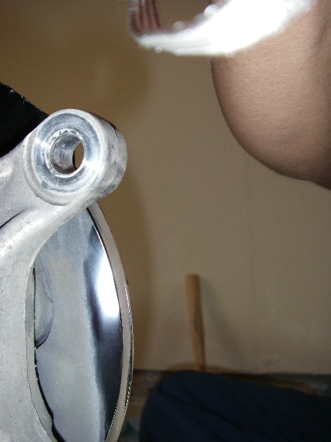

Here's a few pictures of the rear lifted and disassemble process.
Attached Thumbnails Stop Tech Rear BBK. 2 Pot/Cross Drilled. Installed. Lots of Pics....-imgp3202.jpg   Stop Tech Rear BBK. 2 Pot/Cross Drilled. Installed. Lots of Pics....-imgp3199.jpg   Stop Tech Rear BBK. 2 Pot/Cross Drilled. Installed. Lots of Pics....-imgp3200.jpg   Stop Tech Rear BBK. 2 Pot/Cross Drilled. Installed. Lots of Pics....-imgp3201.jpg

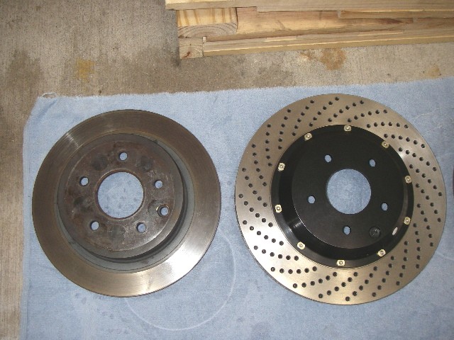

Here's the rear OEM rotor compared to the new one. The new rears are 332 x 28mm...

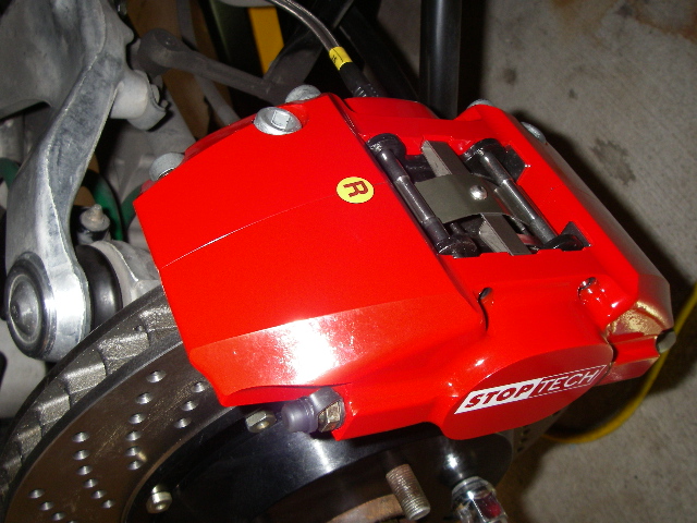

After all the ground work is laid, you can begin installing all the new hardware.
Attached Thumbnails Stop Tech Rear BBK. 2 Pot/Cross Drilled. Installed. Lots of Pics....-imgp3217.jpg   Stop Tech Rear BBK. 2 Pot/Cross Drilled. Installed. Lots of Pics....-imgp3223.jpg   Stop Tech Rear BBK. 2 Pot/Cross Drilled. Installed. Lots of Pics....-imgp3221.jpg   Stop Tech Rear BBK. 2 Pot/Cross Drilled. Installed. Lots of Pics....-imgp3224.jpg   Stop Tech Rear BBK. 2 Pot/Cross Drilled. Installed. Lots of Pics....-imgp3219.jpg

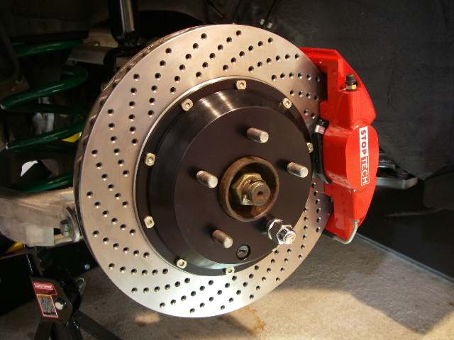

Final pics after wheels were mounted.
Attached Thumbnails Stop Tech Rear BBK. 2 Pot/Cross Drilled. Installed. Lots of Pics....-imgp3227.jpg   Stop Tech Rear BBK. 2 Pot/Cross Drilled. Installed. Lots of Pics....-imgp3226.jpg

Looks nice, but you should have gotten slotted or just blanks since now you will have worse surface area for braking. Meaning, more heat, and more chance of cracking.

I'm thinking Stoptech BBK (or any major name brand BBK) won't crack... It's the oem-size no-name chinese blanks (that get crossed drilled) I'd be worried about...
I agree on slotted rotors being less likely to crack. I have no plans on actually tracking the vehicle. It's all for show.

Actually any crossdrilled rotor will crack. Just depends how much heat Porsche crossdrilled rotors crack. But less surface area the more chance they have to cracking.
