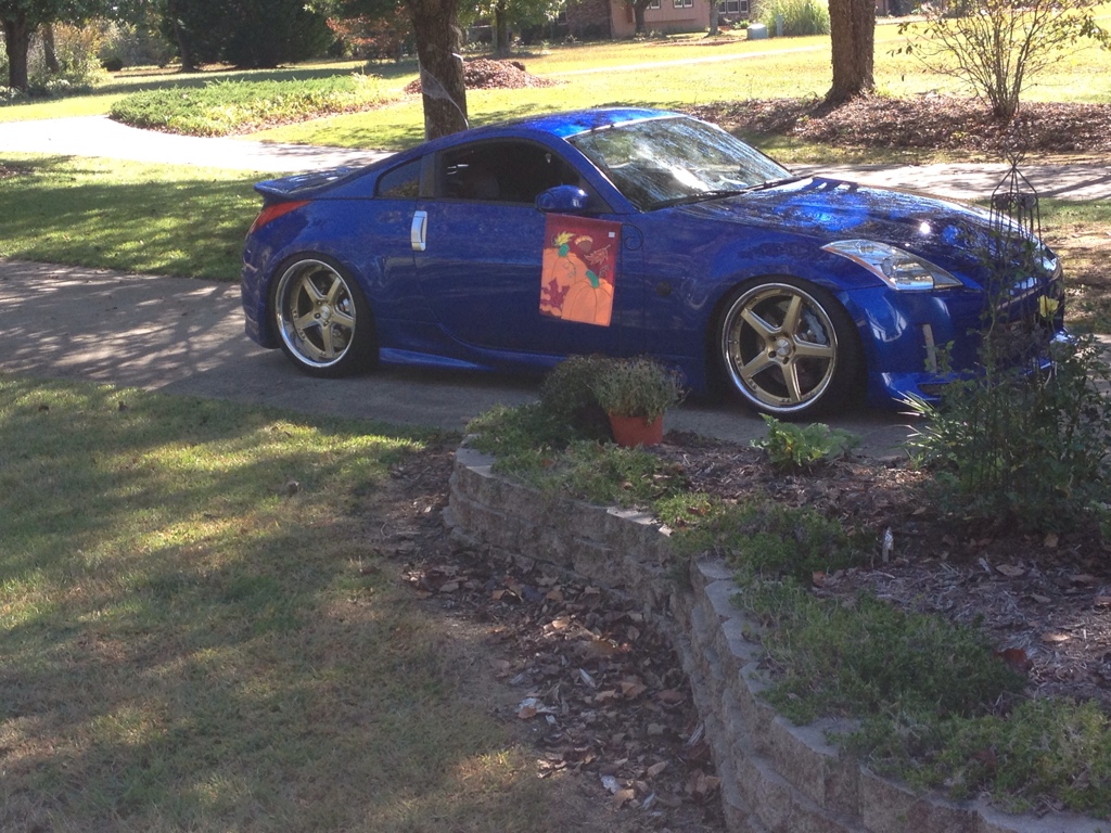

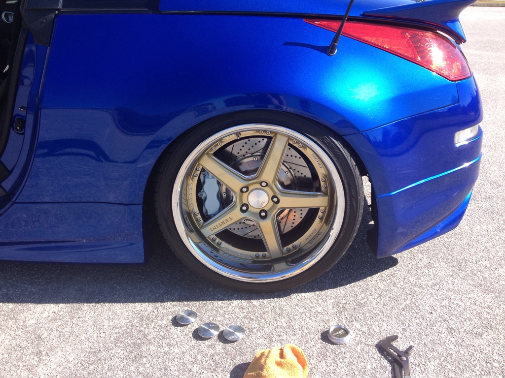

Here's one w some flat center caps. Think it helped the looks of the wheels!!

Taywan, your brake and wheel combo came out perfect.

Preciate it dood!!! I'm loving it!!

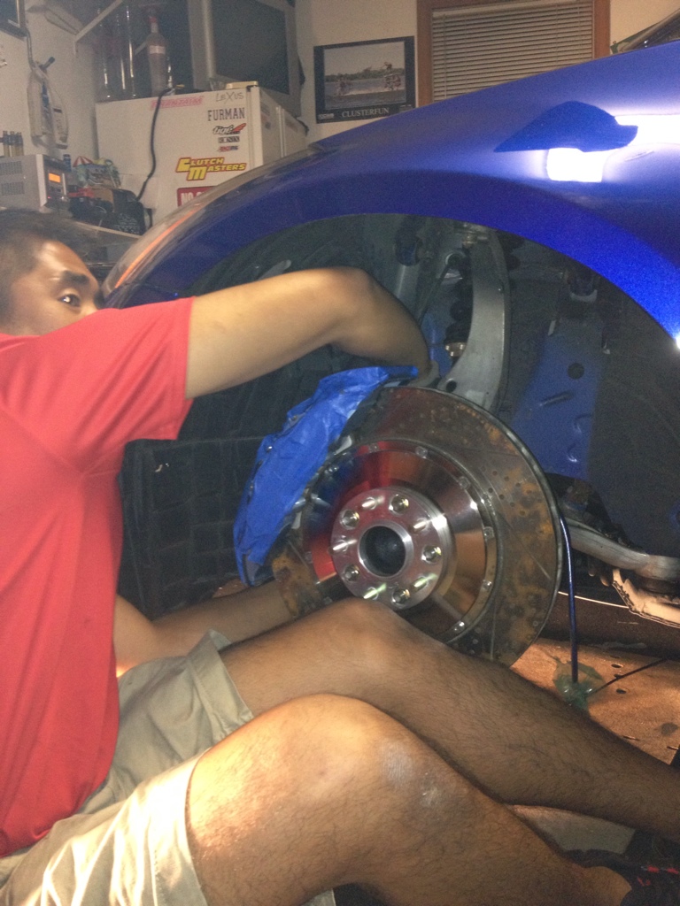

I'm sexy and I know it. Lol

wat you changing on the brakes? didnt you just install em?

check your rotors bro, theyre backwards.
Vanes should point to the front/caliper. At least that is typical of most other slanted vaned rotors.
http://acurazine.com/forums/showthread.php?t=807586 See how these are labeled l/r

stoptech reference shows the cutaway. Pg 13. See if your vanes look right.
http://stoptech.com/docs/installatio...98-646-1450-02

he is correct the rotors are on the wrong side

Got it. That pic was kinda old when 1st installed. Friend just sent me a bunch of pics. And I will be working on swapping them over prob tues. I need to bleed just a tiny more anyways so it makes me finish the deal!! Thanks a lot guys. Seriously.
