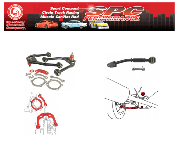

hey twitch579...
you need rear camber arms and toe bolt...
i've got an SPC rear camber arms and toe bolts kit if you need it.
i bought it but realized that i do not need it. let me know if you are interested.
Attached Thumbnails Will these work for my negative camber in the rear?-spc.jpg

Yes, providing that Tirerack also has this Eibach kit to sell to you as well.
It's part number 5.72055k, it's pair of elongated toe cam bolts for the rear. When you dial out more negitive camber in the rear, it takes away toe, you need something that can adjust more toe then oem.
Eibach alignment parts are made by SPC btw.

Originally Posted by mzdfc3s
why would you pay $405 for two bolts and some washers???? i wish i would have invented that!
It's $199 for the rear arms as well as the toe bolts. =)
