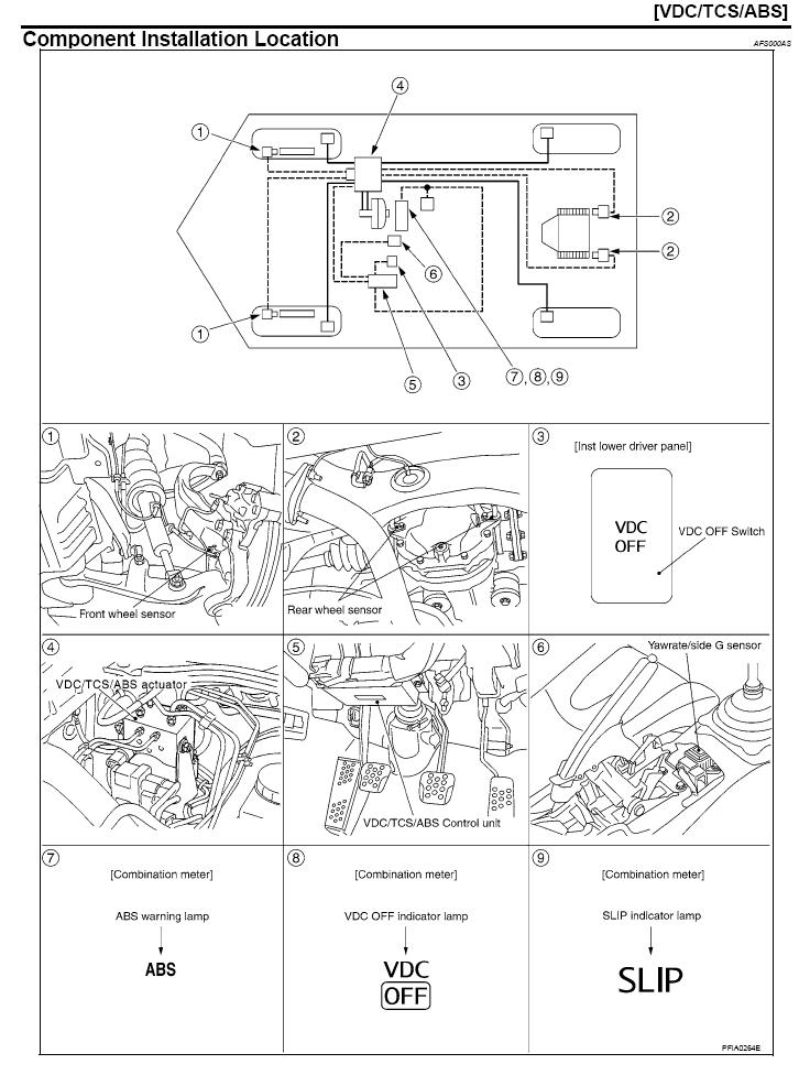

If ALL the lights are on, then it might have something to do with the ABS control unit. check the connection near your brake fluid box, and the connector leading directly into the aluminum block that all the brake lines are feeding into.. your recent brake fluid flush, hopefully did not damage and of the wiring (brake fluid eating through the rubber coating) of the ABS control unit.
another check is to see if the sensor on the axels are still where there are supposed to be, you might have somehow knocked them off with going off track or hitting something that bounced back up..
also here is a line from BRC-97 on the warning lights.
"ABS, EBD SYSTEM
In case of electrical problems with the ABS, the ABS warning lamp, VDC OFF indicator lamp and SLIP indicator lamp will turn on. In case of electrical problem with the EBD, Brake (EBD) warning lamp, ABS warning nlamp, VDC OFF indicator lamp and SLIP indicator lamp will turn on. Simultaneously, the VDC/ TCS/ABS become one of the following conditions of the Fail-Safe function.
1. For ABS trouble, only the EBD is activated and the condition of the vehicle is the same condition of vehicles without TCS/ABS equipment.
2. For EBD trouble, the EBD and ABS become inoperative, and the condition of the vehicle is the same asthe condition of vehicles without TCS/ABS, EBD equipment"
see attached, this will tell you where all the sensors for the ABS/TCS/VDC system are..
just to clarify, those pictures you attached are for a Right hand drive spec 350Z...
-J
-J
HA. i guess ur right.. that came right out of my 03 manual..
looks like nissan flipped the image..
