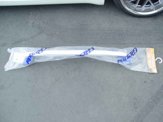

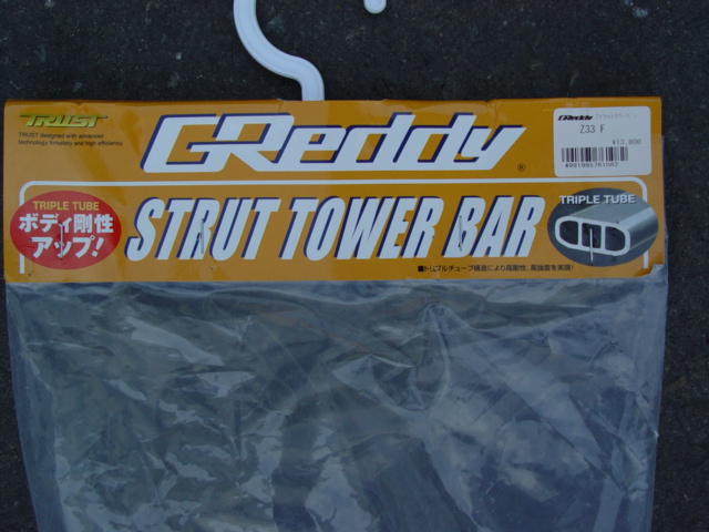

got this greddy/trust front strut bar for my car today.
way lighter than stock bar.
i like it a lot. it's not totally hollow, but definitely better than stock solid.

pic 2

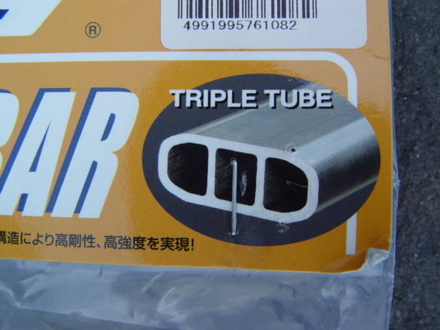

pic 3
not totally hollow, but definitely beats the solid stock strut bar

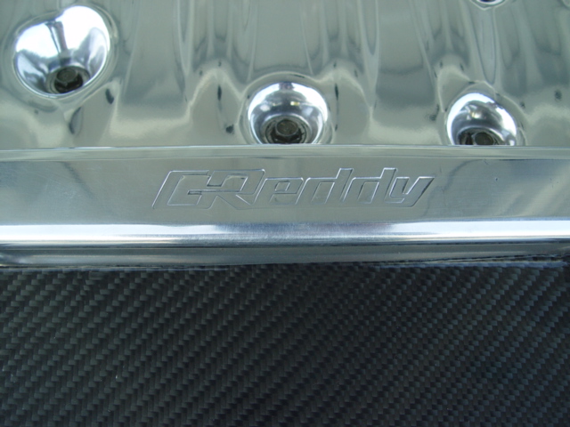

pic 4

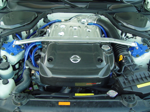

final pic: finished product

Looks great I was considering them too. Would look great if you got the Greddy TT kit for it too.

Just an FYI - that is vastly inferior bar to the one the Z comes with, though admittedly it looks nicer!
See at the end where there is the large bolt connecting the bracket and brace? That acts a pivot under load (especially when one wheel or side of the car is under suspension compression, and the other is unloaded, like in a turn). The stock bar is a great design in that its solid, and they achieve adjustment by threading the bar into and out of the bracket, rather than bolting it.....very surprising to me for a stock car, but am very happy they did it!

looks great but a crawford plenum isn't going to fit under there if you ever decide to get one.
