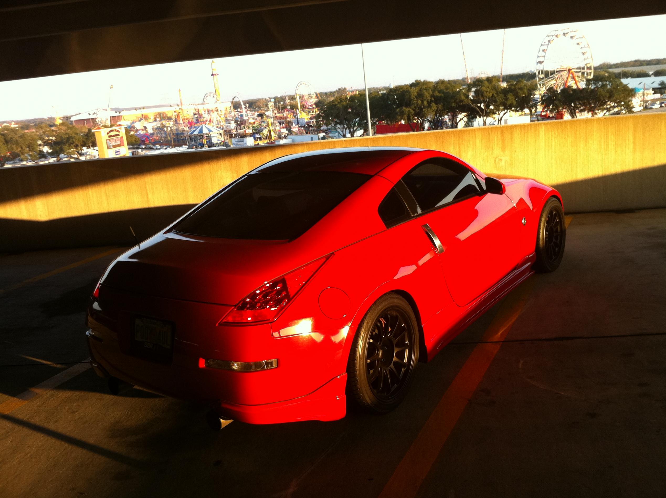

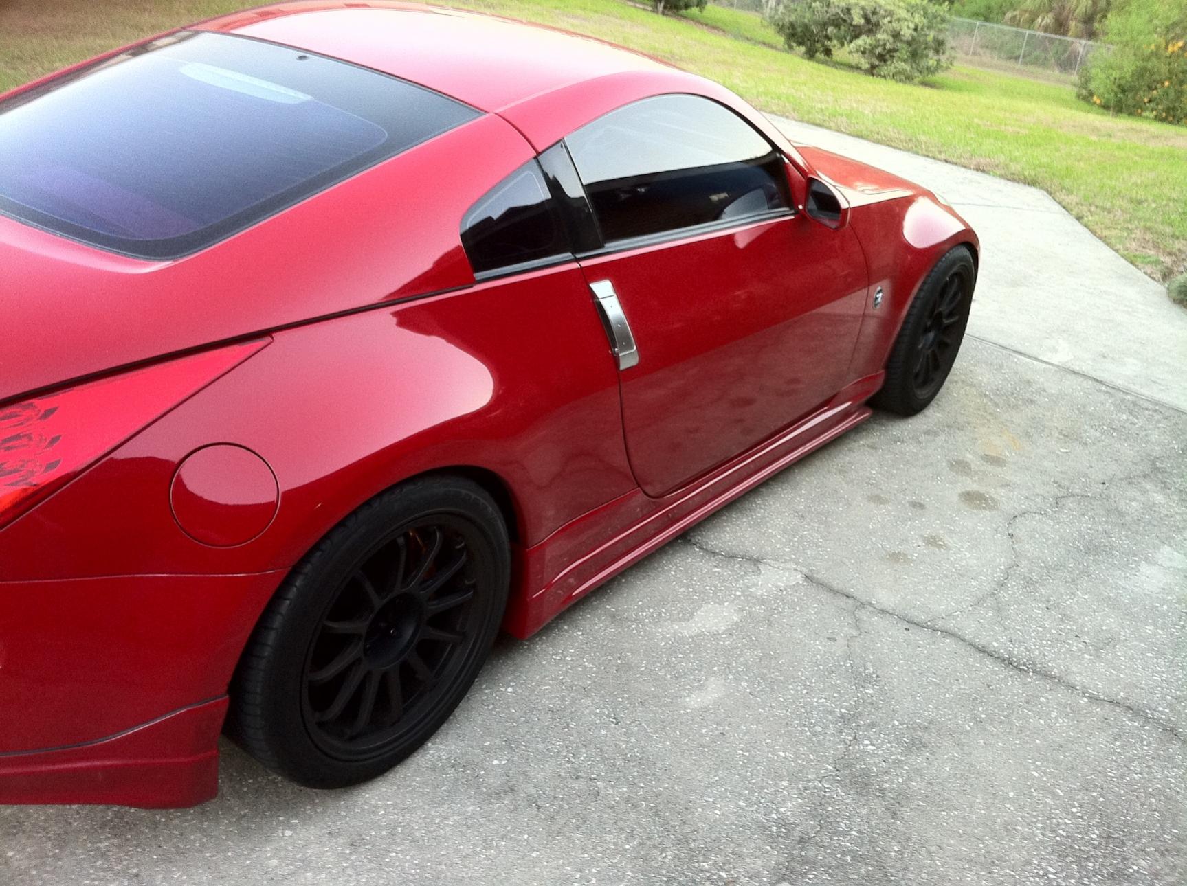

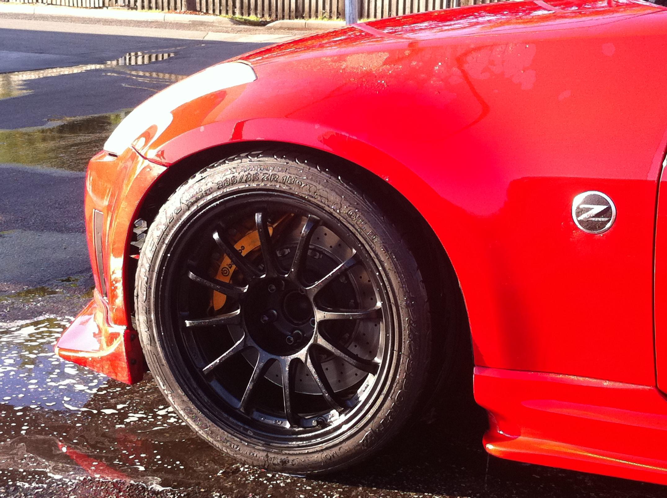

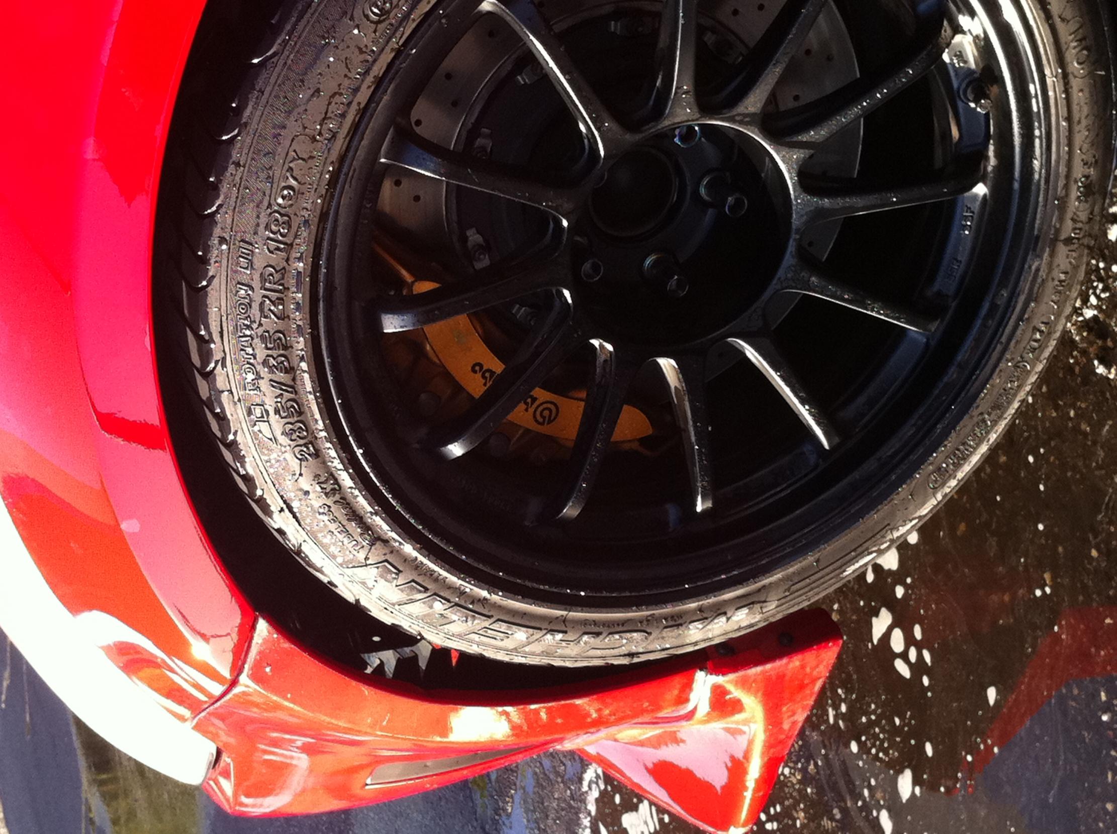

Here are some fresh shots from the last few months. Iphone4 winners.

Holly swirls! Time to get a paint correction, Lowell.
WAX HER UP!

i see brakes this time! never get tired of seeing them.

I'm guessing you're track oriented but some 19's would do a lot more in showing those pretty brakes off.

Yeah, I'm planning to get a set of 18" RFP1 wheels as well. Tires for 19's are ridiculous.

Was warned by kwame that rpf-1/s have limited brake clearance.
I'd make sure you test fit over your new blueski's first. gtc-01 seems more
bbk friendly design wise, and almost everyone in jland was running it on their
track cars over the last year...

Sorry, didnt read the whole thread so I dont know if the rotor diameter you're using is mentioned, but my 6 piston AP kit with 14.25" rotors will not clear on 18" RPF1's. Sad, cause I really wanted to use them. Inner barrel diameter is just not big enough. Anyway, it that may or may not help you because the caliper sizes are different between the AP's and the R35 Brembo's, but judging by the pictures alone, I feel pretty confident saying RPF1's would not clear.

my rotors alone are 15" all around. calipers are... well............
this does coincide w kwame's warning... always liked rpf's, but now prefer gtc's
