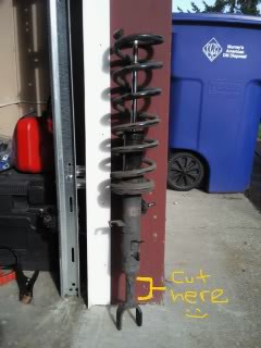

Eibach sportlines. haha with a little fabrication to make it sit lower bc i dont have the money for coilovers haha....ill explain.
rear - i cut right betwenn 1/2 and 1/4 of first coil on the bottom of the springs. it still has a dead coil...like the bottom of the spring is still flat againt the control arm. and i cut the rear springmount cone thing. maybe a 1/4 of an inch left of it. rides awesome, no noises or anything. i know my stock struts have about had it bc of this but oh well....im low
front - there is about a 3 1/2 inch piece of sold steel from the shock to the mount. i sectioned about 2 inches out of this. i cut it and before i welded the pieces back together i put a piece of 3/4 inch round and 3/4 inch long steel ring around one side. then welded the 2 pieces back together then slide the ring over the weld and weld the ring to the steel to give it strength. its strong as hell. i have been driving on this for about 3-4000 miles now and i checked it my last oil change whch was the other day and its perfect. not a single crack or bend or anything. its strong as hell and rides smooth.

im sure some people are gonna hate on this and say whatever they have to say but i dont care if you think its dangerous or a bad idea. its holding up just fine and i drive memphis streets every day and they suck ***. i hit huge bumps and drive my car hard sometimes and everything holds up fine. this would be dangerous if you were not a skilled welder and didnt take your time. but everything on the front was lined back up PERFECTLY and welded back and is strong as stock.....

I just saw what the member above did and damn that's creative

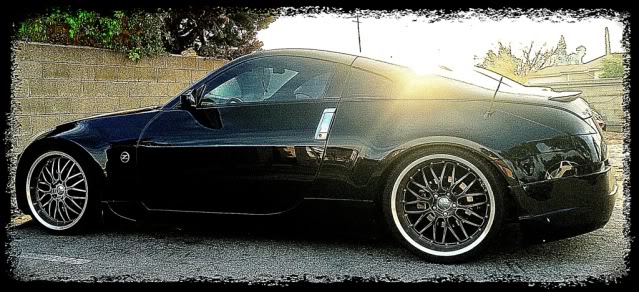

Here's a pic of my sportlines settled in
Got bored and started playing with photoshop on my phone...
I still want coils

what's ur camber settings all around?
my rear seems a bit lower...then again...i never corrected the negative camber. all i got fixed was the toe...and thats all in spec.

My camber is at -1 or lower I believe , I honestly forgot
