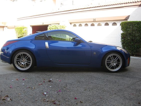

Alrighty, here's my set up:
Eibach Pro-Kit Springs
Tokico D-Spec Shocks
SPC Rear Camber/Toe Kit
Enkei RPF1 - Fr: 19x9 +18 w/245/35/19, Rr: 19x10 +22 w/275/35/19
Stock suspension to give an idea of where my Z started at:
Measurements (wheel center-ish to fender):
Passenger Front - 16-7/8"
Passenger Rear - 18"
Driver Front - 16-5/8"
Driver Rear - 17-3/4"
After (pics outside of garage are on uneven ground):
Measurement (wheel center-ish to fender):
Passenger Front - 16-1/4" (5/8" drop)
Passenger Rear - 16-7/8" (1-1/8" drop)
Driver Front - 16" (5/8" drop)
Driver Rear - 16-5/8" (1-1/8" drop)
Decently consistent drops front and rear. Will be measuring about 1x per week over the next two months to observe "settling", if any.
I suspect the height differences between driver vs. passenger sides might be due to the manufacturing tolerances of the sheet metal.
Alignment Specs:
Left Front..........................Right Front
-1.43°..........Camber.........-1.66°
7.76°...........Caster............7.51°
0.04°.............Toe..............0.03°
Left Rear..........................Right Rear
-1.60°..........Camber.........-1.62°
0.10°...........Caster............0.10°
Not as aggressive nor as low as some on these forums, but my Z is my DD and I needed it to be street friendly.
Just a special thanks to Steve and Nima at Corner3 Garage for their excellent work installing and helpful advising on selecting my set up.

^^^ it can't be 16-16 5/8. I just measured mine and F are 13 1/4 and R are 14.
My set up:
eibach pro kit
eibach rear camber/toe kit
stock shocks
advan rs 18x10+25 all corners

I said about wheel center-ish. I measured from the edge of the bowl that all the lug nuts go into on the rims because that diameter is not going to change before/after the drop.
