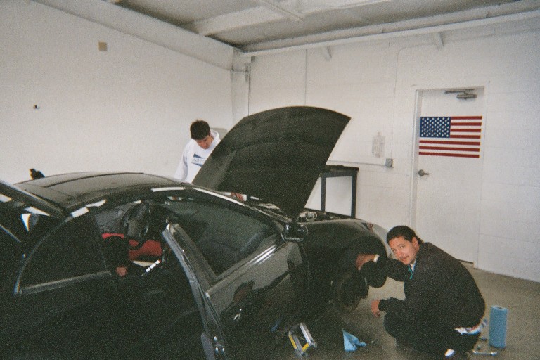

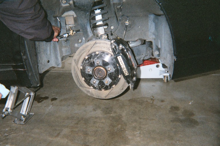

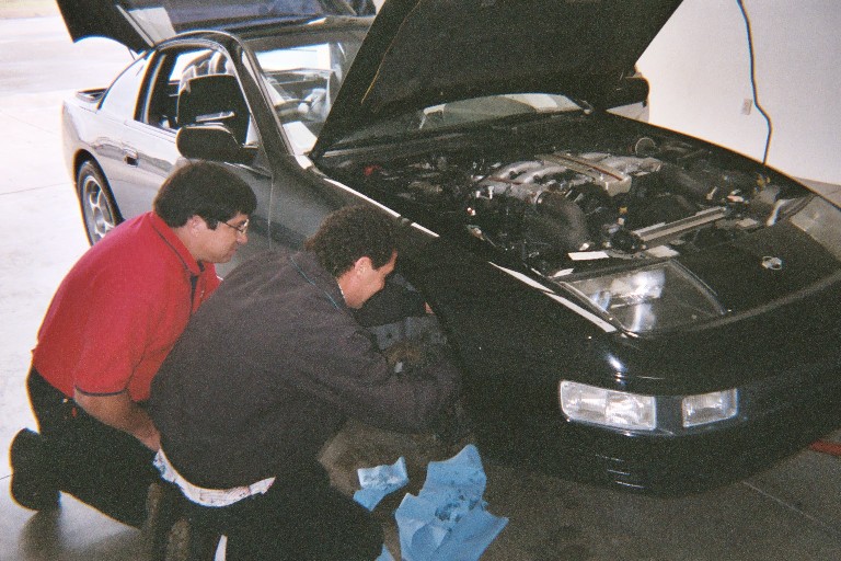

The scary thing is that you are still on street tires, so you are putting a lot less demand on your brakes compared to one day when you put on a set of NT01s, Hoosiers, or the like.
My StopTech BBK for my Z32 was the second installed on a Z32 and the first track tested. Here we are at Buttonwillow in 2003. The guy with the red Izod is StopTech's co-founder and engineering-now-general manager, Steve Ruiz. At the time, I was working with Matt at StopTech as my technician, but Steve wanted to oversee the testing and the instrumentation directly to monitor knockback. Those were some good times!
Attached Thumbnails BBK Advice-scotts94z32stinstrumentation.jpg   BBK Advice-scotts94z32stinstrumentationgregrob.jpg   BBK Advice-scotts94z32stinstrumentationgregruiz.jpg
