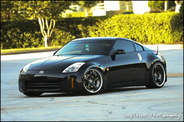

this is how low Iam
Attached Thumbnails SPL V2 Front Arm Help!!-dsc03550.jpg   SPL V2 Front Arm Help!!-img_1939.jpg

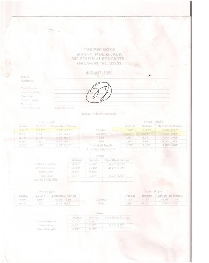

Old Dec 16, 2009 | 08:20 AM
labelworkshop75's Avatar
labelworkshop75
Posts: 739
From: Orlando
these were my specs after alignment. Contacted SPL today and they are going to repair the arms. Thanks
wow that image is really bad. sry
