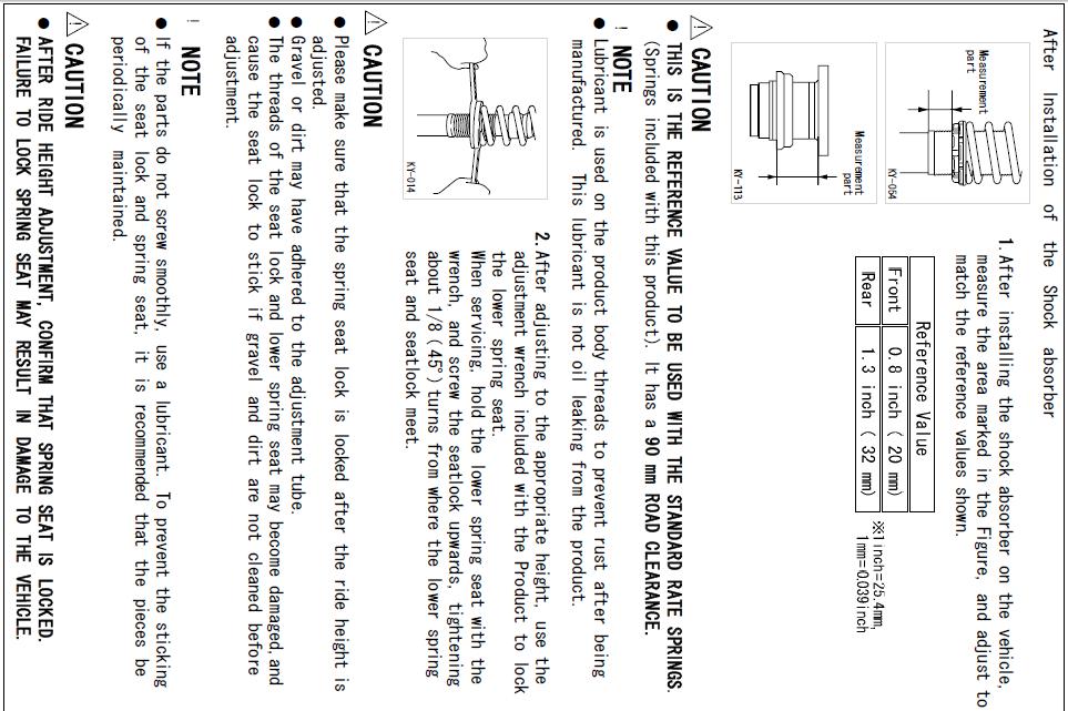

in order to adjust the height, do all coilovers follows the way you are discribing!!!
Yes when it comes to the 350z aftermarket coilovers out there......nearly everyone i have seen................all monotube styles......look at the pics of them on threads......on websites......when you look at the actual ones for the Z, you can see that the bottom fork needs to be turned to adjust height.....
its a process i know, takes time.........but gotta pay to play........it is what it is...

I tested them AFTER I adjusted them. I returned the preload back to stock (how they came) lowered the ride height using the bottom collar and spinning the bottom shock mount. I took it out for a ride and it was very rough, bumpy and noisy. Doesnt sound normal and got progressively worse.

Indeed, i know what you mean, but that not what i understood form the Tein Manual, i don't mean anything, its just that i want to be sure that i'm doing it right if all guys here are lowering there cars by the same method you've discribed then it seem that i'm doing it wrong, at the same time i don't have any problems,,, any ways here is an attached image of me tein super street manual, maybe i understood it wrongly
Attached Thumbnails Installed coilovers, now popping noise from the front.-tein-super-street.jpg

No, they don't all adjust the same way. Some coilovers are 2 way height adjustable, and then Jason's post is correct. Other coilovers are 1 way height adjustable, and only adjust via the spring. It simply depends on the configuration of the coilover

I remember reading the BC Coilovers manual it clearly tells you not to adjust height from where OP adjusted it.

Not enough preload on the springs. I did about 7mm and it rides good. Some of the clunking was probably due to the strut bar also. Some of the bolts were loose when I was taking it off.

Everything is fixed. There wasnt enough preload on the springs which caused the rough ride and noises. I used 7mm preload and it rides good. I also think my strut bar was loose which could of caused some noises. Thanks Jason for all your help
awesome, glad your all fixed up.....7mm is about what i have on preload on my coilovers as well......i made sure to give it some preload and adjusted from there after tracking the car/tweaking, etc.....
there ya go.....then the tein must be 2 way........both how i explain - by turning the lower shock body and a combo of spring perch adjustment.....be easy on the spring perch adjustment though.....i would do the bulk of height adjustment from the lower shock body and ensure you have decent preload on the spring and that its not loose like what the op experienced and then from there decide/adjust/tweak, etc.......and get the spring preload to your liking.....
follow the directions and ensure your doing it the right way and you should be good.....
-J
