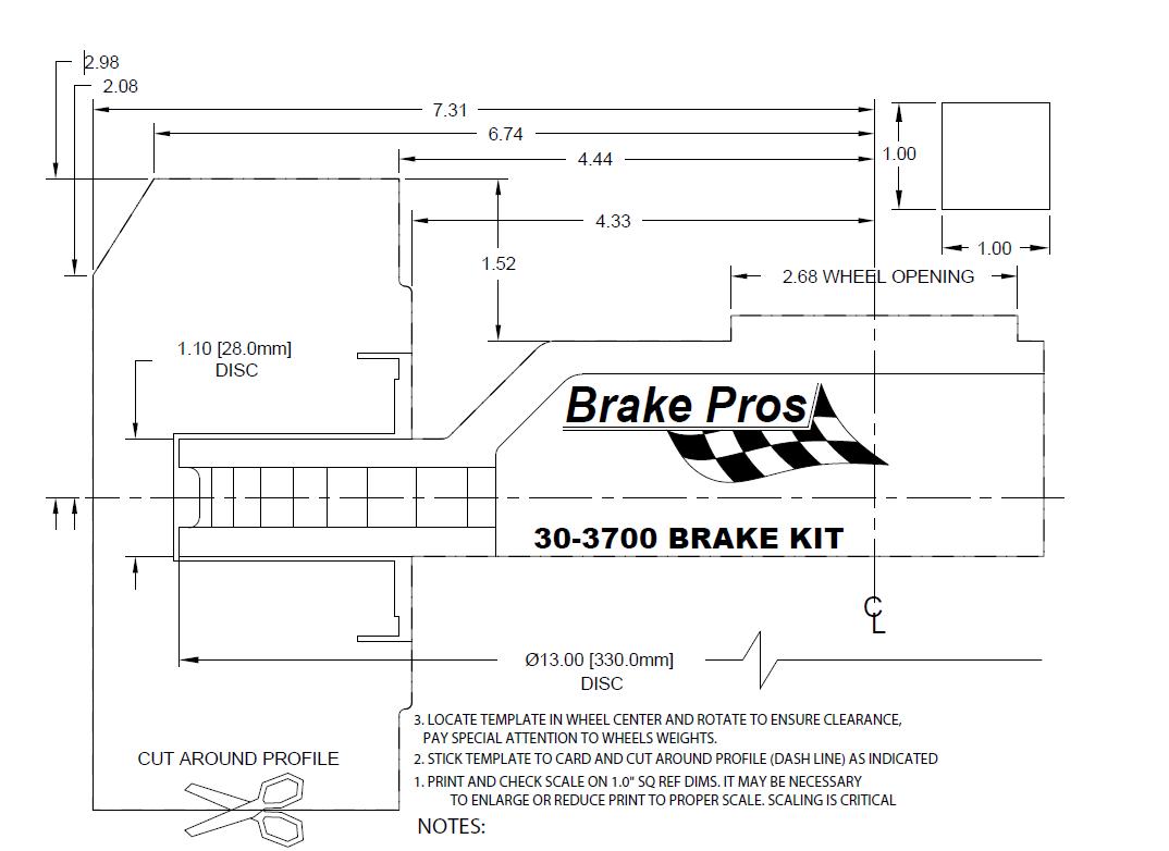

I got the ap racing front bbk(4pot, 1 piece). now ap/stillen/racing brakes is looking for 450+ for replacement rotors. acording to some research the rotors are 330mm x 28mm? one place said they were standard brembo sized rotors which im pretty sure is wrong and wanted to check. anyone know of a aftermarket rotor that will fit.

If I'm not mistaken the standard Brembo rotors are 324x30mm. Stop tech makes a 2 peice rotor that comes a little closer, 328x28.

you have to remember that the BBK may use a different offsets on their hubs to fit the caliper since BBK calipers arent the same specs and may not line up in the same place as OEM calipers

Really good point considering AP seems to stand out away from the crowd in their sizing.

Our AeroRotor data sheet is available at this link:
http://www.stoptech.com/products/img...rDataSheet.pdf
You can check that to see if anything we have will match up.
