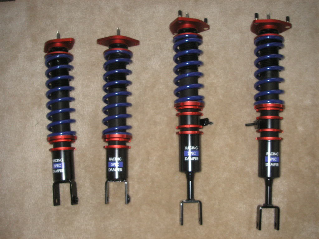

Well I just got a set of Buddy Club Racing Spec coilovers, and i need help adjusting the ride height.
Here's a pic:
I'm trying to adjust the FRONT coilovers (the one's on the right in the pic above ^)...
I've been told several different things....So HOW do I lower the ride height, without messing with the dampening??

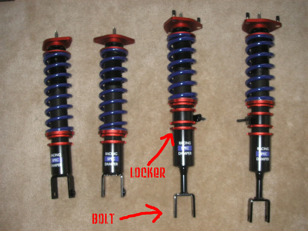

loosen lowest locker then rotate entire shaft until desired height.
Helps if you remove bottom bolt when adjusting height.
thanks a lot!!!!

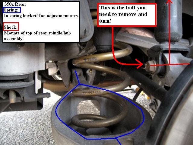

Yes, you need to remove the bolt at that lug end of the coilovers for both front and back - from the:
FRONT:
Lower control arm (translink) and spin the entire lower coilover body.
REAR:
Rear knuckle and spin the entire lower coilover body.
I have found it best to remove the cotter pin and nut from the spindle/knuckle to the upper control arm and have someone push down on the entire spindle/knuckle assembly while you turn the lower shock body when the buddy club lower lug is free from the lower control arm............when done, then reattach.
thats two bolts total you remove....

Yes, these coilovers eliminate the need for a rear spring in the rear spring bucket location, thus allowing you to remove the crappy SPC toe bolts for toe degree's of adjustment and you can replace with an adjustable toe arm......shown in this first pic is the battle version toe arms....
-J
Attached Thumbnails I NEED HELP! (Adjusting Buddy Club Racing Spec ride heigh)-delete.jpg   I NEED HELP! (Adjusting Buddy Club Racing Spec ride heigh)-installed1.jpg

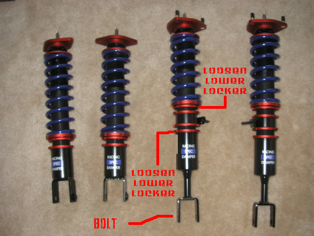

I also found it easier to adjust the height when the lower locker, for the spring mount, is loosened.
Makes sense to disengage the A Arm. Itll allow more play so one can easily rotate the lower portion of the coilover. Wish I had thought of that earlier
Attached Thumbnails I NEED HELP! (Adjusting Buddy Club Racing Spec ride heigh)-12345.jpg
