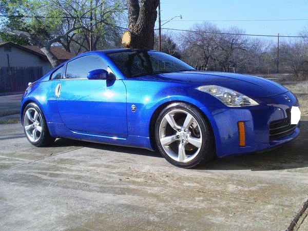

if i can find one later tonight i'll load one up.
Old Jun 7, 2010 | 05:44 PM
nismospec's Avatar
nismospec
Posts: 152
there ya go.....
