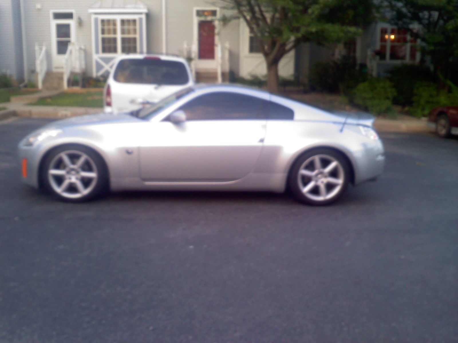

Well I got it done today using Cux350z's method which was much easier than the other way I was trying and we didn't need to compress the spring on the car that way which was nice. I put on Hotchkis springs that I bought used off a member here so they are already broken in and dropped it more than I thought which is cool.
Here is a quick blurry cell pic for you guys. I Guess the lens was dirty. I'm going to take some real shots after I get my spacers Tuesday (20mm F 25mm R).
