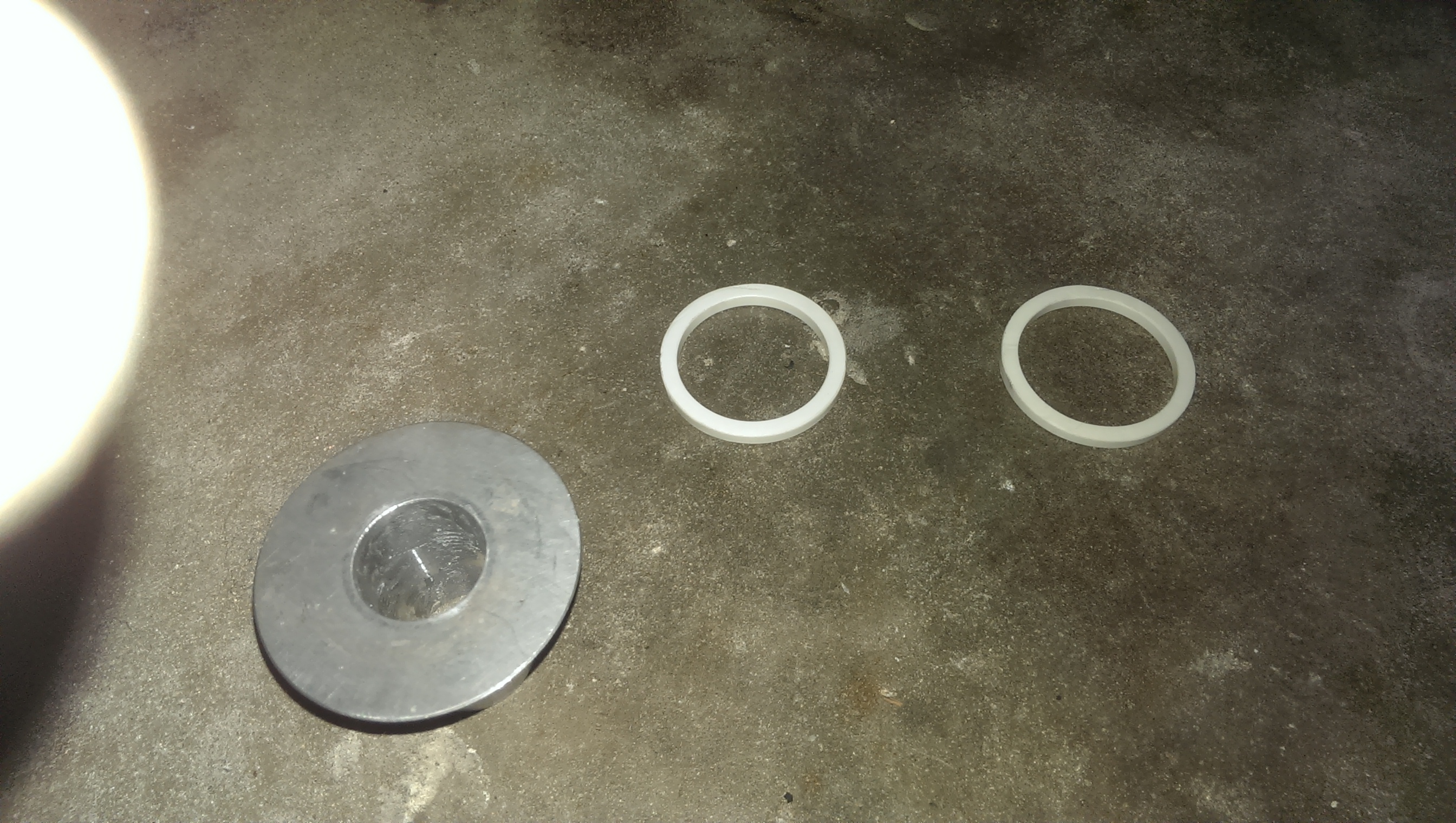

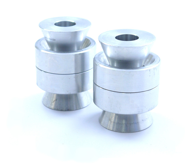

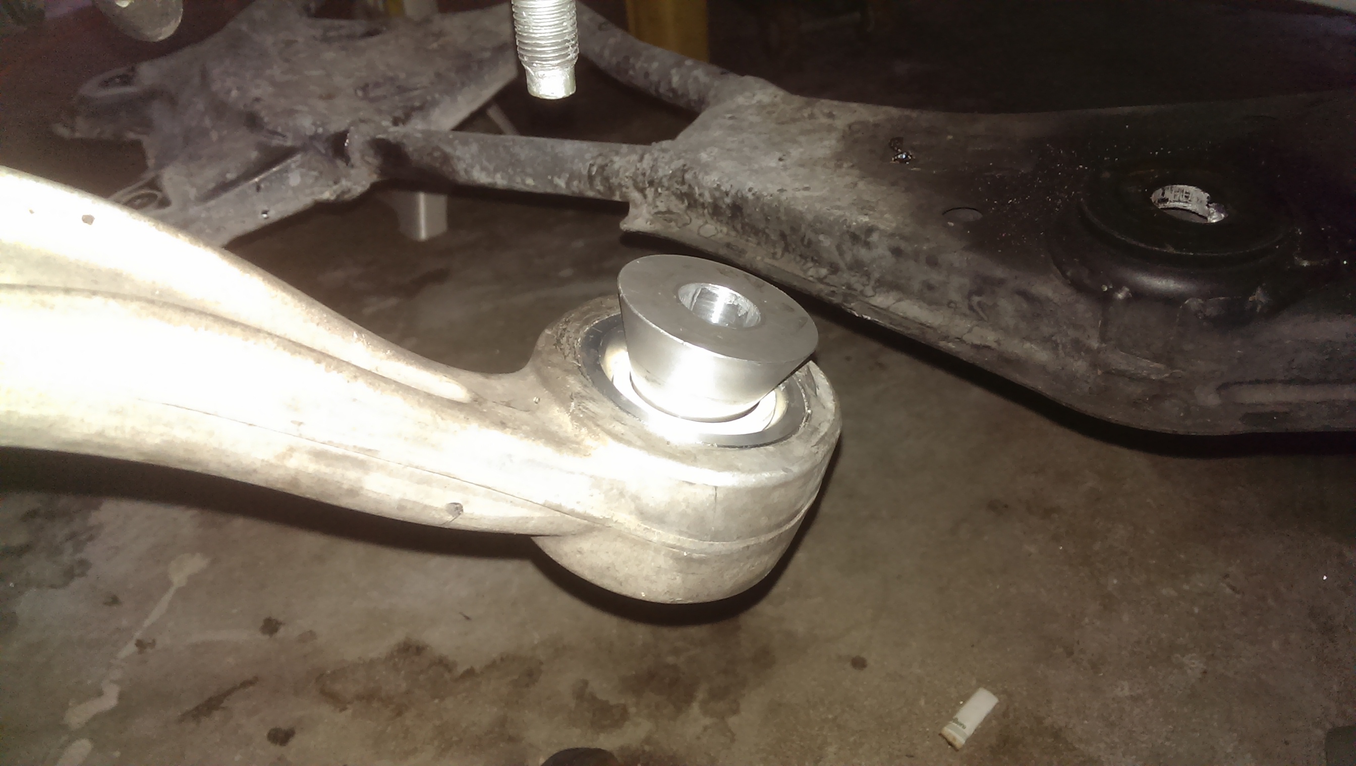

Hello my fellow my350z.com'ers. I have found the ISSUE AND SOLUTION to the
clunking rattling sound. It is the SPL compression rod bushing cones hitting
the upper most part of the pressed in part of the bushing.
What I did to fix this was use schedule 40 PVC coupler for 1 inch pipe.
It is nearly a perfect fit to sit just above the heim joint and stop the cone
from moving and hitting to cause the banging sounds we are all
complaining about.
I wanna say I cut them about 1/4 in thick. The best way to do it is cut a few
pieces and then grind the cut area nice n smooth. After that I used sand
paper to smooth out all rough edges from grinding and cuts. My next thing
Im gonna do because I didn't have time before is to place some bearing
grease on the PVC so it will glide smoother in the tight area it sits in.
Also it is best if you can have the car on a lift or ramps so the wheels have
all weight on them so removal and installation of the front cross bar assy.
brace bar is easier. Also manipulate the arm back and forth if you need to
so the PVC O-rings sit within the pressed in part of the bushings. And that's
it!!!!!!!!!!!!!!!
Now I have to see how long these PVC rings last in what appears to be a
brutal place for them to be sitting, considering the rubber or whatever
type of O-rings SPL supplied started snapping and falling out from day one
for me.
I may use schedule 80 or 120 PVC unless someone on here can recommend
a better material to use for this.
I HOPE THIS WORKS OUT FOR OTHERS POST YOUR SUCCESSES IF IT DOES

I would be surprised that the spherical bearings have worn out. They may articulate freely but probably not be loose ie: you cannot wobble the ball in the socket. If you can wobble the ball in the socket than "maybe" this could be a warranty claim but like I said I would be surprised if this is your issue.
Good luck in your quest but I feel you are fighting a uphill battle.

I don't think that's entirely the reason. The point of argument for me really is that SPL has never done anything to warn users that these are race car parts only and by race car parts only I mean something that can be expected to wear to the point of making excessive noise within 10 or 20k miles during street use.
I would go so far as to argue that SPL has done quite the opposite. They have marketed these components as dual purpose race/street parts knowing full well about the noise. No way in hell do they not know about it, the rubber o-ring inserts they provide to mitigate the noise are a direct indication of their awareness. To push this argument further if they don't care about the noise as you stated, then why even bother with the rubber o-ring inserts?
In short they know and they care, but not enough to make a change or possibly don't have the profit margin to provide the true solution: a complete re-work of the design with rubber boots to keep the joints clean of debris and/or road grime.
Mine never made any noise because I was a later customer and have the O-rings they now supply. My problem is that maybe my steering knuckle ball joint stressed the SPL and now the compression arm can rattle up and down. Unless their lack of seal allowed dirt to get in and wear the bearing surface inside until there was slop. I'll never know what happened first in my case.
The other one has nearly 30k on it and is fine. Quiet. No slop. I'd be interested in having the bad one repaired if the cost is low and work on a boot idea myself. I'd want them on my shelf ready to put back in when my OEM bushings crack in about 60k(?).
I never expected them to be quiet and I also expected them to last for years. I never expected either one of these things from their description though. I just thought from reading the Suspension101 thread that they were the ultimate choice for that location (compression arm).
