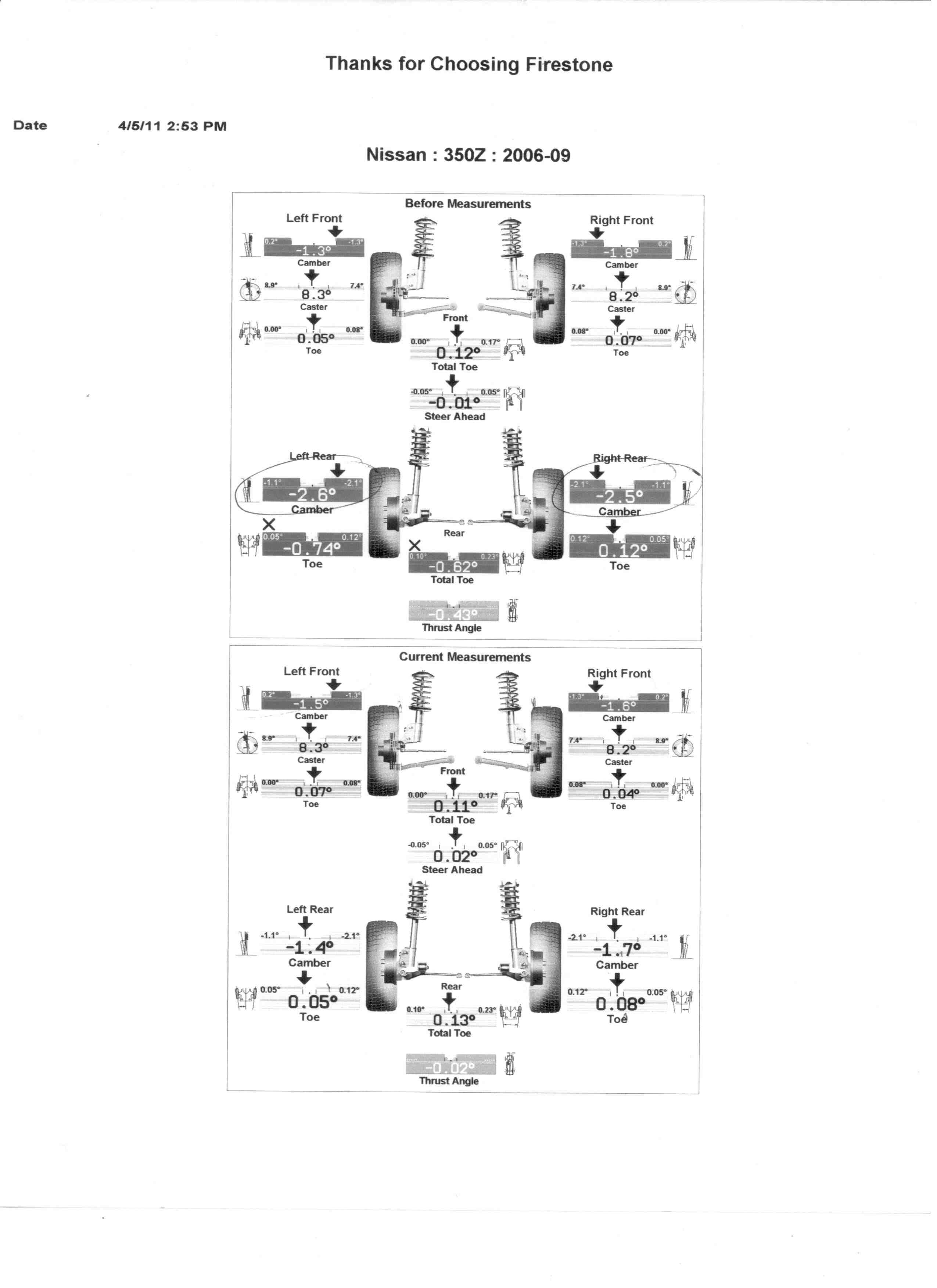

EDIT- I inserted my post alignment specs below if that helps!

I am attatching my post alignment specs if that can help you guys answer my question.
