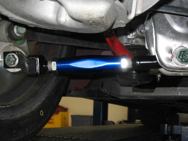

what do you think of these adjustable cambler rods

Looks like the original tierod ends cutoff and adjustable rod welded together...awesome idea!!! Looks great
I've seen the center section somewhere before, was it from another car?

no parts are from the stock rods the ends are mild steel and the center turn buckle is alum hex. by sat dec 27 iwill have a different piece on the wheel side this one looks a little weak to me right now but iam going to fix that . the car is lowered and the alignment came in adjustment right in the middle of nissans requirements i hope this will help with the rear wheel adjustment problems for the lowered cars

that'll help your camber but it's murder on your toe if youre lowered more than 1.5"
I did my "rear-toe" mod to fix that.

yes if you car is that low you need adj toes rods.
thats next week project
