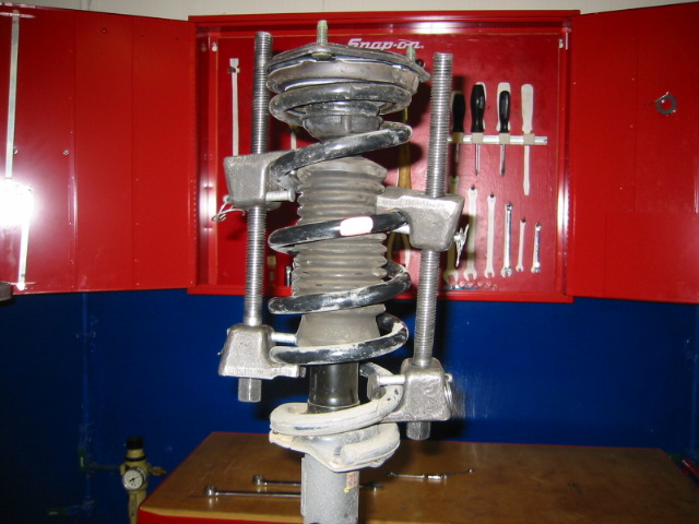

you could rent one at AutoZone for free, you pay $40 to rent, and you get $40 back when you return I put mine on a bench clamp.
Attached Thumbnails How to get spring off strut? (Install Help Needed)-springs-009.jpg

OK, for those of you who may try this, don't bother if you don't have a impact wrench. Man I suffered on so many bolts before that I'm going to go buy one after watching my buddy use it to help install my springs.
It's real tough to get the front spring/strut in and out and I don't think I could have done it alone.
