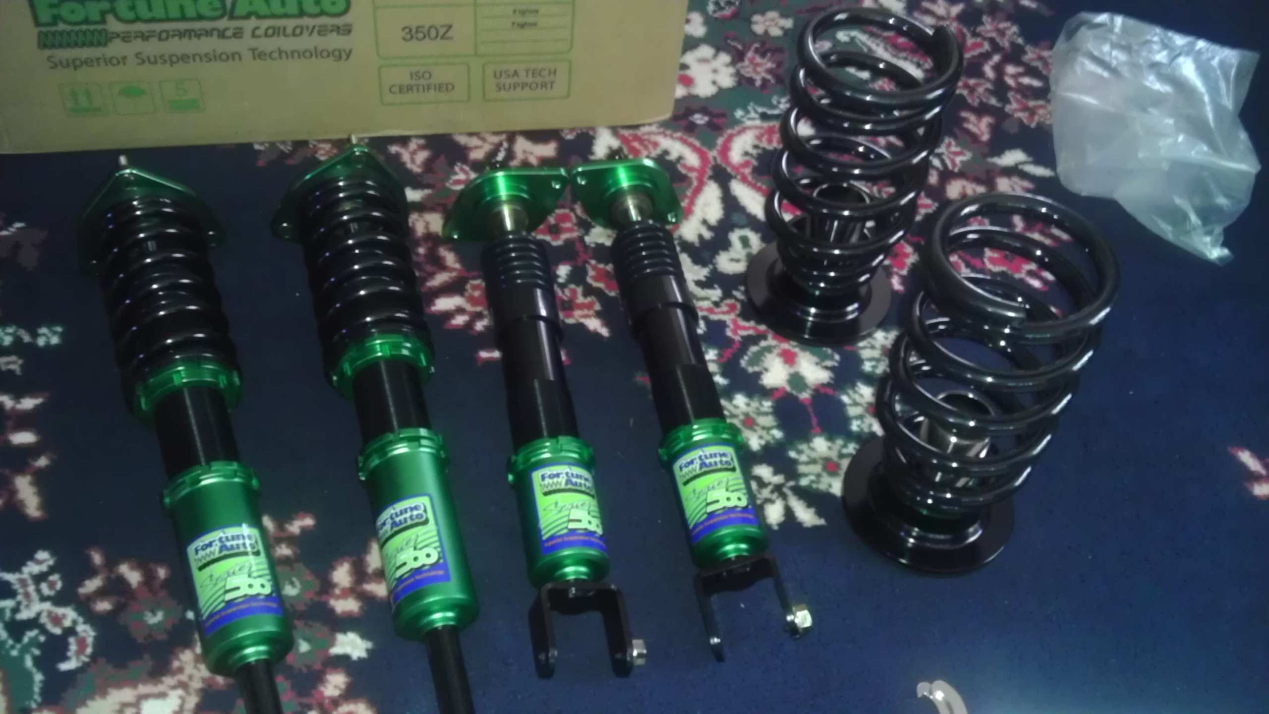

this is what i recieved in my box. and i also have some before and after pics. btw, the rears can still go another 1/4 inch, and the fronts still have enough to put the bumper on the ground.
