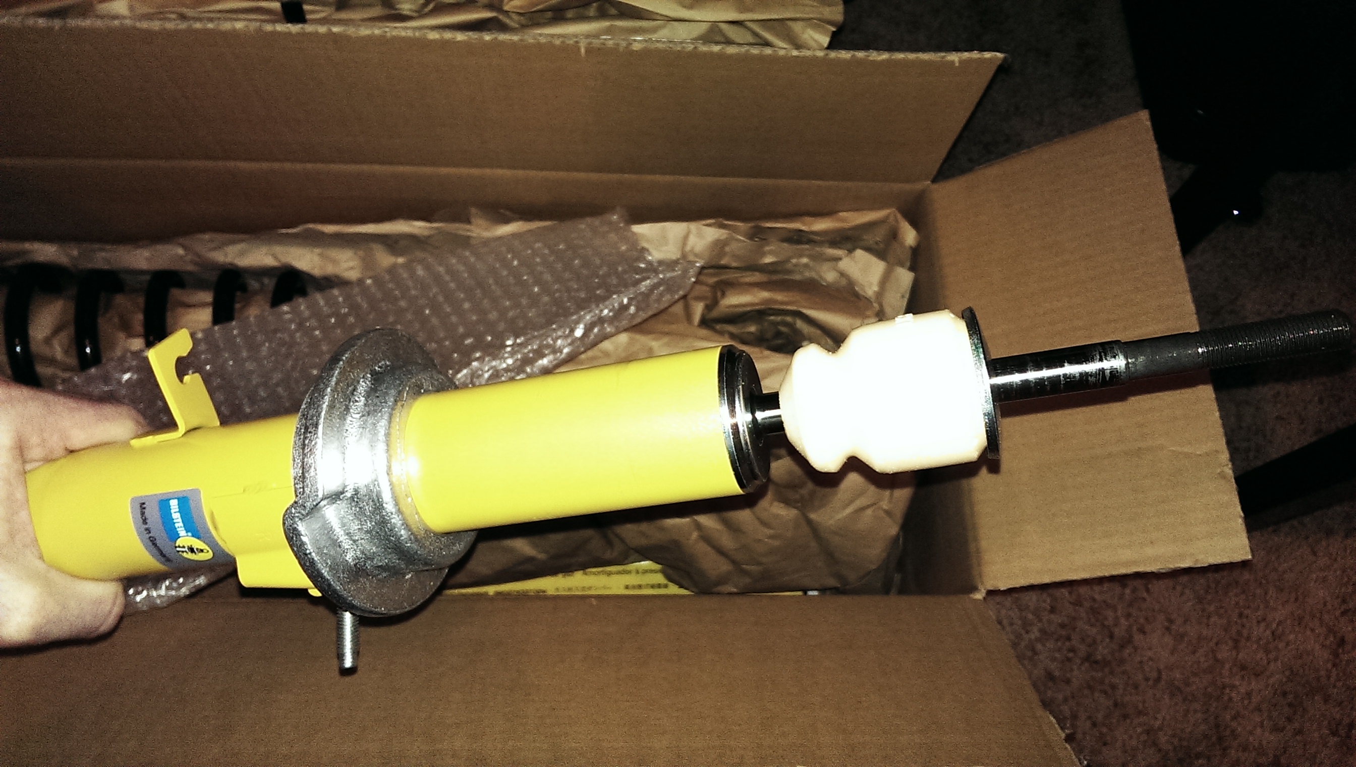

Well, Bilstein hasn't changed their design, it seems. The shocks I got are standard, not inverted. Came off the boat from Germany on the 15th.
Attachment 372469
Awesome, nice job on following through and congrats on the new setup.
