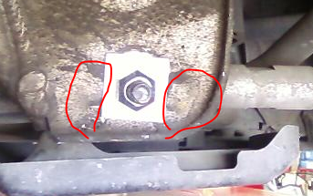

Hey guys, in my previous thread, I said that the CSR was acting weird, and I think I found out why. I was online making sure I installed everything right, and it looks like I installed my spc toe bolts in the wrong location. I put it in the camber arm location.... As in I dremeled out the camber arm holes.I will be putting my OEM camber bolts back there, and dremeling out the correct location. Will anything be bad if I put my OEM camber arms back? Will the dremeled out room be a problem? Thanks guys, I watched a YouTube video on this and followed it, and I guess they did the wrong thing too...

get lock out washers if you have aftermarket camber arms

Thanks for the quick reply travlee! So if I put these on, where I messed up, i should be fine?

should be. see in red circles in the pic? that is where the eccentric bolts press to make the adjustment. by putting the lockouts there, they cant move, so the elongated holes SHOULDNT be a factor. this also makes the alignment place use the aftermarket arms to adjust camber
