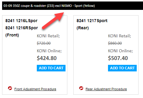

On Koni's web site they exclude NISMO from these dampers... see attached picture.

Nope- my Z33 race car has many NISMO parts, but lacks the bodykit. Interesting that Koni specifically excludes the NISMO Z from its applications, but oh well...
