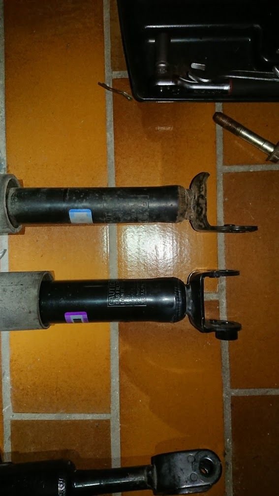

I can now conclusively state that there must have been an upgrade to the Z's shocks at some point after the 2004.5 shock revision.
While the front shocks look the same except that the old part number ends with CD700, while the new one is CF40C. the rear shocks have obviously seen a notable overhaul, the actual shock diameter has been increased by approx. 10% on the CF40C part number. Even the mounting point has been modified slightly, likely to accommodate the new shocks dimensions.
On a side note, it is the compression arm bushing nightmare once again, god damnit Nissan. The rear shock bushing sleeve welded itself to the bolt, just like with the compression arm bushings, and the damn things started spinning as I was torquing the bolt apart, so I had to cut out the old shock and am now dowsing the sleeves in rust remover, hoping to at least salvage the bolts.
So a word of warning now that these cars are getting older, there is a chance that you will need new bushings and a 20 minute job will turn into several hours of cursing.
...So I guess now my Z is grounded until I get Whiteline replacements. But at least we have proof that there must have been a shock revision on later models, perhaps as previously hypothesized for the heavier weight of the newer models or just an improvement...

I think the 2008 shocks are just somewhat different from the 2004.5 shocks. They provide a slightly but noticeable smoother ride.
