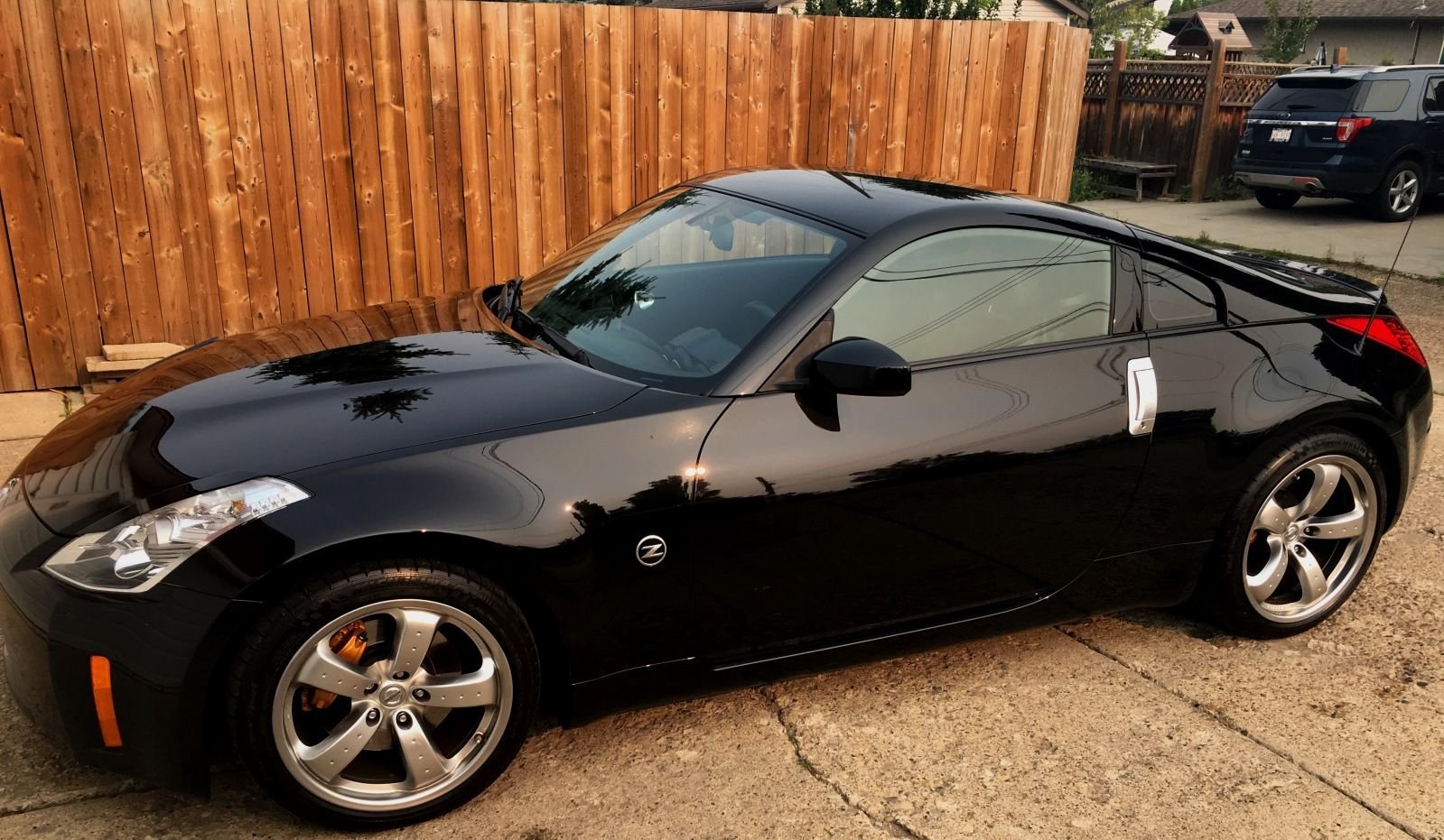

Hi Guys - what would you do suspension wise with a stock 2007 GT on rays, idea is I want no wheel gap and flush with fender - but maintain a ride similar to current setup.
Wondering if spacers and just lowering springs way to go, or coilovers - thanks!
No mention of actual handling improvement? Oh well, that's OK, my recommendation is the same: STATIC.
https://conceptzperformance.com/bils...529_p_1429.php
Bilstein B12 ProKit gives the best of all worlds: handling improvement, lowering, respectable (better than stock) ride. I do not advise other shocks other than these or Tokico Blue if ride is a paramount concern. Also do not recommend coilovers. Ride will likely fall off (except for maybe B14 Bilstein or PSS10).
So far as flushing the tires, unless buying new wheels/tires, spacers are the only way to go. 15mm F&R will do you just fine. But, as was mentioned, this offset (net +15 rear) might require you to roll fenders. If you go with a 10mm spacer on the rear, no roll most likely.
My car on Bilstein setup mentioned. Also shown with my non-current wheels because they are 9" F @ +27 effective offset and 10" R @ +30 natural. You can see from this that there's room to move out.
To this:
These are +22 but are 9.5/10.5 BUT.... net result is almost exactly the same (within a fraction of an inch) with your 9/10 GT wheels running 15mm spacers.
