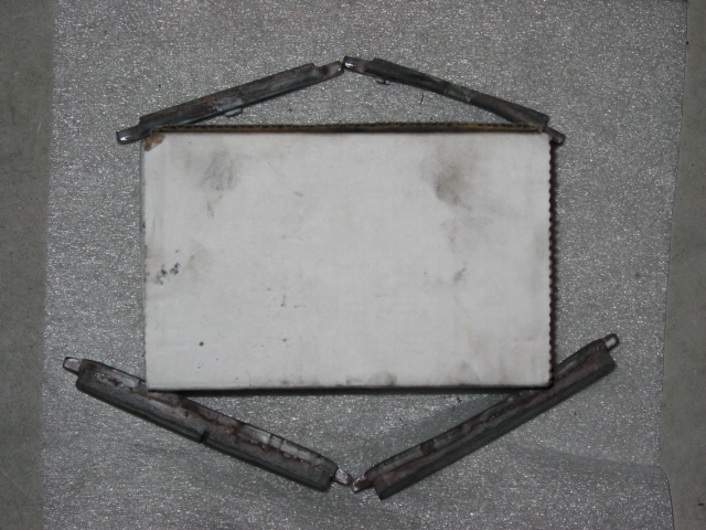

This is how mine looked like after and event. They didn't melt but did start to warp. You really have to keep an eye on that rear inside pad on both sides, they get the worst beating. The top are rear pads and the bottom are front pads with right ones being inside pads. You can see that the inside pads get worse mainly because of the heat and they start to warp and only applying brake with the middle of the pad where the piston hits and so if you look at the side of the pad you think you still have pad left but the middle is gone.
