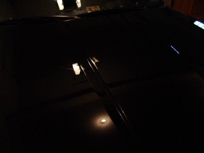

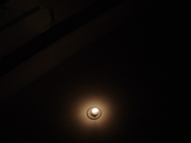

Unfortunately I don't have any close up photos from before, but here are some after pix. It's raining outside, so I took these in my garage.
