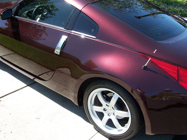

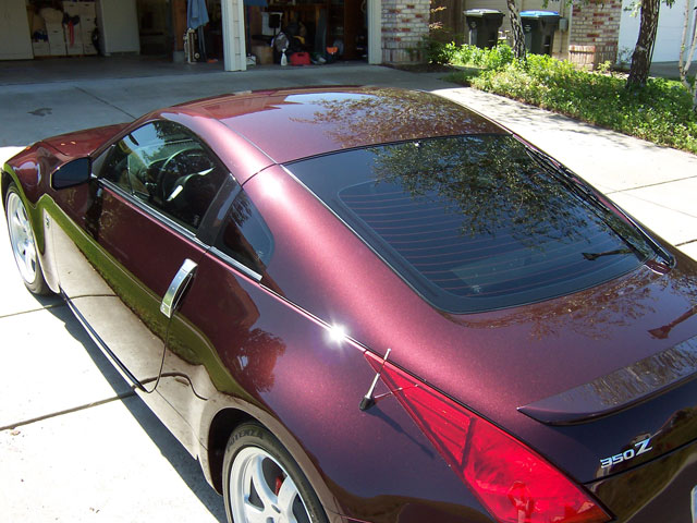

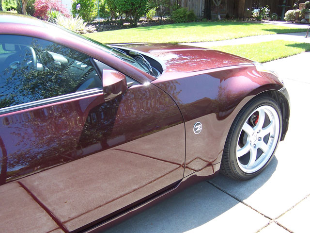

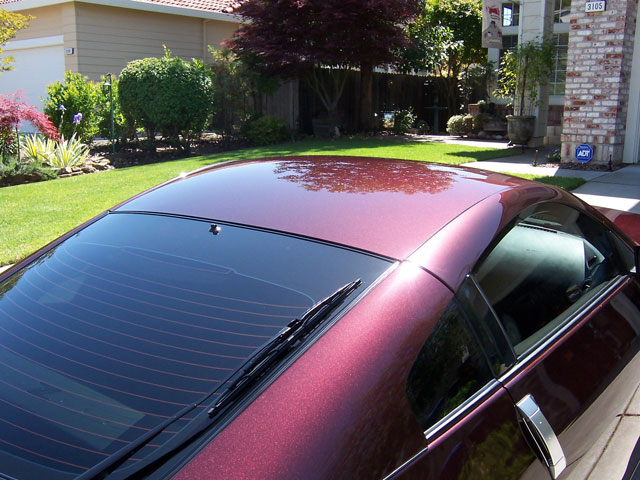

Make sure you go to the site & look at the Tips section for additional items (like proper towels) needed. Results may be viewed below:
