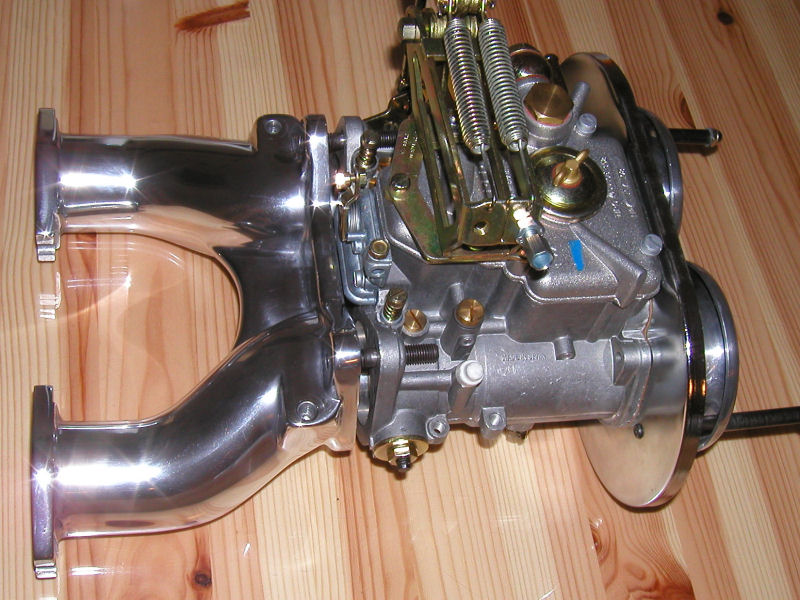

Only go down as far as you need to to get the scratches out, say try 600 a little first, if that wont do it, try 400, if 400 wont do it try the 240. From 240, you will still need to ramp back up to 400 and 600 (or one of your compounds may do the job for 400 or 600, I don't know what their equivalents are to sand paper).
These pics are of my last intake polish, other than a 6" wheel for finish buffing it is all done by hand. As you can see it is not very big and still it took me about 2 weeks of working on it every day in my spare time to get it this way. I recommend dish washing type rubber gloves or your hands will prune and turn black.

thanks for the pics. Any one else have any to post? Did you go over it with a clear coat?

I did not use any clear but the car never sees any weather so it will only need occasional polishing to keep it nice.
