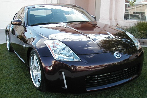

I had some 55+ applications of "Zaino" Z2/Z5, but recently changed to "Autoglym" Body Shampoo, Resin Polish and Extra Gloss Protection. I find it easier to apply and remove. Plus, the shine is better and does not pick up as much road dust.
Autopia has it, but in smaller bottles than my supplier at approximately the same cost.
I will continue to use "Zaino" products for my leather and tires. As for drying towels: "Big Blue" at www.pakshak.com For applying and removing resin: www.dftowel.com
